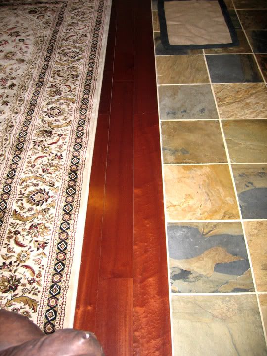

Just to clarify, I am assuming that the install is going over a level floor or a floor that would be considered acceptable for a floating installation. I have used the colored caulk method for floating floors quite often when it ab butts a tile floor with great success. This was not my own technique but one I learned from a long time tile and floor guy. He uses it with great success and while I do not lay floors by trade, I have done a few of my own installs using this method, even in my own home. I have yet to ever see an issue from any of the flooring jobs that I have done in this manner.
I will say that if a floor is not solid when I lay it down and there is serious give or up and down movement when walking on the floor, I might not chose this option. But I will also say that if you attempt to force a floating floor up and down or in an expanding or contracting motion after the caulk has dried, the caulk is very forgiving, which is also why I wouldn't want to use the method in a smaller grout type of line between the tile and floated floor.
Again I am not a pro installer, but this is what I have experienced with around a dozen or so installations of floating floors to tile. That may not be a lot, but every floated floor I have done in this fashion has worked out very well with not a single issue so far. The oldest install is about 7 years old. I also like the look / transition much better, as can be seen in the photos below. But again looks are subjective and very much a matter of taste.
My own home floating floor (family room transition) 3.5 year install w/ color caulk transition.
The most recent install I did using color caulk transition and floated floor. 4 months ago.

Shooter, did you use the foam underlayment on these floors? If so, you will, without a doubt, have a vertical movement in the flooring just by stepping on it at the transition. Except for Big Stretch and certain other elastomeric sealants, I have not seen caulk that will give that much without degrading.

Foam underlayment / barrier, yes on all of the floated laminate floors that I have done. Everything from the basic home depot offerings to the more expensive Pergo types of foam underlayment. I tend to use a sanded caulk, but have used a standard color caulk. I have yet to see any separation or degrading of the caulk joints in any of the floors that I have done. The oldest floor done in this manner being 7 years old.
Even if I had to replace or repair a grout joint it would be an extremely simple fix. So simple of a fix, I would still opt for this method instead of having a transitional lump in the floor. Just my preferences and so far all of the people I have done floors in this manner absolutely love the fact of not having the transition.
Everyone's mileage may very here I guess, as far as taste goes.
I shot a quickie on my camera. 3.5 year old floor. Thomasville floated floor up to my slate tile. Notice the caulk matches the grout very well, even the dirty, err aged look. This is the family room and kids play room. It gets the most heavy use in our home with 2 dogs also. The floor compresses slightly with the underlayment but the install and caulk joint shows zero signs of any type of degradation. Just shows dirt like the rest of the grout lines, but it matches perfectly. Every other floor that I have done in this manner has the same results.
