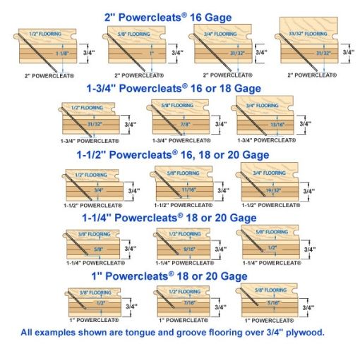

Time will tell on the 3/8". It is the amount of bite that the cleat has in the wood not necessarily how flat the floor is. 3/4" is recommended so that blow out on the underside doesn't cause a lack of grip which would lead to a squeak down the road. Fortunately, you used ply and not OSB which would tend to blow out a lot easier. Then if you calculate how far the cleat will pierce the 1x8, you may only have a 1/4" bite which for a fastener is not really sufficient.
Have a multi/oscillating tool with a good metal blade or two handy. Should you come upon a miss match width, you don't discover until you try to add the next board. So the short width board is already nailed in place. Rather than prying up and risk potential damage to the adjacent tongue, use your multi tool to cut the cleat out from under the bad board.

Here is a depth chart to help you choose the correct size cleat for your flooring. Couldn't get the image to upload or reduce without blurring. So Photo bucket it is -
Hmm. I linked to a picture and instead of the link, the actual picture shows up....Good thing I'm not a computer guy, wouldn't be very successful.

Well it's 3/4 flooring going into 1 1/8" of subfloor and I have 2" nails... so I should be good, right? Didn't get to work on it at all today, got called to omaha to put in windows. Maybe tomorrow.
