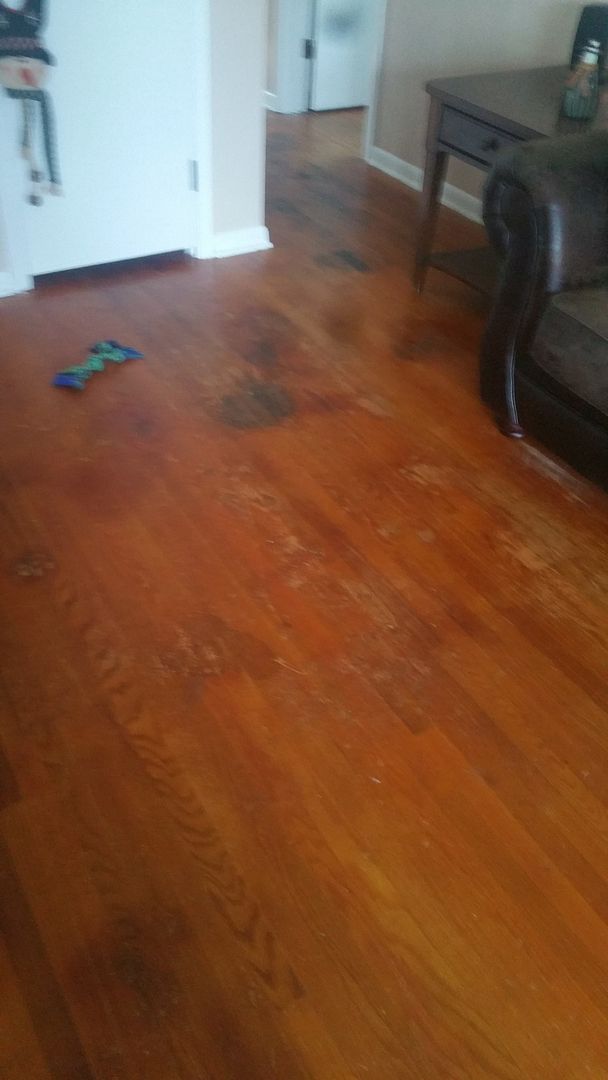

I am trying to figure out which route is best for my situation. In my ranch home 75% of my floor is a hardwood that had carpet over it for quite some time. I pulled the carpet last year and due to previous owners having many pets and foot traffic with wet feet, it left the hardwood looking pretty bad. Black and discolored sections all over it. However, that is only the case in the living room and hallway. It is structurally sound except for two small parts, that are bowing down, very slightly and it is a little creak in a couple of spots, very very slight creak.
So my question is should I sand down the hardwood and restain it or put laminate over it?
I know hardwood floors are desired and it would seem like a sin to put something more cheap over them and I would think it would be cheaper to refurbish the existing hardwood. I would want to restain a darker wood color.
If the recommended route is to refurbish the existing hardwood, what all is involved. Are there any sanding machines I can rent?
Here are some pics to help show the floor.
The rest of the house/rooms are perfectly fine.

My floor is oak?
How much exactly do I need to sand down? I'm guessing it is going to be a lot of work? What would you guys recommend to use to sand it? I know there has to be something better than a small orbital sander.
There are several types of large floor sanding machines you can rent. The pros generally use a large walk behind belt sander for the large areas and smaller sanders for the edges where the belt sander can't reach. These machines do a wonderful job when handled by a pro, but can be a problem for inexperienced operators because they can remove wood quickly and unevenly if not handled correctly, leaving dips and gouges.

One more vote for refinishing. I also agree with Carbide that you are best having a pro do the sanding. You can rent belt, drum or orbital sanders but I have seen floors literally destroyed in seconds by the misuse of the drum sander. The orbital is more forgiving but it will take a lot longer to do an acceptable sanding job.
Thanks everyone. I will look up some professionals to do the sanding. The areas that may not sand out, can I get the same size slats and pull the old out and nail in the replacement. Does mins look like oak or what kind of wood does it look like?

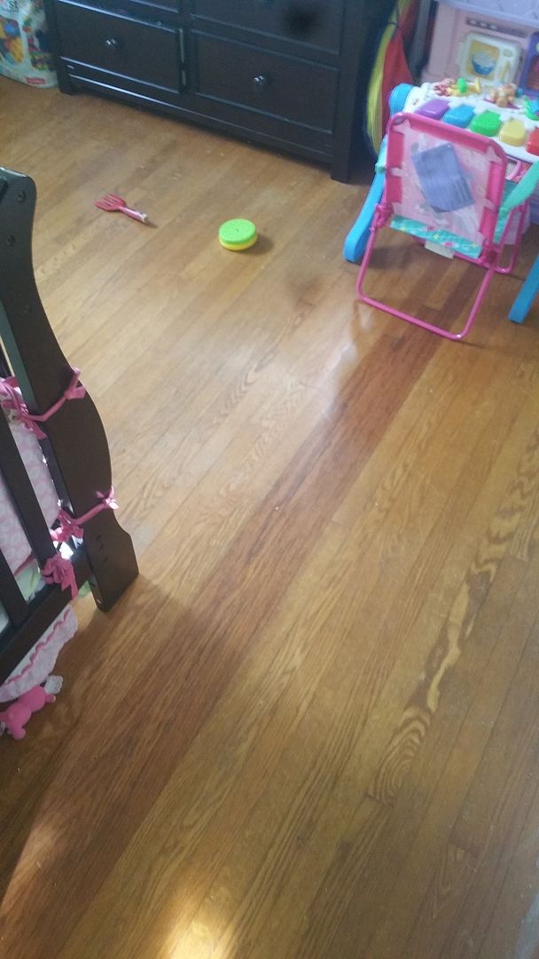

Ask who ever you get to sand the floor about the stains. Some times wood bleach helps but often replacement is best. It isn't a big deal to replace boards but that needs to be done prior to sanding. The bottom pic looks like white oak to me - ask the pro when he comes out so he can verify.

If your floor turns out to be White Oak, which is likely, the new boards should blend in pretty well.
The floor already has quite a variation in wood tones, as does all Oak floors or any natural wood.

All of the hardwood is the same, just the third pic, it has much better lighting and in MUCH better shape.
