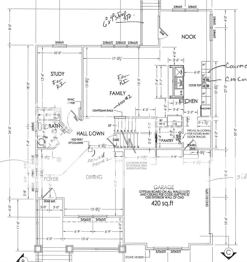

My wife and I are building a house that should be done in about 9 weeks. After 2 hours of youtube and lots of reading we are thinking about battling solid hardwood floors ourselves (nailed down). But I have a couple questions...
1. Based off the floor plan I'm thinking I would start against the 17 2" wall? That's where I start my first line right?
2. Assuming I'm correct on question 1. I would need two significant direction changes and one smaller one. One to feed into the Nook, one to feed into the Study and one smaller one for the Pantry correct? Looking at using slip tongue. Is this the right idea?
3. The one area that concerns me is the Study. As you can see the study entry is angled. I do this exactly like everything else? I just have to cut my board edges at a angle or do I have to do something completely out of the norm to overcome the transition into that room?
4. Do you guys see any other tricky areas that I may have missed here?

Normally the hardwood is laid perpendicular to the floor joists. Do you know which direction they run?
While I wouldn't think twice about laying and finishing the floor, I'd consider hiring out the initial sanding, it is easy to get in trouble with a drum sander

The joists run from front to back here. So I'll be laying the wood from left to right based on the floor plan if that makes sense?
We're going to buy 3/4" pre finished hardwood of some variety. 5" wide plank most likely.

You don't necessarily want to start with a full strip against the starting wall because you may end up with a very narrow piece at the opposite end. So you want to measure the area and figure out how many strips of flooring will be needed, allowing for the gaps around the edges. If you come out with, say, 50 and one quarter, you would start with a strip ripped to 5/8 of it's width, then have 49 full strips, and end with another 5/8 width piece. That way you don't have 1/4 of a strip at one end.
Also, check that the room is square. If it's not square, you want to plan whether you will lay parallel to one wall and end up with a taper at the other, or split the difference, so you have a little taper at the start and at the end.
For the angled study entrance, typical would be to have an angled transition piece under the door, but lay the flooring in the same direction, just cutting the ends at proper angle to die into the transition.

Is there any point to doing the angled transition piece under the door other than look? Or is to "reset" the point you made in the first paragraph. So you can kind of figure out the room and cut the same amount off of both the starting board and ending board?
I appreciate the advice on kind of laying things out before tying that entire first row down. I think I get everything you're saying. I'm going to have a tough section probably either way though since that family room wall will both feed the other side of the family room but also the dining room. One side might not work out too well. That's hard to plan around.

If you want the floor to flow continuously throughout the first floor....and I'm reading the diagram correctly, I would run a center baseline from the family room through the dining room and then lay the floor in 2 directions. I'm assuming the halldown is part of the first floor. Are you laying the hardwood in the kitchen too?

I wasn't...the other posters may have. My suggestions, assuming you want the flooring to flow throughout the first floor and have no transition points was to lay a baseline down the longest 'line' on the first floor which would be from the family room to the dining room. You would lay the floor in both directions from the baseline. This would allow one continuous flow through the first floor. If you want a transition in the doorway it would look like my picture.....you don't need the transition if you don't want it.

Probably a good idea to start in the middle, spline and work out in both directions to control expansion and contraction issues. As Mark said, your flooring should be installed perpendicular to the joist system to prevent possible "waves being visible from deflection between the joists. Here are the guidelines for wood flooring installation. Pay attention to he thickness and material construction of the subfloor. http://tinytimbers.com/pdf/nwfa-install-guidelines.pdf

I'm confused about the direction of the floor joists. Looking at the blueprint do the joists run left to right or top to bottom. I based my suggestion on the joists running left to right......if this is not the case then the Baseline I suggested is running in the wrong direction assuming the flooring will run perpendicular to the joists.

Jim - Thank goodness you asked this cause I thought i had this pretty much figured out and I was awfully confused at this point. The floor joists run from front to back NOT left to right. The front of the house is the bottom in the picture. Where the foyer is...foyer = front.
My plan was to run my wood floors from left to right perpendicular to the joists. With that said where do you stand now on recommendations.

Would it be possible to post a sharper picture of the blueprint....or tell me how to sharpen this one.....I've gone to Photobucket but can't seem to do anything with it. My problem is, based on what I can make out I'm thinking the flooring would be more aesthetically pleasing if it ran from front to back so when you walk in the front door, which I think is at the bottom left, it would be as if you were looking down a bowling alley toward the pins. The long line of the house and rooms seem to run this way too and generally flooring looks better this way instead of looking across the floor boards. But, this would be the same direction as the joists....which is not generally recommended but can be done with a good joist and subfloor system. Of course a diagonal layout would be a good comprise if you like the look and additional work.

Jim - Here ya go, but I can tell you I've seen floors laid in this same model and they are left to right. It looks great. As a first timer I don't think i'm gonna tackle diagonal that sounds tough. I think I want to stick with the left to right theme so i'm perpendicular to my joists as a first timer. But I am still very much seeking your guys guidance on everything else. To include the transition to the study, transition to the bath #3 and transition into the nook.
