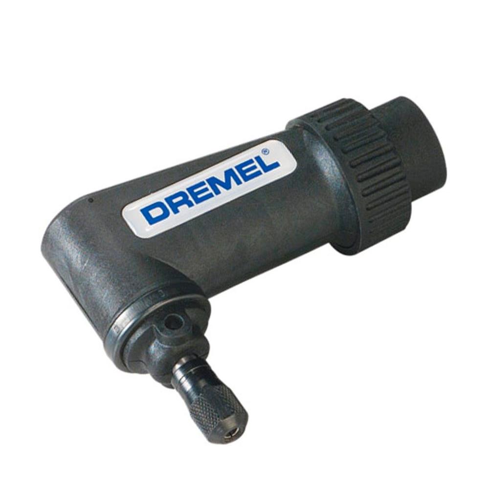

I think a Dremel rotary tool with a right angle head attachment and a carving bit might be the best bet. I might try making a simple guide to help hold the tool at the right cutting depth and then something clamped around the Dremel to slide along the face of the step so the groove is the right distance back from the edge.
