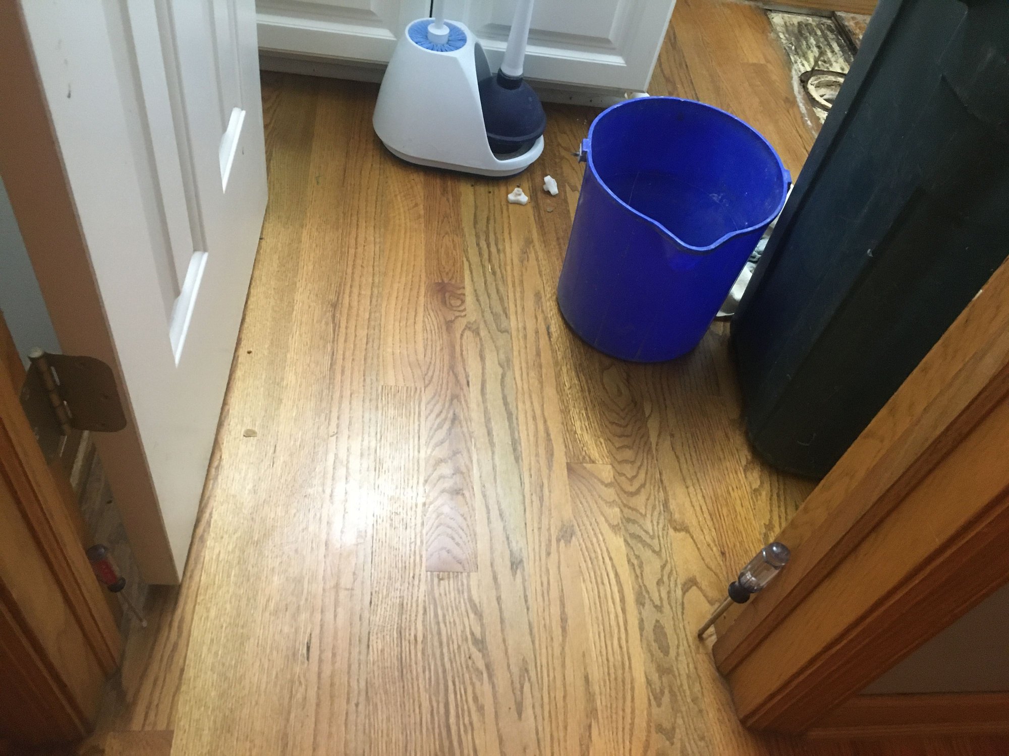

So the plan is to cut a straight line between those screwdrivers. Remove all the 3/4 hardwood, install 1/2” HardieBacker, then install 1/4” tile on top of that, wait, grout, install toilet. (Should I go with 1/4” Cement board to account for thinset or is that pretty negligible, the hardwood is 3/4”)
I could use a few more suggestions on the transition from wood to tile. I would love to keep it flat without having to use any sort of reducer/transition piece that creates any sort of hump. I’m concerned that butting perpendicular wood to tile might not work or look well. That’s even assuming I get a nice clean unsplittered cut... I also read somewhere that you should use caulk instead of grout on the transition.

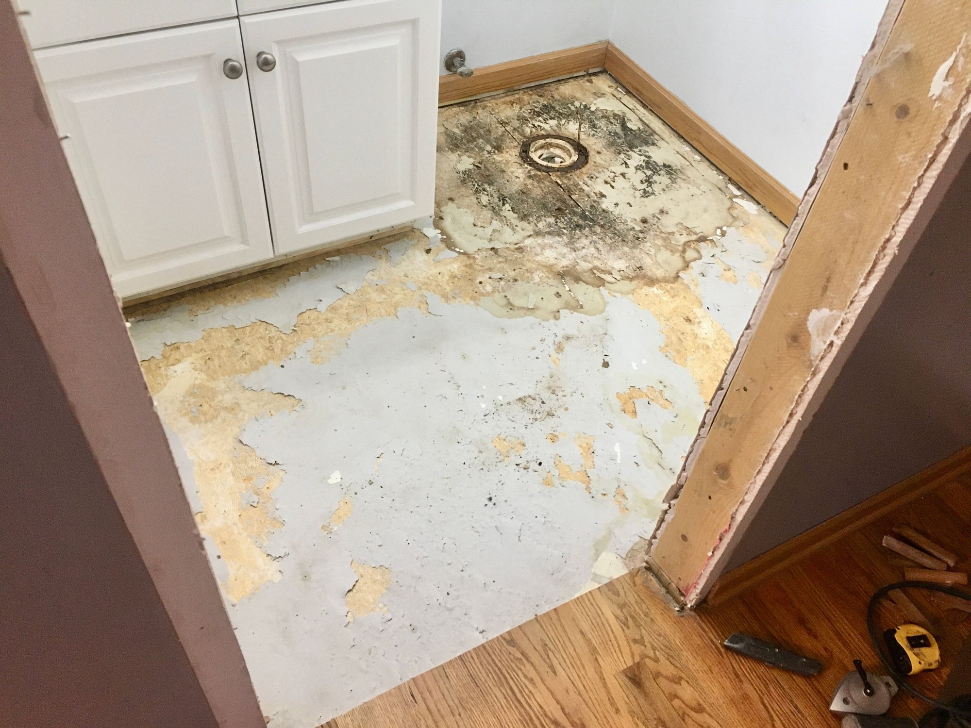

The cut went very well and I’m leaning towards just using a matching caulk between the wood and tile. I have removed everything and found lineoleum under the hardwood. I pulled that too because i knew there was some water issues near the toilet.
Need some suggestions on preparing the subfloor for HardieBacker. You can see in the picture that there is water damage near the toilet. How do I go about replacing that? I don’t see any screws for the subfloor... with the size of the room I’d be tempted to just replace the whole of it. It wouldn’t even take a full sheet. I consider myself competent but I am very much a rookie when it comes to construction.
Final note, before realizing I probably need to replace the subfloor I bought 1/4” hardie and have 1/4” tile. I’m expecting the two layers of mortar (under the board and under the tile) to get me to 3/4” to match the hardwood. Sound right?

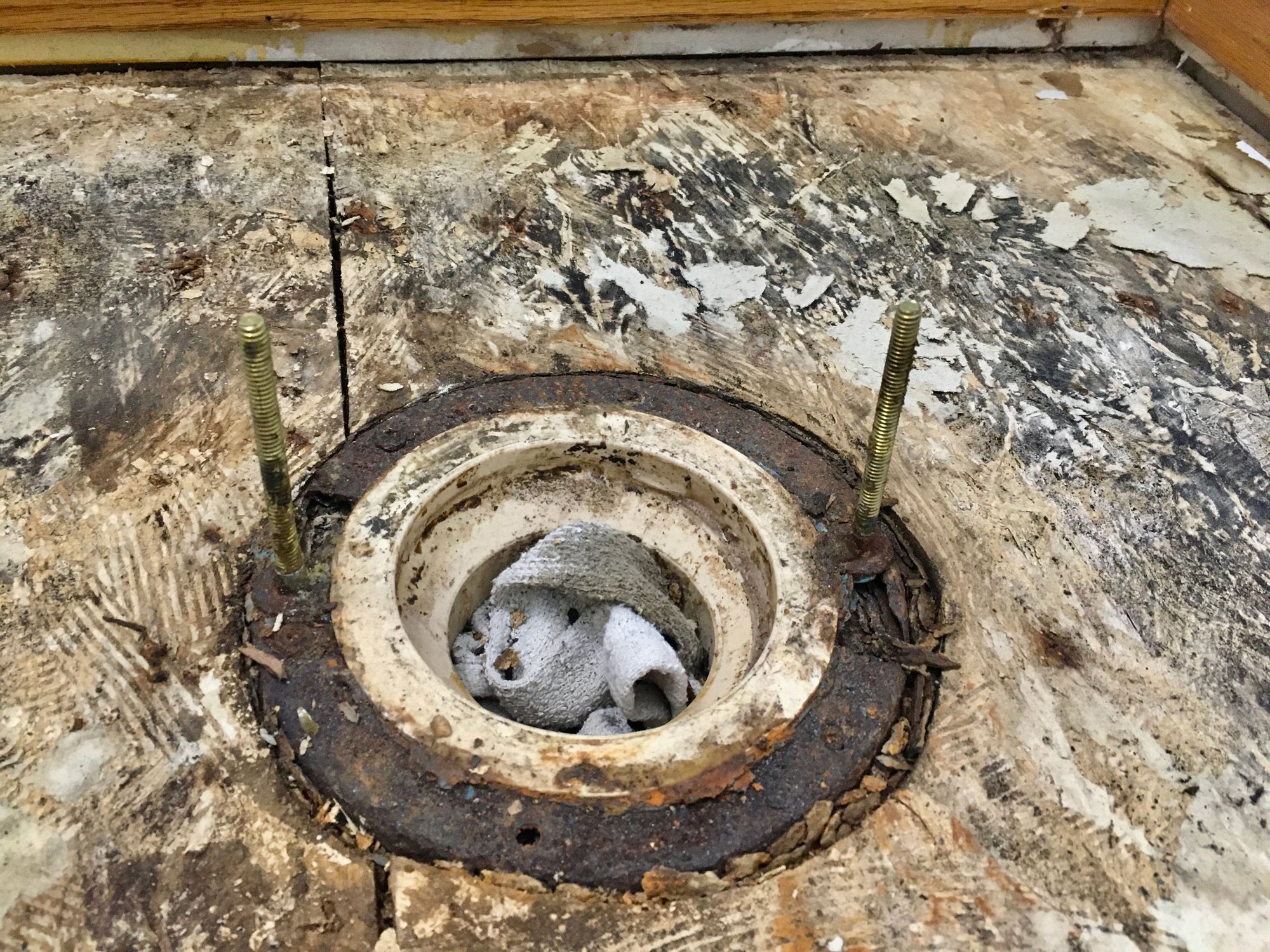

Can you post a picture looking closer at the toilet flange and the floor in that area. From your photo the toilet flange looks suspect but it could just be the picture.
Take a screwdriver and poke at the floor around the toilet flange and then jab the screwdriver into the subfloor in an area that wasn't water damaged. That will give you an idea what water damaged wood feels like but the screwdriver will penetrate further in rotten wood. If the wood is at all soft around the toilet flange now is the time to replace the subflooring.
Remove the base molding. That will make it a lot easier to drop your sheets of tile backer into position and the base molding will have to be moved with the new finished flooring height.
Also, I would go ahead and remove the vanity if you are up to it. After disconnecting the plumbing inside the top can be popped free. Usually it's only held on with caulk between it and the cabinet. There is usually only a few screws or nails holding the cabinet in place. I remove any fasteners I can see then pull/lift on the cabinet to feel for any fasteners I missed. Then you can lift the cabinet out whole and have a nice open floor to work with. That will make it easier because your tile backer and tile can run under the vanity so you won't have to trim the tile to fit up next to the vanity. And, in the future if you decide to switch out the vanity you can make the change without having to redo the floor.

And it almost looks to me that your rotten osb may be an underlayment layer on top of another subfloor... in the photos, it appears that you can see the edge of the osb butting up to the side of the bottom plate. This would be very good news. If you have a floor vent, remove it and see if you can see a cross section of the subfloor. Or clean out the crap around the toilet flange and see if you can see the layers.
Possibly you can get away with just removing/replacing all the OSB if there is a subfloor underneath it that is still intact.

XSleeper I think you’re right. It does appear to be an underlayment. Might just set my circular saw at 1/4” and cut on the rot and pull it up. It’s all glued so I’m hoping to only remove the rotted wood.
Yes, those toilet flanges with a stamped sheet metal ring can have a short life. It looks like the toilet flange should be replaced. Which isn't so bad if you're already pulling up the floor sheeting.

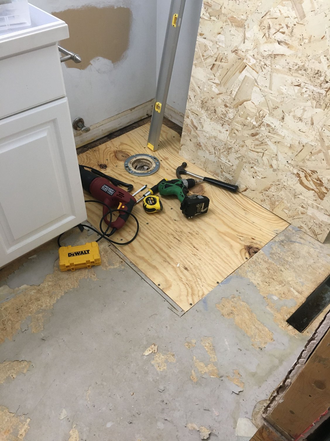

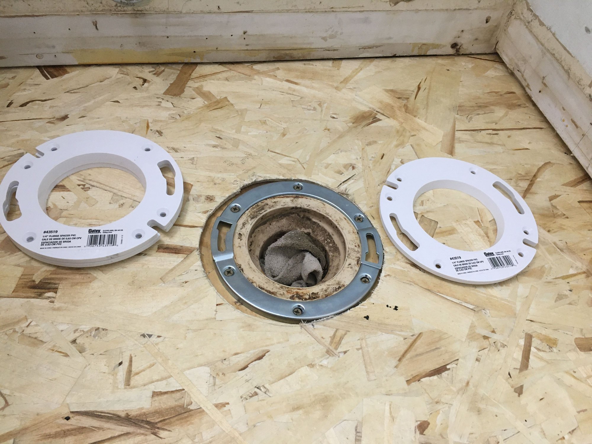

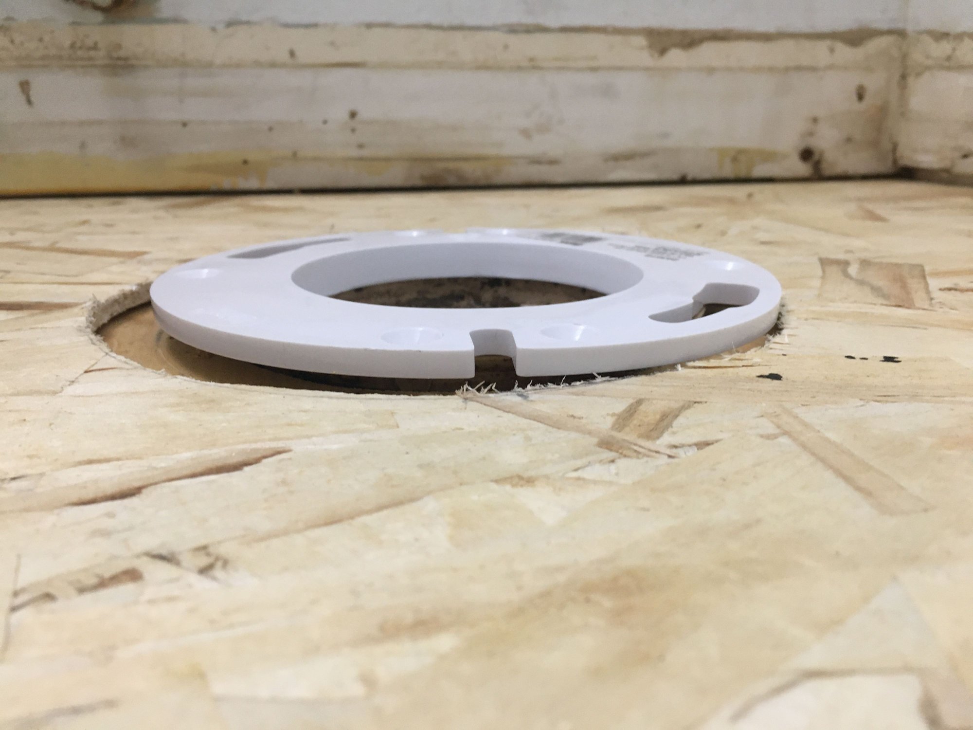

The good news is I have a solid floor in. I’m not entirely pleased with my underlayment OSB cut. I was off to the left for some reason on my measurements. But here’s the real issue - I used an oatey replacement ring under the toilet flange. The spacers I have to go on top of the flange don’t sit flush because where the metal ring overlaps it is higher AND and oatey spacers are the opposite direction of the oatey ring... what the heck.
#21
Thats good. Looks your joists must run right / left as you look into the bathroom, so you oriented the plywood correctly. But the screws in your flange are too small... hope you plan to replace those with larger bugle headed wood screws.
And dont quote me, but I think that if you intend to use a spacer, you should have replaced your flange completely with a new one... the new one could have sat right on top of your completed subfloor.
About all you can do now is put your PVC spacer on bottom, (clean and sand the existing flange then silicone it to the existing flange.) Offset the screws so they don't interfere... ( the slots in the pvc flange don't matter, you can even turn them 90 degrees)then put the metal ring on top, predrill holes through the pvc and use the larger screws.

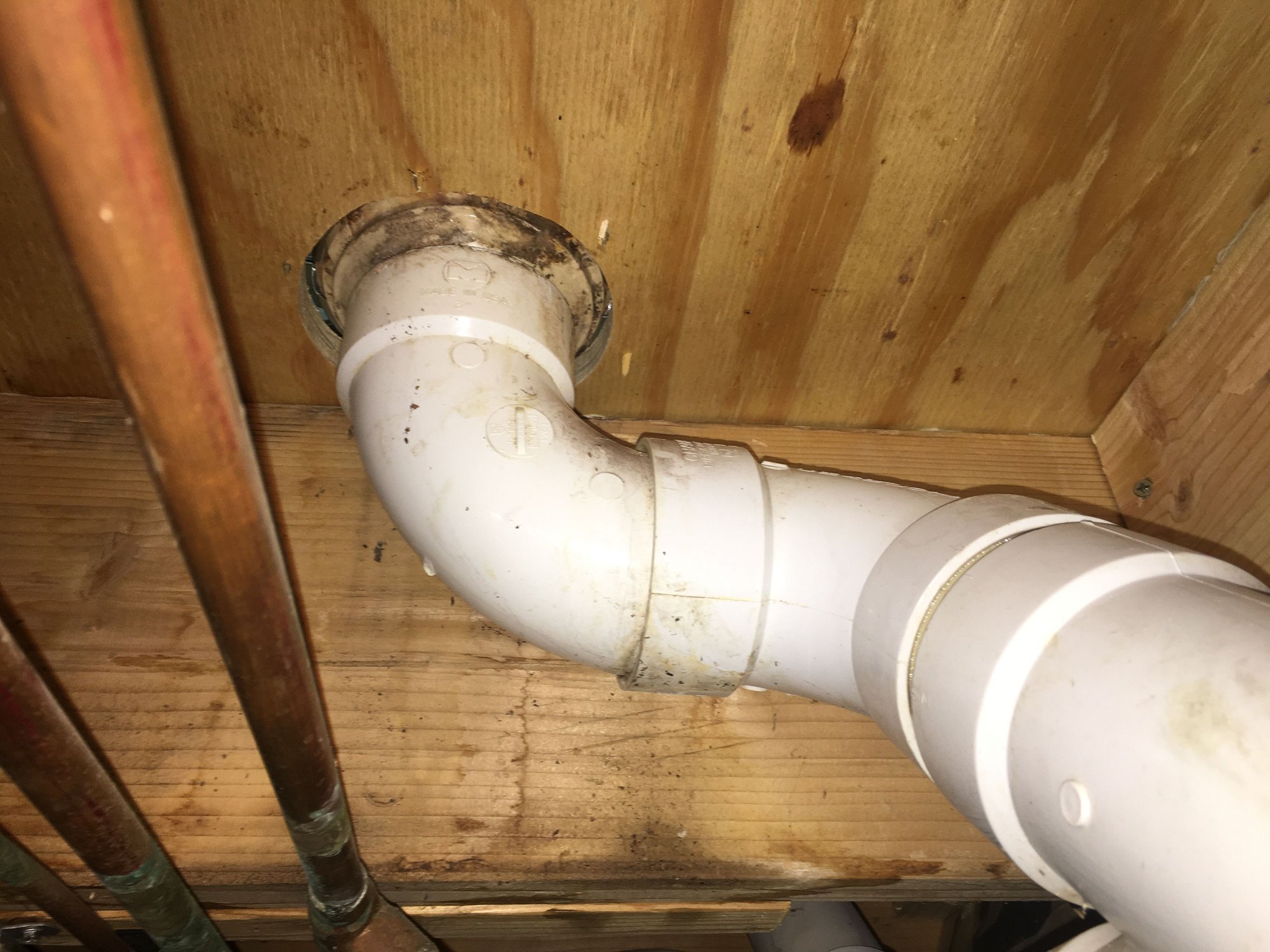

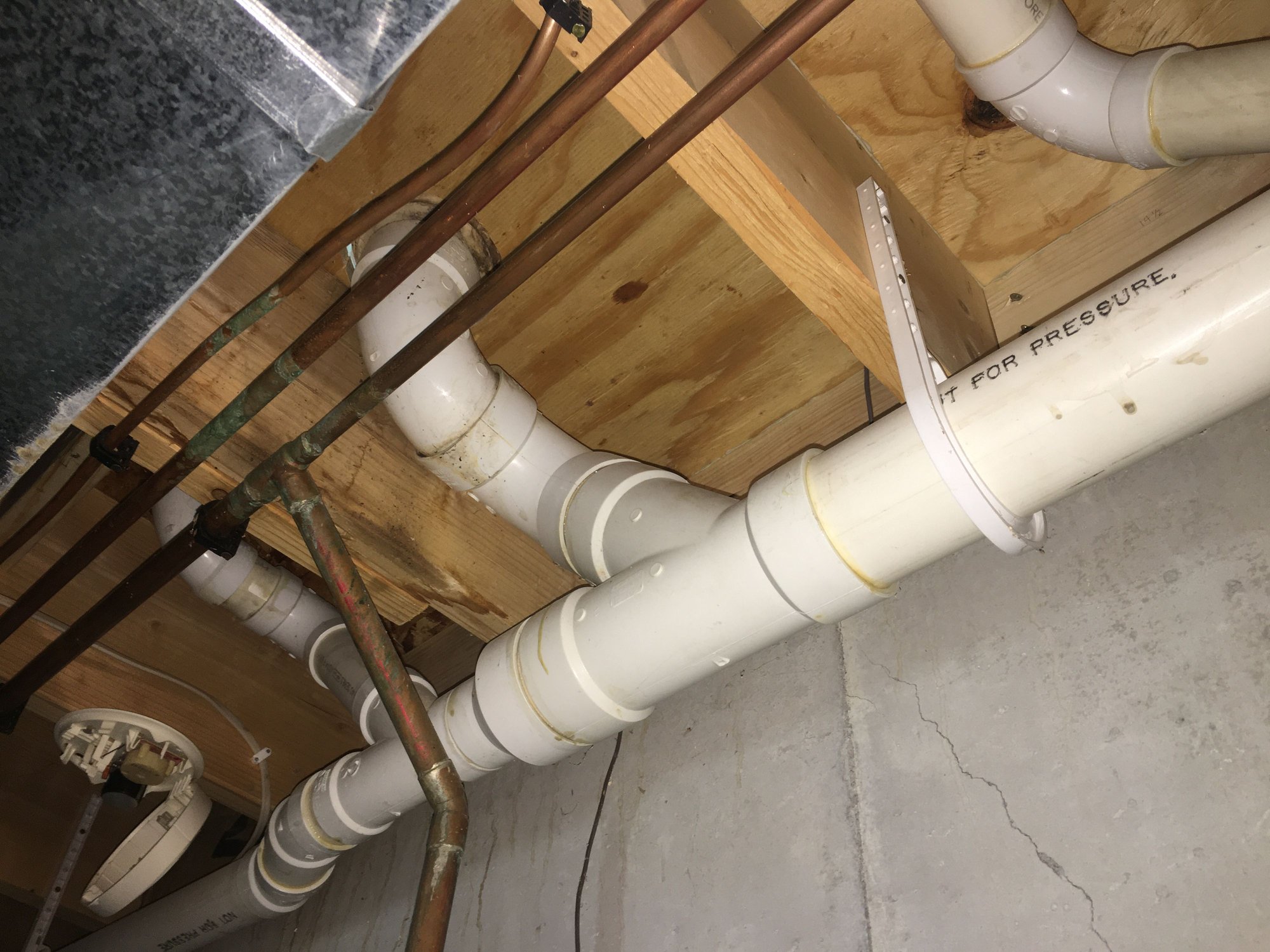

Yeah, it doesn't appear easy. You would need to replace all those elbows in that photo. I would need to see more of the plumbing to have a clue... maybe back up and snap one more photo. Its nice you have access from below. I would definitely replace it... there isn't anything holding your plumbing right now but the glue joints.
Your goal would be to use one like this.

Had another thought. Correct me if this won’t be stable enough but I’ve thought about getting new 1/4” and cutting it to match the plywood. The spacer would set inside the current flange and screw in on top of the two layers of flooring.
#25
Yes, that would help somewhat. But ideally, your original flange pictured in post 22 should have subfloor under it. Right now, if you step on it, all that weight is being put on the pipe and the pipe hanger pictured in post 24. But in order to do that you would have to replace a lot of fittings. So I'm guessing you probably don't want to get into that.
