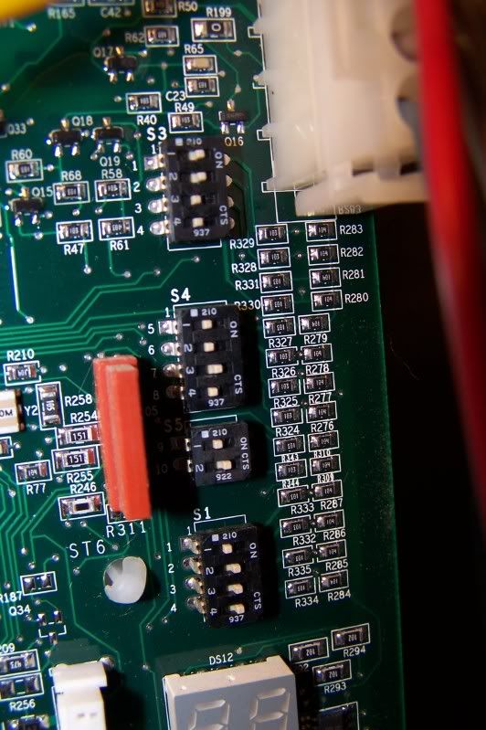

On the furnace, you want Dipswitch set at.
S3
1-off
2-on
3-on
4-off
S3
5-on
6-on
You need to add a jumper from Y1 to Y2 at the furnace. Also, a jumper from Y to O at the furnace.
Dehumidifier- At the EIM Add a jumper from one of the R's to DHUM1. Then DHUM2 to DHUM at the furnace.
Humidifier- What brand is it? since you said powered unit, I'm guessing the unit has it's own low voltage transformer. If so, the two low voltage wires goes to HUM1 and HUM2. Then plug the unit into an outlet.
S3
1-off
2-on
3-on
4-off
S3
5-on
6-on

Okay you mentioned
S3
1-off
2-on
3-on
4-off
S3
5-on
6-on
On my board pic attached number 5 and 6 are under S4. Do I set these as you mentioned? I have not changed none of these yet.

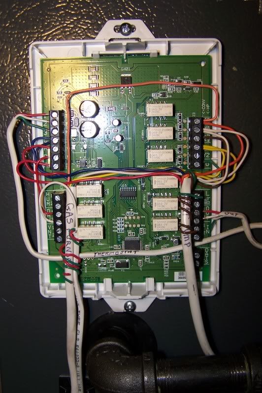

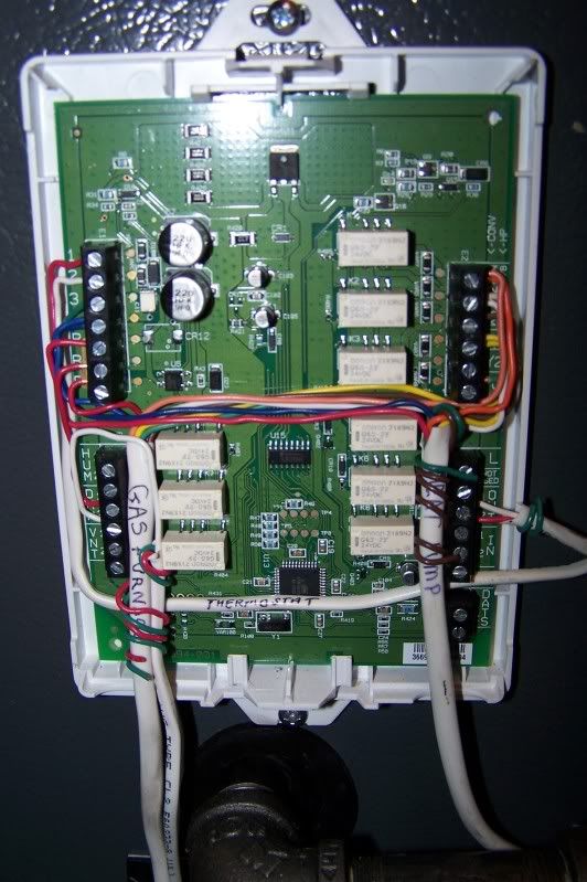

On the EIM am I able to run these wire up into the module like this or will it cause communication errors?. If I can keep them there I will shorten them up to clean up the appearance.

Not much of a manual, guess they had to cut cost somewhere.
Is the transformer built inside the unit??
Bought the units from here Desco Energy
They are local to me 10 minutes away.
Do a Manual-J on this as well?
I guess I am anal about wire management. Now that I know that they can stay there I will clean that up even more. Like when I build a pc, wire management is key to coolness inside the tower. I hate restrictions of air flow.
If the low voltage wire off of that is not "hot", then you can either get power from R or use the transformer.

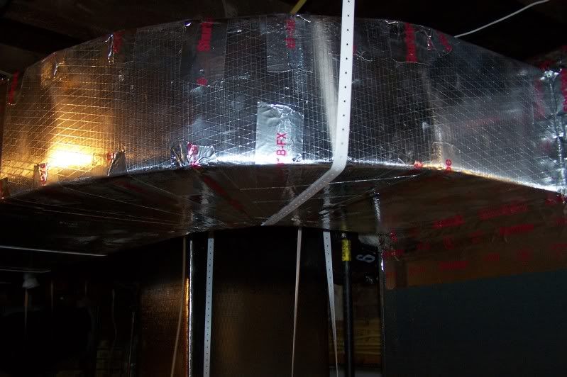

Here is a pic of one of my trunks. Guy from Desco said he was impressed with it when he came out Thursday. He said most guys just square them off at the turns. To me that is another air restriction.

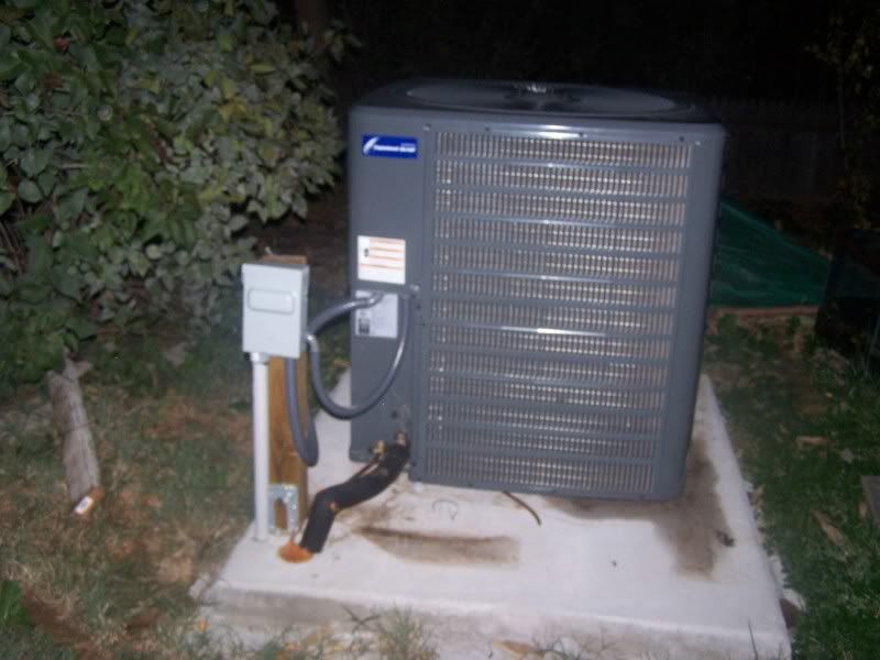

Attached is a pic of the heat pump. Camera was having problems focusing at 1:30 in the morning.

I ran all the 110, 220, and low voltage wires. The heat pump was approximately 15' from the furnace and I ran 1" electrical conduit underground to carry the 220volt @8 guage on 30amp breaker inside with disconnect at the pump and low voltage wires and a 4" electrical conduit underground to carry the line set. At the end I poured a 5'x5'x4" concrete pad around the conduits. The only thing left was to braze lines evacuate and charge then flip the breakers.
Till it was done I had a $350 initial start up bill. That is a big difference from the thousands I was fearing. There was only 1 snag, he could not get the the pump to change over to heat. The problem was if I remember was the Y to O jumper. Once that was cut we had heat.
