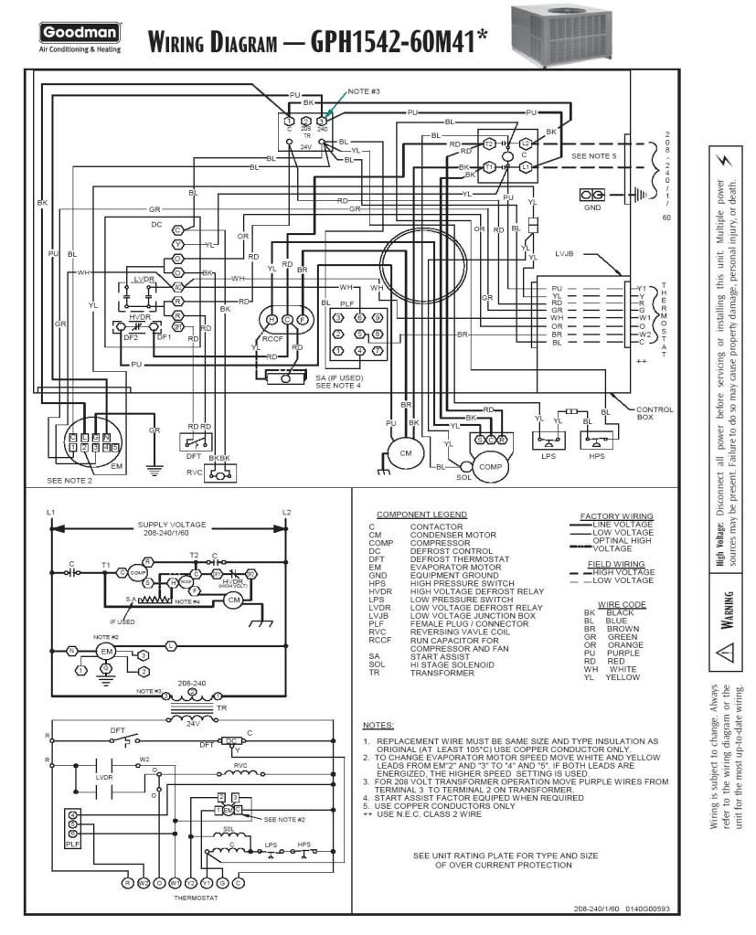

need help wiring VisionPro to goodman
Old 11-29-10, 09:07 PM
Join Date: Nov 2010
Posts: 5
need help wiring Honeywell VisionPro 8230 thermostat to a Goodman GPH1549M package unit heatpump w/ 2 stage heat and air, plus aux heat,it has 8 wires
Old 11-29-10, 09:35 PM
Jay11J's Avatar
Join Date: Sep 2001
Location: Rochester, Minnesota
Posts: 18,427
T-stat------HP
R/Rc--------Red
G-----------Green
O/B--------Orange
Aux--------White
E-----------Brown
Y1----------Purple
Y2----------Yellow
C-----------Blue
Let me knwo if you need help with the stat installer set up menu.

http://www.goodmanmfg.com/Portals/0/.../SS-GPH15M.pdf
stat = heatpump wire
Y1 = purple
Y2 = yellow
Rc & R = red
G = green
Aux = white
O/B = orange
E = brown
C = blue

Old 11-30-10, 07:43 AM
Jay11J's Avatar
Join Date: Sep 2001
Posts: 18,427
160-0
170-12
173-0
180-1
190-0
200-0
210- (Did you get the outdoor sensor?)
220-2
230-3
240 to 260-3 (some may not show)
280-1
300- up to you.
340- (If you got outdoor sensor, set to 2, No-0)
350-0
360-40 (if you got the outdoor sensor)
Any other settings after this, let me know if you have questions.
