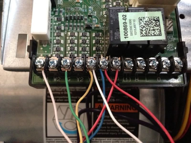

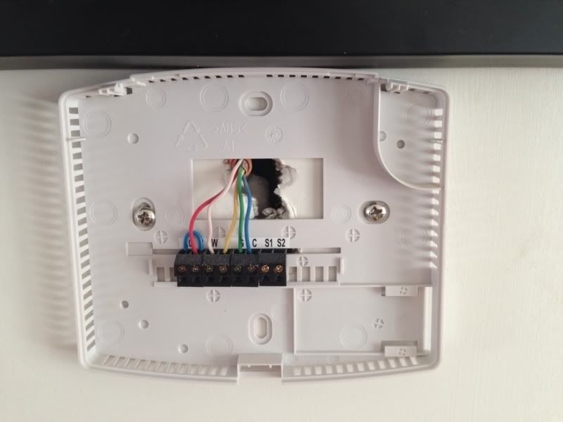

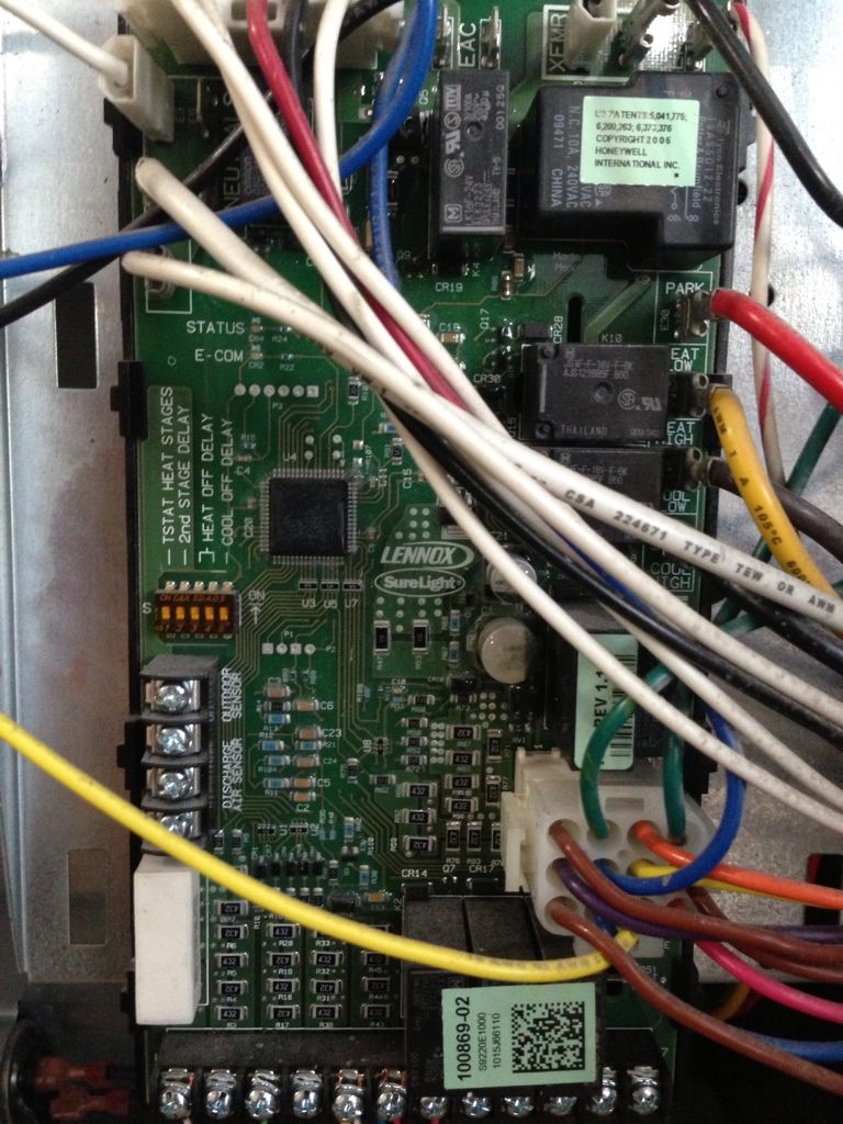

Read through some threads and have done some research on the different models and I am writing to you to get some validation on my plans.
Currently I have a 2100sq ft above garage home. I have a lennox cx34-38b-6f-3 HVAC being controlled by an Aprilaire 8463 thermo.
What I plan on doing is adding an Aprilaire 500 humidifier to the HVAC and upgrading my thermo to a HW prestige thermo.
This should not be a problem wiring correct? My current wiring looks like this:
If you guys have any insight that would be greatly appreciated! Thank you in advance!
Ryan

Shouldn't be any problem at all, and are you going to do the model with the EIM? I'd suggest doing that so you can wire everything near the furnace than running new sets of wire.
Also, you'll be able to use the furnace as a true two stage furnace, and a few other things that it's not being used.

Correct, you don't need to spend money on the auto control that is not going to be installed. If you find one with out a control, that should save you even more.

I would get the manual, no need for the extra cost of an automatic control if you are not going to use it.

Started early this morning and everything seems to be working now! thanks guys!!
