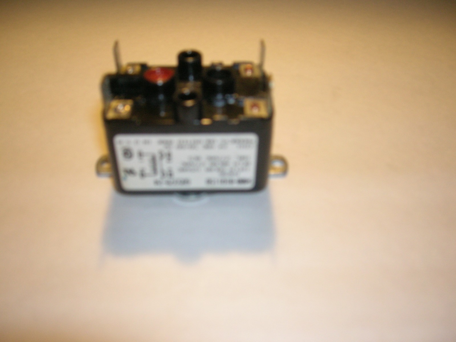

Old 03-01-14, 11:32 PM
C
Join Date: Mar 2014
Posts: 6
thanks!
Ah.... makes much more sense now. Thanks for the input! By the way, my relay has 2 posts on the coil side and 4 posts on the load side (it's the same relay that the earlier posts discuss). Does it matter which two I use on the load side? Thanks again for your help.
Name:  Photo on 3-1-14 at 11.28 PM.jpg
Size:  22.5 KBName:  Photo on 3-1-14 at 11.29 PM.jpg
Old 03-02-14, 04:39 AM
Houston204's Avatar
Join Date: Oct 2009
Location: Texas
Posts: 7,425
Received 17 Votes on 14 Posts
Yes, it is important to use normally open contacts for the load side.
This would be the top 2 terminals. Looks like it is 2 and 4 in your picture.

Need the C wire?
Hi,
Have installed 4 (!) nests in my houses, using just the R and W wires without difficulty, so clearly the nest can obtain the current it needs from those connections.
Now would like to control a millivolt fireplace.
Can I just go from 24V transformer to R, from W to coil side of relay, and from other side of the coil back to transformer?
And of course the millivolt lines from the fireplace to the switched side of the relay.
Thanks.
  #25
Old 11-30-14, 07:33 PM
PJmax's Avatar
Join Date: Oct 2012
Location: Northern NJ - USA
Posts: 62,170
Received 1,528 Votes on 1,411 Posts
Welcome to the forums.
No...that is not true. It's supposed to be able to steal power to keep charged but that doesn't happen in many applications. Count yourself lucky.
You can certainly try your method without hurting anything. I'm not sure the relay has enough resistance to run the thermostat. If not...the other circuit is clearly posted previously in this thread.
