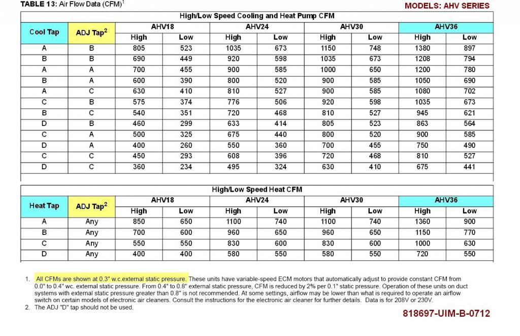

http://www.expressoverstock.com/pdfs/York/AHV_IG.pdf
with York AVH36C3XH21C Air Handler with 10kw Electric Heat
I can't find a York AVH manual. Could you have meant a York AHV ?
If this is the case it looks like the 9.6KW Nominal heat strip are energized as a single stage so I'd wire the EIM W3 to the air handler W1.
http://www.upgnet.com/pdffileredirec...uai-f-0213.pdf
While I haven't seen an air handler with a variable speed blower that requires 24 volts on G to energize the fan with a heating demand in a long time, This is all I see to indicate that the air handler will energize the blower with a heating demand on W1 with no mention of a 24 volt signal on G.
To Set Electric W1 Heat Airflow:
The blower speed required for 1st st
age electric heat is different than
cooling. Refer to Table 14 or 15 for the possible CFM selections. Refer
to Table10 for the minimum required airflow for the electric heater
installed. Find the desired airflow in Table 14 or 15 for low heat. Set the
HEAT jumper on the control as
indicated in Table 14 or 15.
I would use a clamp type amperage meter to verify that the blower is energized with the electric heat strips.

Yes I apologize for the typo it is an AHV36C. Ok I was wondering if the heater kicked the fan on all by itself when energized. So I guess I do not have to worry with jumping the G line then.

The installer did not change any of the jumpers on the AH board he left them all the same as they were:
Cool - A
Heat - C
Delay - A
Adjust - A
AC/HP - HP
Hum - On
The electric heat models specifies minimum speed of D, so I am guessing gong a little faster and using C will be fine.
I am thinking the Delay I should use is D - Temperate "best suited for most of country"
My main concern is the Delay and Adjust jumpers the current setting has the cfm settings for Hi of 1200 and lo of 780. But in the book it says something about getting figures from the outdoor technical guide ad in there the cooling capacity - with air handler coils rated cfm for the combo is listed as 895. So are the settings he left as default for cool and adjust correct?

What is your delta t (heat rise) with only the electric heat strips and the blower running?
Seems like we are only running 630CFM in heat mode.
What is the delta t (temperature difference across the air handler) in cool mode?
We want 1000 CFM if the outdoor unit is 2.5 tons and we want 400 CFM per ton.

the heat tap is set on C -630 lo and 1000 high for cfm. From what I see according to the manual it should be set at a minimum of D 550 and 720

I'd change cooling to speed tap A-C for 1080cfm , and move the EIM W3 wire from W1 to W2 on the air handler so we don't have glowing red heating elements.

Running cooling with an outdoor temp below 58 degrees is tough on the compressor . This can cause damage if the compressor is forced to try to compress liquid refrigerant instead of the vapor it normally sees.
Running the cooling test on a warmer day is advisable.
Running over 400 cfm per ton will reduce humidity removal capacity in cool mode. The blower speed should be set to match the outdoor unit for cool mode.

Looks like you are running ~ 1200 cfm with the heat strips. The delta tee looks good with the heat strips.
I would like to see a few degrees higher in heat pump heating mode but with a 31 degree outdoor temp this may not be an indication that you should reduce fan speed. At 48 degrees ambient it should see at least 18 degrees.
