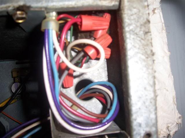

I need help hooking up a new 2GIG CT100 thermostat to a boiler (Burnham 204HNSL-BEI2) and an A/C unit (outside compressor and air handling unit in the attic - Compressor is a Carrier model A30X....I think....and I'm unsure of the make/model the air handling unit). Both the boiler and A/C units had old dial thermostats hooked to them. The A/C unit had 4 wires hooked to the old thermostat (White, Green, Red, and Yellow - there's a blue wire which was not hooked up). The Boiler has 2 wires (Red and White).
How do I hook the available wires to my 2GIG CT100 so one thermostat can control both the boiler and A/C units?
See linked picture below for exposed wires which were hooked to a dial thermostat on the left, and the existing dial thermostat for the boiler at right.
imgur: the simple image sharer

It is unlikely that any of those four wires is C. You may be able to use white for C by moving it at the indoor unit if is not in use for an electric heat strip. A picture of the wire connections at the air handler would be of assistance. It may be necessary to fan out the connections to clearly see what went where.

The panel that does not have copper pipes running it through it probably has something like this in a corner. "Fanning out" the wire connections might make it easier to see the connections.
These are common wire connection (though Carrier will have a gray wire from the air handler connected to stat G).

I was finally able to get into my attic to take a look at the air handling unit. I was able to trace the thermostat wire to where it entered the unit, but couldn't find the panel where I could see the exposed wires and wire nuts making connections. I did find the sticker on the unit with the model number (Carrier FK4CNF002 - see attached picture). Do you, by chance, know which area of the unit has the panel where the wire connections are made so I can verify where the red, green, white, and yellow wires from my thermostat are connected to on the unit?

See page 14 for view of terminal strip. There is a C terminal available. This terminal strip can be found behind the door on the same side of the unit where the refrigerant lines enter but at the opposite end.

I found the board (see attached picture), and it looks like red, yellow and green are the only wires used from the handling unit to my thermostat. I see a 'C' terminal, but it looks like that is being used for communication to the compressor (it looks like a red and white wire are going to the compressor outside).
Can I connect a wire to the 'C' terminal on the board and then to the 'C' terminal on my thermostat to get power to the 'stat?
While looking at the board I also found that my 3 amp fuse was blown. So I am going to replace that as well.
Absolutely.
Best to turn power off to air handler before making wiring changes to prevent protection fuse from blowing.

Thanks for all your help. I was able to connect my 2Gig CT100 thermostat to both my air handler/air conditioning unit as well as my boiler while also powering my thermostat with the newly connected "C" wire at the air handler. Things are working perfectly now all thanks to you! Many thanks for your prompt, accurate, and detailed responses to my questions.
