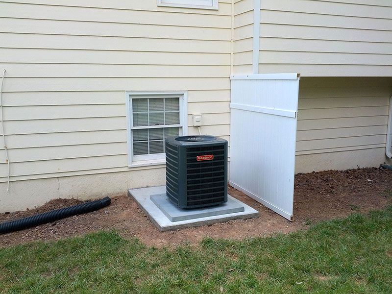

Here is my old one. I matched up all but the white jumper and just followed the instructions for a 2-stage heat pump. The one going to the o/b is actually orange in color.
I have a new Goodman 13 seer and matching air handler.
The white wall is from the previous unit preventing noise on my rear deck further to the right. This unit is so quiet its not needed. This is just after the installation., Pine needles have been applied around. The white wall remains. Cannot even hear it when enjoying the deck.
The black pipe was just laying around. I should have pulled it out of the frame.
