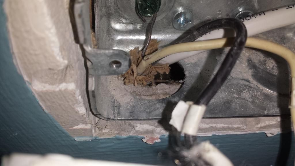

Below is my suspected cause for the issue. The wire appears to have been damaged when they ran the new wire up. Could something like this be causing the issue?

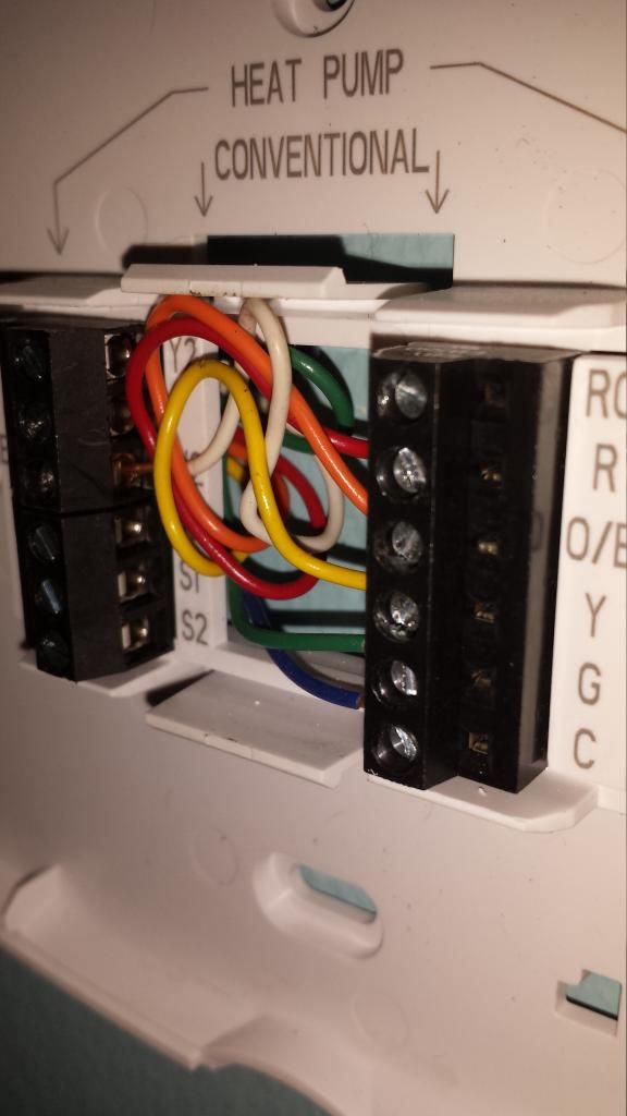

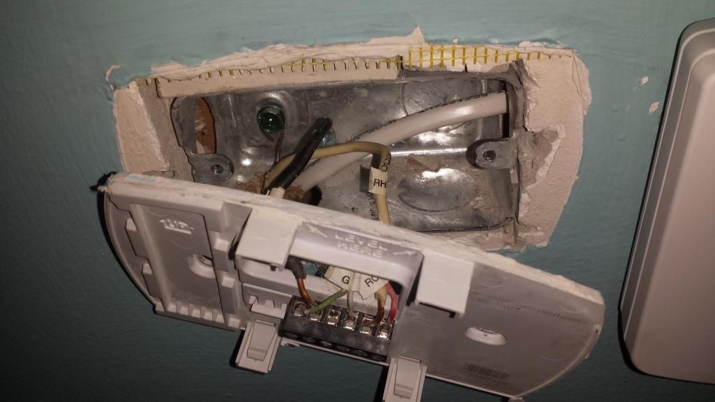

Just for reference, here is where the new wires end up going for the new thermostat. I didn't want to take it off the wall since I'm making an installation warranty claim, but the wires are all coming through a hole in the wall that is behind the left area of the thermostat plate.

There is something strange there. It looks like a cloth covered romex was originally in the box. The reason the connector is not in is because they fished a new thermostat cable up thru that box to your new thermostat.
The presence of that romex signifies high voltage as in old style 120v thermostat. They may have converted the boiler to run on a 24v control signal which would mean that cable passing thru the box is fine.
When they moved the A/C to the new thermostat they should have removed all extra wires from the old thermostat. That heavy wire.... white and black..... should be connected to the W and R or Rh terminals.
