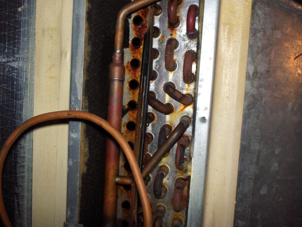

You may be right, but it seems like the AC coil needs to be cleaned as I can see the tube getting freezed at the AC unit end. Is there a way I can check the heating coil?

If your furnace has a metal vent pipe it will not have a coil since it will not have a secondary heat exchanger.
The cooling coil and the blower wheel should be inspected.
Many evaporator coils have a removable panel to allow you to see the coil.
The outlet side of the coil can still appear clean when the inlet side is dirty.
This coil was similar to a drier filter. The lint and dog fur peeled off.

I'm a little confused..... you previously said the A/C was working fine. So as it turns out the A/C is not working properly.
Low air flow can cause a burning smell in heat mode.

AC was working good when I checked it after installing the relay switch. But now, since it's pretty hot here, I tried to run the AC for longer hours, but there is very little cooling (almost no cooling at all) with less air flow from the vents. When I run the Fan only (without AC), the air flow is much better. I will try to take a picture of the evaporator coil and the heat sink (if I manage to open the cover properly). Thanks again guys for all the help you provided.
