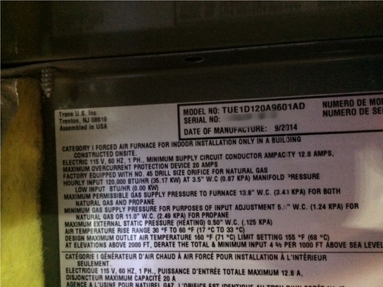

Working on getting a RTH9580WF installed on my Trane AC/Furnace.
There is a terminal labeled C inside the unit and I have a 8 wire thermostat wire.
So I wired the brown wire to the C terminal and proceeded to hook up the new thermostat and got nothing (no power at stat). Broke out the volt meter and with the furnace door switch activated I tested the C terminal in the furnace and got 0 volts. Went down the line and found 26v at the R terminal. Moved my brown wire down to R, tested voltage at the thermostat brown wire and get 26v at all times. Reconnected the new Honeywell and still nothing. I am suspecting a bad unit, but wanted to see what you guys think before I take this one back. I did take my existing plane jane non programmable Honeywell and connected my 26v brown wire to the C terminal in the stat and did not get power there either (it can take batteries) which has me questioning if its a wiring issue or stat issue.
I expected the C terminal in the furnace to be 24v, but I'm not getting it with my volt meter. The R terminal currently has only a water sensor connected to it. Here are the pictures. This picture was taken before I moved the brown wire from C to R.

Welcome to the forums.
R = 24vac
C = common
Between R and C you should measure your 24vac.

Thanks for the reply. What should I do? If I put the brown wire on C, the only thing on R is the water sensor. Do I jumper C and R? Putting brown on C leaves me with no voltage.

It looks like a black wire from the float switch is connected to the R terminal but the second black wire from the float switch isn't connected to anything?
I would connect stat blue to furnace common, connect stat red to the float switch black wire that isn't connected to anything and connect red and to R at the stat. I would connect blue to C at the stat.
He meant to say and connect red to R at the stat.
This way you have the float switch connected in series with the 24v to the stat. If you have a pan overflow it'll shut down the stat and you'll know there is a problem.

There are 3 tstat wires in the enclosure. 1 to the actual tstat, 1 to the humidistat, and 1 to the outside unit. There is a red wire from the humidistat connecting to the red and yellow thermostat wire connection. Does that change the plan? What's missing from the picture is the outside unit wire. Unfortunately I have to climb an 8 foot ladder and move a 4x6 piece of MDF to gain access to the attic area. I want to have a plan when I get up there. Getting in and out of the area is a task.
I could always use a 24v tansformer I have and run new wires from the transformer to the blue/brown and plug the blue in the thermostat C and brown in the Rc. Of course that still leaves the issue with the float not being connected correctly. This is a new house so to see this omission is a bit concerning. They have already forgotton to purge the nitrogen out of the line keeping the AC from running.

Stat Y and one of the 2 condenser wires should be connected to the furnace Y for correct airflow in cool mode.
The remaining condenser wire connects to furnace C along with the stat C wire.

Thanks for all the help. Came home at lunch and got it all taken care of. Nice new wifi stat installed.

With the air handler in the attic you definitely want the float switch connected.
