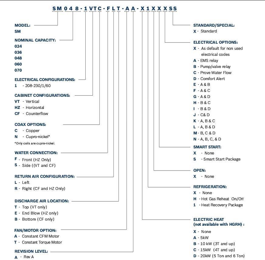

Does this unit also have electric heat strips?
There should be 7 more digits in that model number. If the next number is an X you do not have electric heat strips. If you have heat strips it is possible that you are energizing them instead of stage 2 compressor.

The system includes backup electric heat. The full model number is:
SM036-1VTC-SLT-AA-B1XXXX
