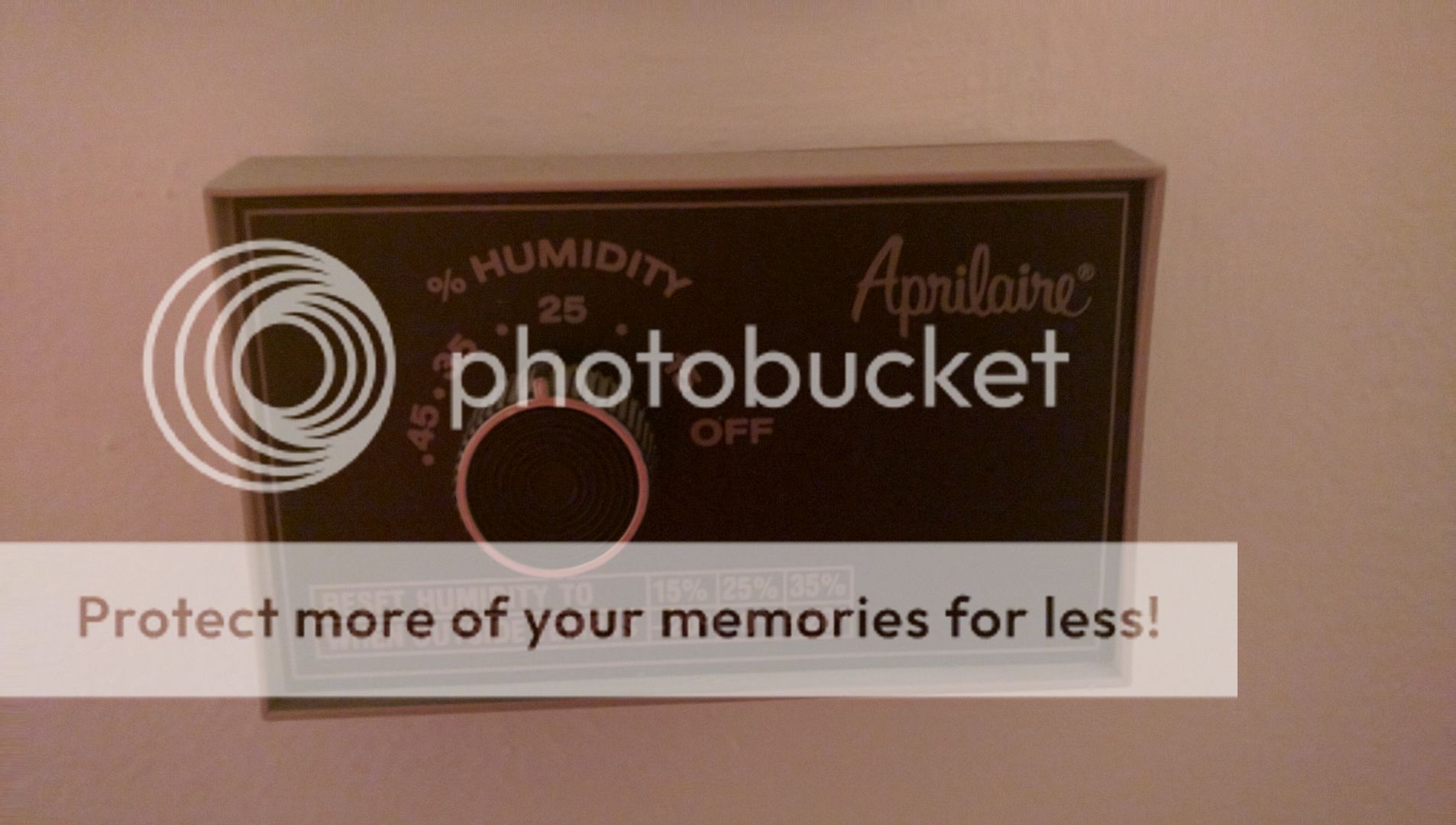

I have a nest on order that should arrive in a few days. Ive read most of the install stuff. I need help with the wiring for my humidifier. My current control looks like this.
Here's the humidifier
Here's pic of the current thermostat.
Can anyone give me info regarding how to hook up the aprilaire? I can get more pics and info if needed.
Thanks.

Welcome to the forums.
There are several 760 models. You show a humidistat. Does that wiring also involve a transformer ?

Look at the base of the humidifier and trace where the wiring goes. If it goes just to that humidistat..... then you will need a relay like shown in Houston's post.

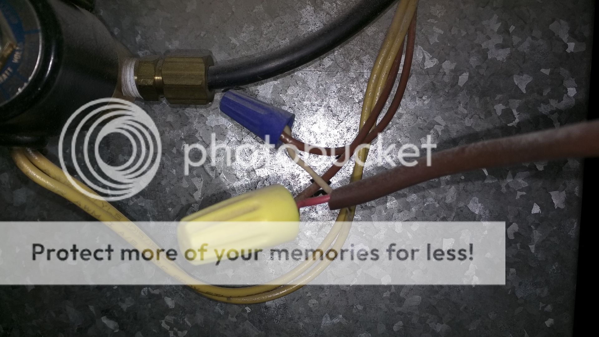

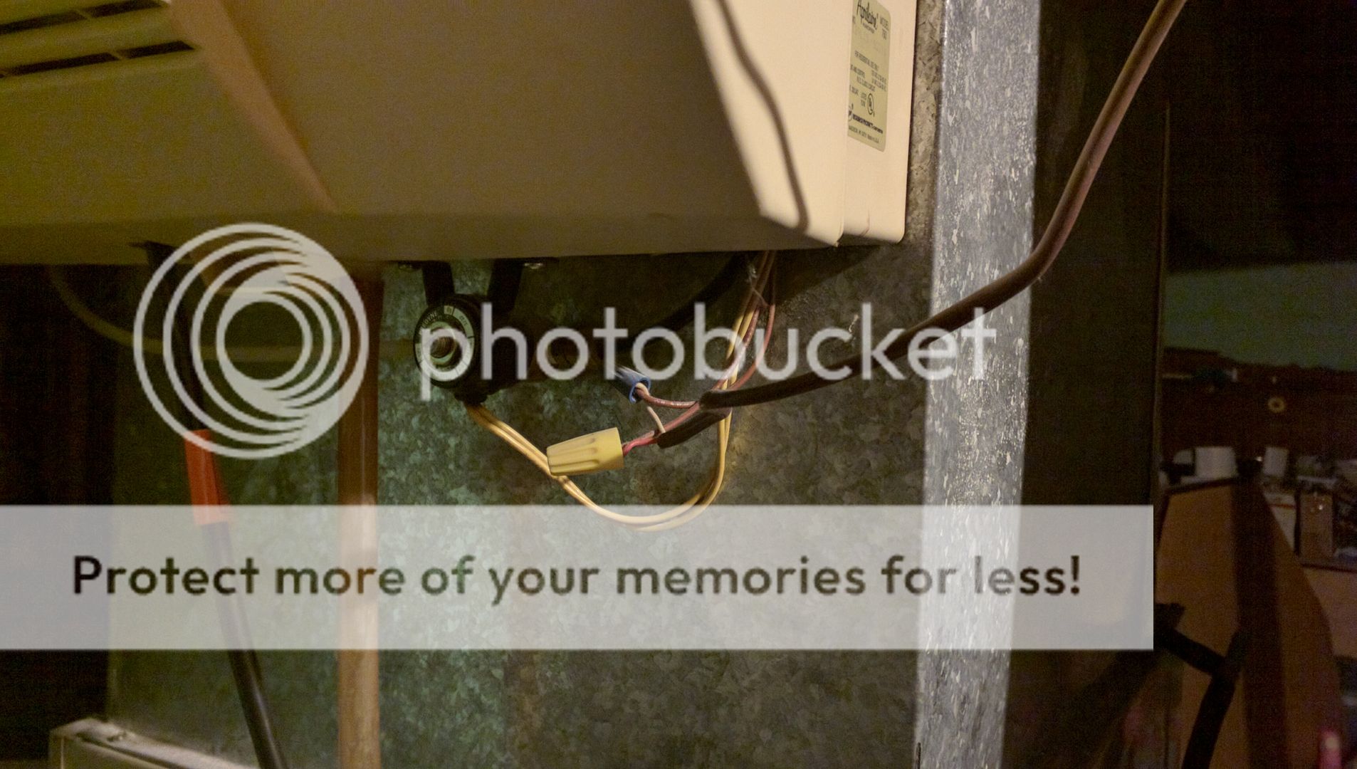

Old 01-05-16, 05:22 AM
V
Join Date: Jan 2016
Posts: 13
Here's a pic of the wiring. It appears the wires come out of the humidifier and go directly up to the stat.
Red and white with brown sleeve go right up thru the floor to the stat.
Humidifier is plugged into an outlet mount on the side of the furnace.
Page 15 and 16 here have some install info for a humidifier. Looks like I need to add a relay?
It also talks about knowing if the humidifier can run without heating or cooling and if it needs the fan to operate. How would I find that out?
http://support-assets.nest.com/image...ller-Guide.pdf
Thanks again.

It got caught in the SPAM control system as you are a new member yet. Can you see it now ?
Yes.... you will need a relay. The receptacle that the humidifier is plugged in to is probably controlled to operate with the blower.
Set the Nest up to humidify only with a call for heat.

Old 01-05-16, 12:17 PM
V
Join Date: Jan 2016
Posts: 13
Awesome. Thanks for the wiring pic. That will help a lot.
The "C" wire should already run from the furnace to the stat so I should be able to find that color and trace it back to where it hooks to the furnace and then run a new wire from there?
Old 01-05-16, 12:19 PM
PJmax's Avatar
Join Date: Oct 2012
Location: Northern NJ - USA
Posts: 61,872
Received 1,480 Votes on 1,368 Posts
Yes...the C wire at the stat will appear at the furnace.

GOt the Nest yesterday. Picking up the relay today. Heres a pic of the board in the furnace.
Im going to run a wire from the C screw (hard to see but its the white wire on the right) and run that to the relay like posted below.
How can I test the 2 wires currently at the humistat to see which one is the load wire? Can I test it with a meter? Should it be 12 volts?
Old 01-07-16, 10:29 AM
Houston204's Avatar
Join Date: Oct 2009
Location: Texas
Posts: 7,425
Received 17 Votes on 14 Posts
You don't need to identify the load wire.
Pete was showing that the normally open contacts connect to the load, which is a humidifier in this application.
The coil on the isolation relay connects to the star terminal and to furnace C.
