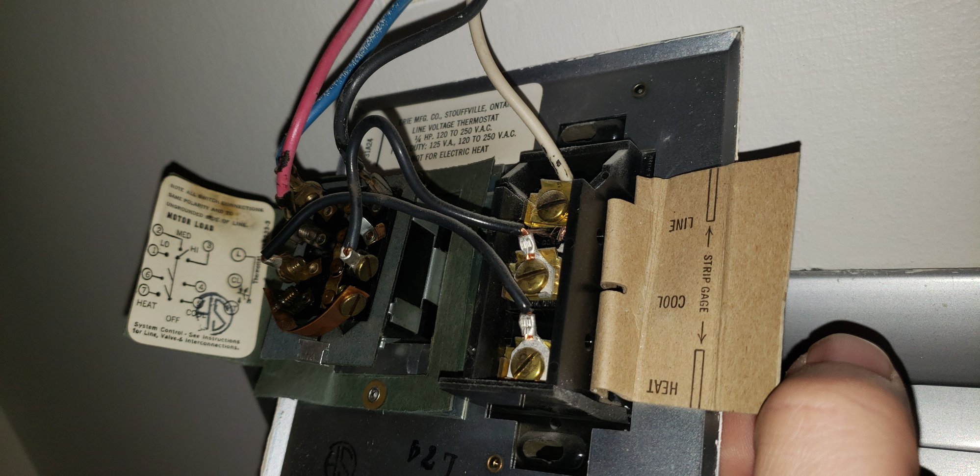

Guys, I have something like this below, and it appears that it is a 120V system with 7 Wires, and not 8.
I used my multimeter and was able to confirm that
1)with L(hot) and N(Neutral) I get 120V
2)with L(hot) and W/Y(HEAT) I get 0V
3)with L(hot) and Y/A(AC) I get 0V
4)with L(hot) and GL(FAN LOW) I get 120V
5)with L(hot) and GM(FAN Medium I get 120V
6)with L(hot) and GH(FAN High) I get 120V
What that means is that I can literally use L as a common instead of Blue wire as shown in the below image. Because there is no Blue common wire that I have in my circuit and the one I have is for Fan Medium which I don't think is the hot wire.
Please let me know. I have already bought the below products and already have Nest 3rd Gen Pro Thermostat.

Yup, that sounds about right and should work.
You may want to check if the blue wire might actually be there (left in the wall). I've seen a case where they upgraded the thermostat and wired the COM + L together (probably for convenience). But they left the extra Blue wire unconnected in the wall.

I am in the process of changing the 120V T-stat to 24v Nest for 3 speed fan coil.
there is 4 wires coming from the JB inside the unit to the T-stat
White - Line
Black - High speed fan
Blue - Med speed fan
Red - Low speed fan
from the JB the neutral goes straight to the motor.
however I don't quite understand how the Nest will switch between cool and heat as there is no W or Y wires currently.
Also given the pictures and the info provided am I ok to do the conversion with:
1. 20VA Transformer
2. 3 x 24V plug in relays rated at 5Amps for High (3.7A inrush 2.6A running), Med.(2.75A/2.1), Low fan speed (2.5/1.7A). and
3. Nest Learning thermostat.
I want to install them in a Pvc box inside the fan coil unit in case there is any moisture ever - pretty dry now.
should I keep the transformer out of the box to prevent overheating?
much appreciated!

I forgot to mention the system I have is 2 pipe where there is no actuators or control valves
the water is flowing constantly and is controlled by the condo corp. for the change over, hot in winter and cold in summer.

cityel, sounds like you have no need for Heat/Cool wires since your condo controls it. You only have control over the fan speeds. I know that Nest uses the W / Y lines for control *AND* for power. So, you'll need to connect 24V power to the W terminal, even if it doesn't actually do anything. I don't have any experience with your kind of setup, so hopefully someone else can help you with any follow-up questions.
