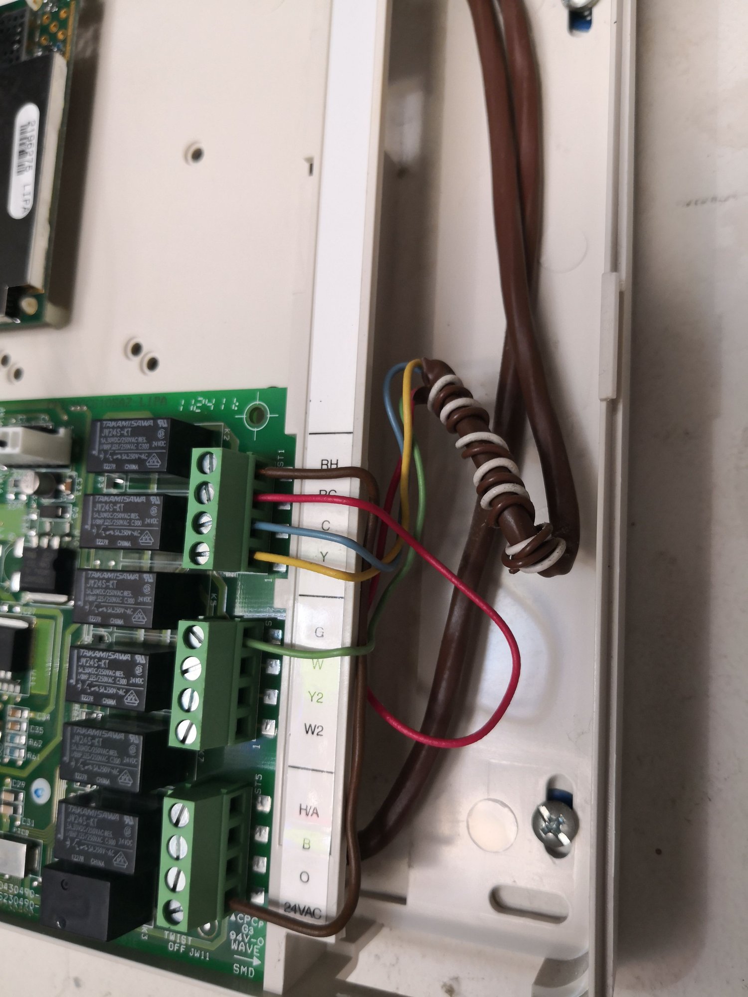

Hello all,
We moved into a home where the previous home owner signed up for PSEG thermostat monitoring program for energy efficiency. The program ended. The thermostat installed was a Carrier And the control module located but the air handler in my garage. I removed the thermostat and I see 5 wires (2 white, 2 red, and a green), where only V+ & Vg were used. I know I need to bypass the control module if I want to use a smart thermostat. The question is do I need to run a new set of wires from air handler to the thermostat? I doubt the energy company did that when the installed the Carrier Thermostat, which is why there are 5 wires in the wall?
The thermostat controls only the center ac system, no heat.

Welcome to the forums.
That's the thermostat side of a communicating system. You need to go to the air handler and find the other half of the system. It's probably a white box with the controller in it. We need to see how many wires are connected to it.
A basic split A/C usually only needs three wires......R, Y, G.... four with a powered thermostat.... C.

No.... they won't.
The red and green on the left side go to the stat.
The wires below on the right side go to the air handler.....
Rc - red
C - blue
Y - yellow
G - green
I think Rh and 24vac go to a separate 24v transformer.
Post the model number from that EIM.
Basically the four wires on the right need to connect with four wires to the stat.

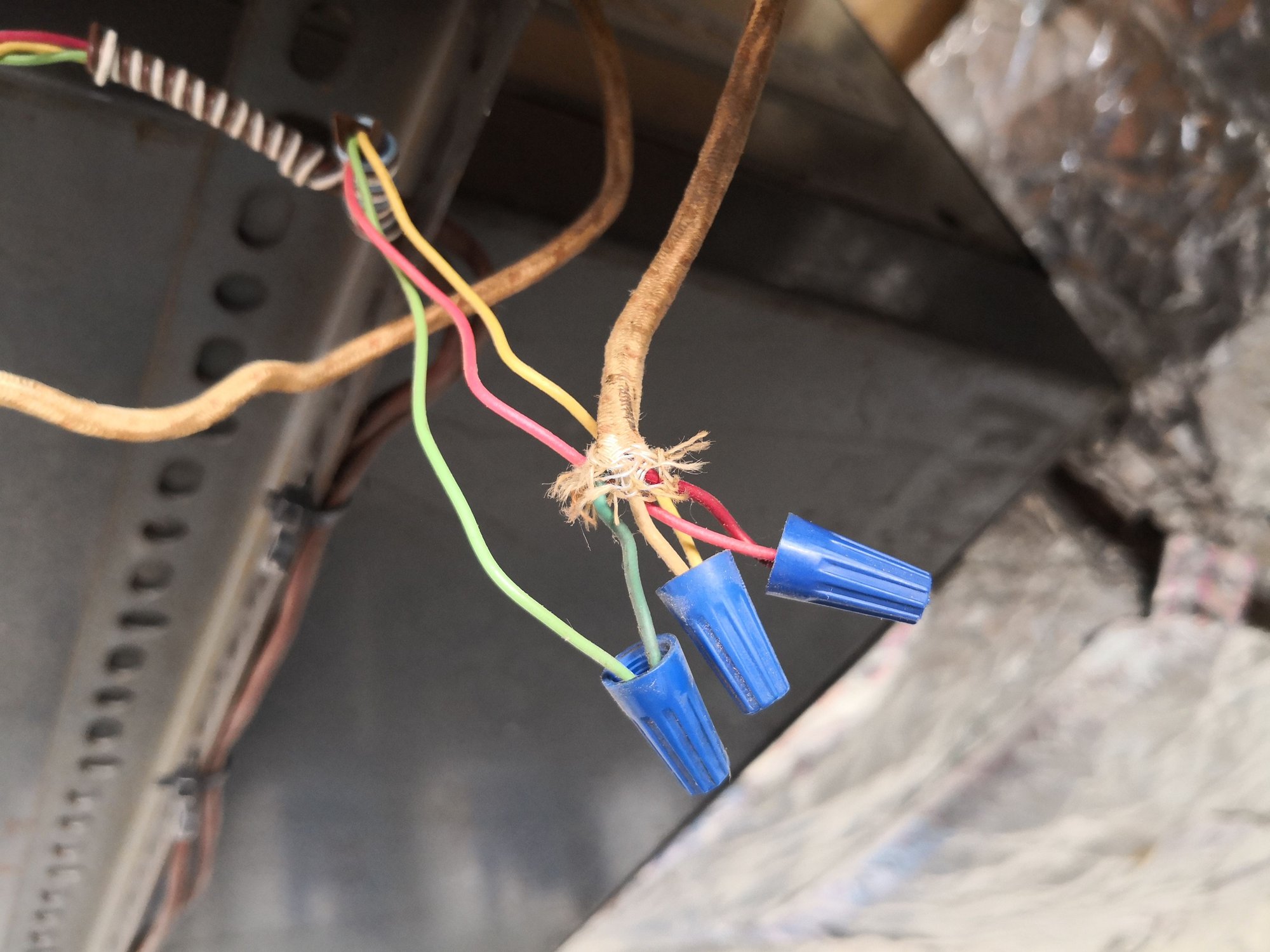

All I see from EIM is Carrier 960-960020 on the cover, nothing behind the EIM.
Below are couple pictures of wiring from EIM to air handler.
The wires behind the stat do not match these wires by the air handler, how do I know which one corresponds to which? Again I doubt the energy company route new wires for V+&Vg to the stat, they just used the existing 5 wires I have but just used red and green as V+&Vg and discard the remaining 3 wires.

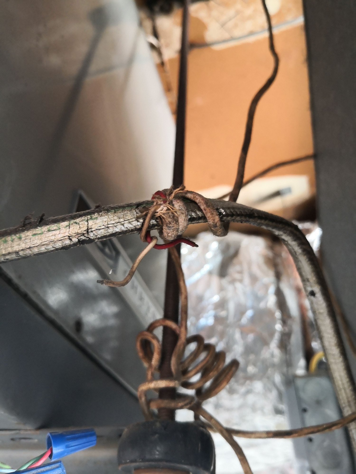

We see 5 wires at the stat.
Please confirm red, white and green in one cable and red and white in other cable.
I'll assume this to be correct and based on that.... the three wire cable goes to the A/C and is cable D.
The two wire cable more than likely goes to the heat and is unused.
Cables A and B go to the EIM.
Cable C probably goes to the outside condenser.
I need to see the cable A to cable C connections better.
Can you fan the wires out and post another picture.
Looks like only three usable wires to the stat. That means no usable C wire.

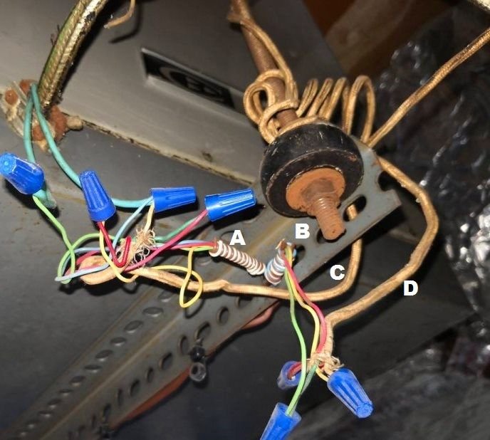

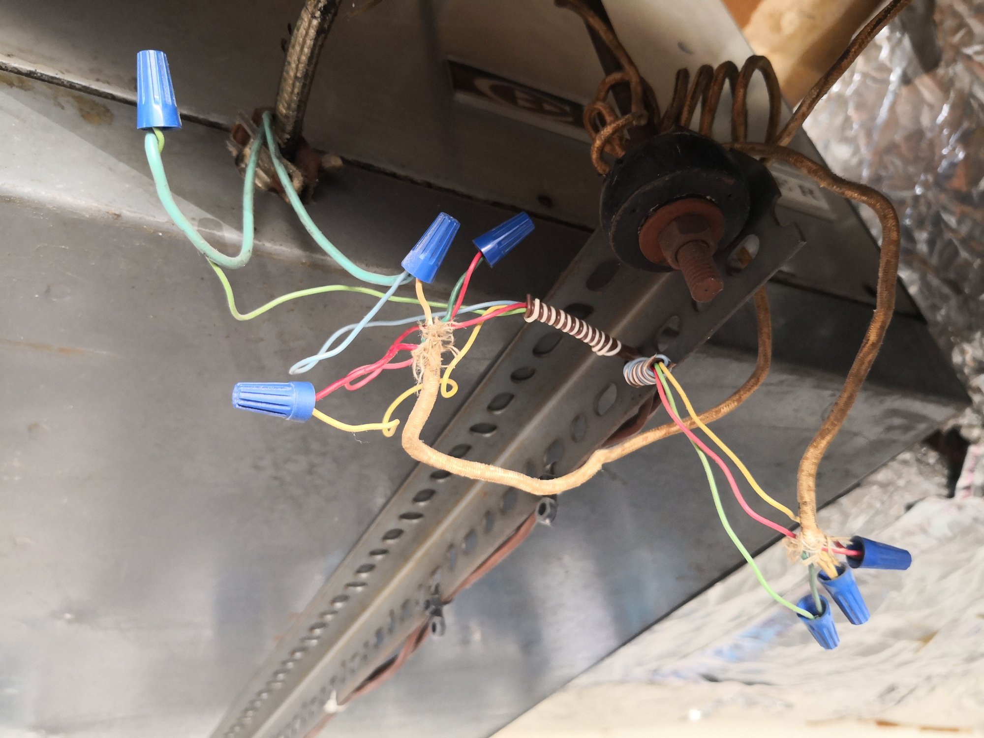

At the stat: all 5 wires come out of same conduit, except a red & white were cut very short. Not sure if it's heat since I have heat thermostat at another location.
below are clearer pictures. Inside the EIM, I see RH jumper to 24VDC.
Wire sets A & C:
Wire set D:
​​​It's probably the 3 wires that goes to the stat. From the picture, red to red, yellow to white, green to green up to ceiling.... And that gets traced back into left side of EIM, V+&Vg.
Btw, I see a white/red wires here not connected at all and also go up to ceiling. Could these be the cut white/red wires at the stat?

Hi, can you determine where the control panel is on the AH, see if you can determine where which cable is connected to the control board there.
Geo

Yes....that cable with red and white probably goes to the stat. That means two cables at the stat because wire colors cannot duplicate in one cable. That's good.
I have everything I need. I'll work out the color connections for you.

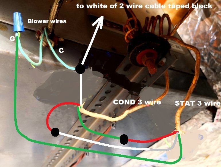

At the thermostat end.
Three wire cable......
red - R
white - Y
green - G
Two wire cable....
white - C. Tape this wire black so that it doesn't get confused with the white of the 3 wire cable.
red - spare
XXXXXXXXXXXXXXXXXXXXXXXXXXXXXXXXXXXXXXXXXXXXXXXXXXXXXX
At the air handler. There are three cables we are interested in.
Stat 3 wire cable....
red stat to cond green
white stat to cond red
green stat to G wire coming out of air handler.
Cond 3 wire cable....
red cond to stat white
white cond to C blower wire and white wire (taped) black from that two wire cable we don't see.
green cond to red stat
Two diagrams. Look it over and see if it's clear.
Illustrating functions.
Actual wiring.

Wow more involved than I thought.... I will have to study it. I was thinking removing the wires on right side of the EIM and connect to the 3 stat wires + the extra white as C wire.
So after doing the way you drew out, I will have 4 wires at the stat with the extra white (labeled black) as the C wire? So I will be able to use smart stats? I was actually thinking to just get the Emerson WiFi stat.
​​​​​​Thank you
Old 07-28-20, 07:14 PM
PJmax's Avatar
Join Date: Oct 2012
Location: Northern NJ - USA
Posts: 57,627
Received 904 Votes on 844 Posts
It looks involved but actually you are just removing the EIM wiring.
That's why I actually drew the connections. As long as you know which cable is which... you can't go wrong.
Yes..... using that two wire cable will bring C to the thermostat. Just make sure you somehow change it's color at both ends so that's easy to see. I carry many color tapes with me. I'd make it blue but any color is ok.

I wired as you drew out... Installed the Emerson ST55.
However when I switched to cool mode, only fan comes on, condenser is not on.
Please help

You put all the wiring back on the EIM ?
Does the blower switch on and off correctly ?
You have the (3w) white wire on Y ?
Does the stat light up and appear to work ?
Did you allow for the 5 minute delayed condenser startup ?
Connecting the red and green from the COND cable should start the condenser.
If it doesn't...... follow the COND cable. It should connect to a transformer and splice to a two wire cable which would be the outside condenser.

I disconnect from all the wire nuts and followed your diagram. I didn't touch anything inside EIM.
Yes I have the 3 wire white as Y, the other 2 wire white as C.
I turned the stat on "cool" mode and the blower comes on right away, but no condenser. I let it ran couple minutes.
The blower also turns on when I switched fan mode to on... So blower is turning on/off fine.
On my old stat, when I turn to cool mode, condenser starts up pretty much right away.
Right now I wired everything back to the way it was so I can have AC tonight. Now too sure why it wasn't working. Your diagram makes sense to me.

Sorry which red and green?
I have only wired it per your sketch so far.
