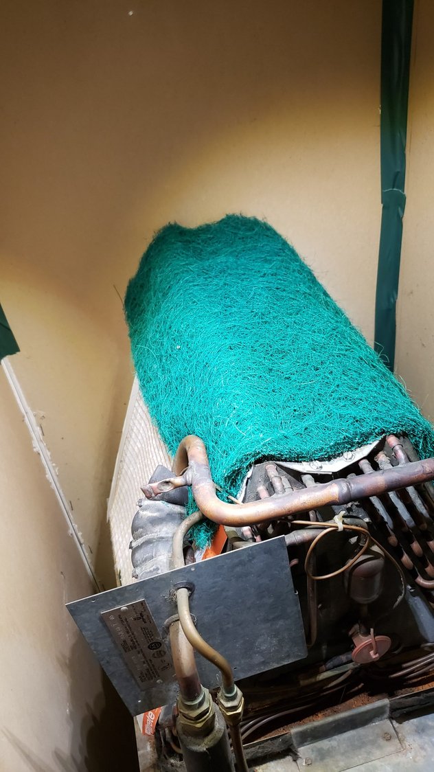

Part 2 - Air Filter Install
Also, once we figure this out, I need to know if this is an efficient way to filter the air since there isnt a way to put the filter inside the unit where it is supposed to go since pieces are missing.
these cover the radiator fins
inside unit where filter was designed to go
washable filters on both air return intakes
