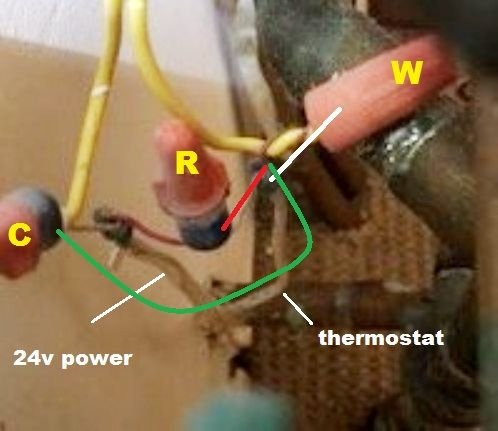

This where the other end of the two thermostat wires connect in the bottom of the image in the orange wire nuts connected to the heavier yellow wires
Not sure if this is a water valve or zone controller
That is a Honeywell zone valve.
The red wires are the end switch and control the boiler. The yellow wires are the thermostat.
Can you post a bigger picture of the splices. I don't need to see the zone valve itself.
Splices from thermostat near Zone Valve. the white thermostat cable from the bottom left comes from the thermostat. The white thermostat cable coming from the bottom right goes toward the air handler to what looks like another zone valve (see Image C)
Wires at The Thermostat
Image C
Close up of wires in Image C
That was a bigger picture.....
This is a bigger picture.....
Just attach the green wire from the stat cable to the C wirenut splice. That's it.

1. So if I use the Green wire as my C - the R, W & C are sufficient for my new Wifi thermostat? Don't need 5 wires?
2. What I was calling the second thermostat wire that seemed to go toward my air handler & near what looked like another zone valve you are calling "24v". What does that other zone valve near the air handler represent - one of my other baseboard only thermostat zone valves perhaps?
3. What do the thick Red Wires coming from the zone valve do?
4. When I make the C wire connection do I need to shut the breaker for the boiler?
Thanks
Thanks
1) with a boiler.... you only need three wires. There is no blower to control.
2) that cable carries 24v power from the transformer to both zone valves.
3) on a call for heat.... the thermostat tells the zone valve to open. When the zone valve is fully opened the internal end switch shorts the red wires telling the boiler to run.
4) I would connect the green to the stat C first and then to the C spice. As long as the splice doesn't touch ground you won't have any problems.

Hi PJ
On your enlarged diagram: I had my cables reversed
The cable you label 24v is actually my thermostat cable. Does that change anything? I would think not since all you're still doing is splicing the C wires of the 24v Power and thermostat cables anyway but before I do it I would like to check.
On a totally separate note. Two of my other baseboard thermostats appear to be line voltage. I'm assuming I can't use this particular type of Wifi thermostat for those as per the manual.
One point of clarification - I meant attach the C wire to the wire nut splice not the other C wire because the other end of the 24v cable C wire goes no where.

Proper R and W placement is critical.
The R at the thermostat stands for 24v power.
The W at the thermostat stands for switched heating 24v.
Consider it this way..... R = 24v + and C = 24v - (even though we are working with AC.)
Post some pictures of the other wiring. I may recognize what was done.

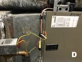

Close up : I've labeled the thermostat Cable - "Cable A" to the right & the other Cable which goes to near air handler "Cable B" on the left
Zoomed Out view with wires going into Zone valve

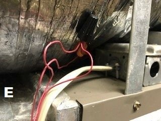

This is the other end of "Cable B" near the air handler. Of note the red curled wire is not from Cable B, one of the curled white wires is from Cable B
This is a zoomed out view of what's going on in air handler room. The Red wire from Cable B seems to go up top of air handler and is wire nutted to heavy red wire going into that switch box, the curled white wire from Cable B is pigtailed to another curled white wire and a heavy yellow wire going to that zone valve.
Close up of that junction box with switch on top of air handler. That switch shuts my air handler if turned off

I'm not done with the first part because the labels were not accurate during our original exchange so I was trying to get clarification:
Picture A was already posted but I was trying to accurately label the cables and give some more detail
Regarding the first part - on the enlarged labeled diagram YOU sent back to me - the cable you labeled stat is NOT the cable that goes to the thermostat but instead that cable actually goes down toward the direction of the air handler(What I labeled "Cable B" -you can see where it ends up in Pictures C,D, & E) - possibly the 24v cable?
Again back to Picture A - the cable you labeled 24v on the enlarged diagram is actually my Stat cable (What I labeled "Cable A") . So basically the labeling of the cables 24v vs Stat are reversed from that blown up labeled diagram you sent me - Does this change anything with the hookup other than of course using the extra "C" wire from the actual thermostat cable?
What I tried to show in Pictures C, D & E was what was going on at the air handler to:
1. Confirm that the 24v Cable from Picture A is actually the 24v cable
2. Figure out what was going on with that other zone valve seen in Picture D (near air handler) since it doesn't have a distinct thermostat wire going to it
Apologize for the confusion. Thanks for your patience
