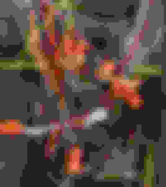

Hi everyone, I need help hooking up my Nest Learning 3rd gen thermostat for my upstairs and downstairs. I currently have Trane XL824 t'stat for downstairs with 7 wires and Trane XR724 for upstairs with 6 wires. My system has a heat pump and ALL electric. Air handler make and model is Carrier FJ4DNXD60. Outdoor unit is Carrier 25HBC560A0030061. I posted photos of my current wiring as well. TIA!

Here are the photos inside the air handler. Not sure which one so I took multiple shots. Hope this helps. TIA.

2nd to last picture.
In orange circle I see thermostat, condenser, red float wire and a mystery black wire.
In pink circle I see two transformers. Maybe one died and other is replacement ?
In the last picture.... it looks like the black and brown wires in the thermostat cable are wrapped around the cable as if they are spares and are not being used.
On the orange circle, the mentioned black and red wire, the red wire is connected to a device that’s attached to the drain pan and it’s for safety switch purposes if water fills up the pan. The black wire in there is connected to power a UV light that is also connected to one of the transformers you saw. It was installed by my AC guy before.

Do you have one or two air handlers? If one that is shared between thermostats then there would be a zone controller mounted somewhere on or near the air handler and that is where to look for the wires.
Just one air handler. So do I just cap off the black wire in the Nest thermostat ?
FYI..................
You have one system with two thermostats. Both thermostats go to the zoning board.
The zoning board determines which damper is open.
Then one cable goes to air handler and one to the outside condenser.
Mention this next time when replacing thermostats.
In your latest picture is an orange wire nut connection..... the thermostat black wire goes to the white wire of a red-green-white cable. Green is not used and red goes to C. That three wire cable is currently connected. You'd need to trace where it goes. Probably some type of fresh air inlet/damper.
