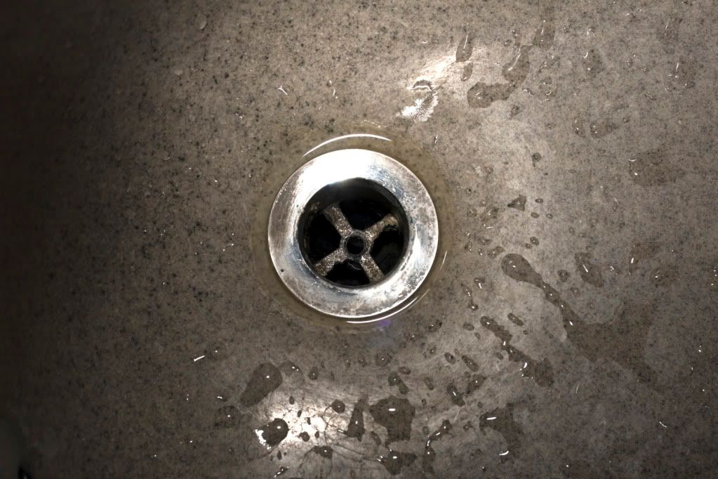

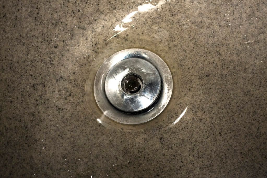

Hi, thanks to this forum I was able to disassemble my watco drain stopper and clear the nastiness inside. I decided to photograph the assembly to hopefully aid in the descriptions others have given.
There are three pieces to the drain. From left to right, they are the stopper, the bolt and the knob.
The stopper slides onto the bolt, and the knob screws into the stopper.
The bolt, with the stopper attached, screws into this area in the bathtub:
After unscrewing the knob to expose the bolt, this is what it should look like. Also, after you've cleaned the drain, this should be what it looks like before you screw the knob back on.
Step one, unscrew the knob to expose the bolt.
Step two, slide the stopper down to give you access to the bolt.
Step three, use pliers to unscrew the bolt from the bathtub. The bolt is not round, there is a flat side you you can use for leverage if you can get up under the top of the bolt.
Step four, clean drain.
Step five, with stopper attached to bolt, screw bolt back into bathtub.
Step six, screw knob back into stopper.
That should be it. I know my bathtub isn't the cleanest, but hopefully these photos will help someone visualize the procedure.
