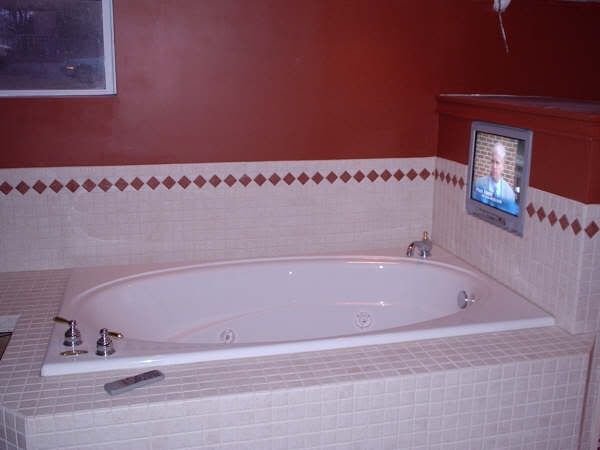

I think they mean the spout one end, the handles easy to reach on the other, the waterfall spout looks good where it's at.
I have the access panel for the faucet (and how often do you need access to that?).
Usually once, and that is the time it matters most. Nothing worse than telling the customer that the tile and wood is coming out to work on the faucet, or replace it when it falls behind the times in style.
This picture right here
If it wasn't for that removable marble slab in front of that tub, there is no way I could of installed that faucet. Talk about difficult. Sheeeeeeeesh

Gee, the TV seems a bit... excessive..
I'll grab a pic of the plumbing access tomorrow, since it finally stopped raining.
I had to get rather creative with the plumbing in order to get the waterfall pump in there, and it is a little noisier than I expected, probably because it is hard piped to the filler instead of using flexible line like the intake side.
