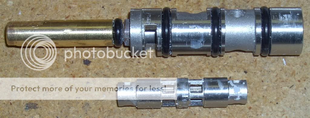

Here is a pic of the lime deposits on the small part. Notice the whitish/grayish stuff. That small part should move freely inside the larger part when shaken. I already replaced it before I did reverse engineering on this one. If you attempt to take this apart to clean it instead of buying a replacement, be careful removing the plastic retainer holding the small part in the larger one. I cracked it trying to remove it. I'm not suggesting cleaning it as opposed to replacing it, I just wanted to show the lime deposits.
This faucet was less than 2 years old on a shower that is rarely used.
Thanks for the help I found here. It is fixed now.
