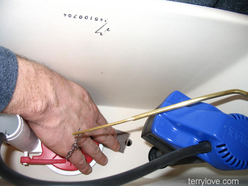

An easy extra step which has solved "mystery" tanks leaks for me in the past: if the interior bottom of the tank is not perfectly smooth,
take a bit of emory paper and smooth the bottom around the bolt holes, and if you are replacing it, the valve.

Hi, The picture in the previous post is great. Look where the hose is attached to the overflow, That is correct, If your hose goes down the inside of the pipe it will siphon out the water and give you the problem you are having. An easy check befor you replace everything.
Good Luck Woodbutcher

I really appreciate all you Guys jumping in here with great advice. Later I would like to know how Michael Thomas got such a beautiful (flawless) picture attached to the reply, but for now here is what I did so far, I went to Home depot an bought all new guts for the tank. Now I put the exact same flapper in, it is a round (ball like) shape and it drops straight down from a small Rod.
