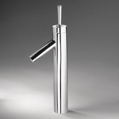

Hello, I have a leaky faucet and am looking for a replacement part. This is a unique raised faucet that empties into a glass bowl that sits on top of the vanity so it is not a standard part. I have not been able to even find a manufacturer name anywhere on the thing to tell me where to start. The only writing on the entire assembly once I took it all apart was on the piece that is broken.
Attached are some pics of the faucet and also of the broken piece. This part is basically all plastic and has broken inside so that it can no longer seal closed and water just flows out the top.
Any help identifying the manufacturer or possibly where to get a replacement part would be appreciated. I've tried a couple local plumbing stores and they were not able to figure it out either.
I'm hoping I don't have to replace the entire faucet assembly. Google only turns up another posting on a forum with the same problem --and no answer!
Here is the bad part. It's not clear but the marking says "NSF 1B720-01"
This part does come apart but I assume the replacement would be this whole blue piece.
Here is the faucet:
Thanks if you can help!

Ok, gang, I got THE answer after chasing this part around the world, leaving messages everywhere, taking my case to Lowes Home Improvement locally and tracking down their customer service number (NOT easy to find) and sweetly complaining about this unavailable cartridge that makes a $400 vanity and vessel bowl useless. They got back to me today and conceded that the replacement part is not available for sale anywhere. But they have spares! (removed policy violaton) and tell her you've got the Chocolate Continental Vanity with top and the cartridge has failed. She is sending me a replacement free and said they will do the same for others who call.

So, as others have eluded to, this part is impossible to order. But, fret not, I think I have found a replacement part for our $400 pedistal sets...(I'm replacing DL04BD blue cartridge)
http://alfanoplumbingparts.com/pdf/S...ridgesEtoH.pdf
Check out the Hydroplast 7014
They were friendly and easy to deal with.
I'm ordering one for $21 + shipping and will let you know how it turns out!
