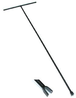

spdavid, "street key" and "curb key" may be the same but i dont think so since a "street key" in my area is a different animal from a "curb key".
google wont even take me to a plumbing related site when searching for "street key".
this is what we call a "street key"
this is what we call a "curb key"

Here your curb key is a street key and the other item is not used.
Nobody here would know what the term curb key meant.
