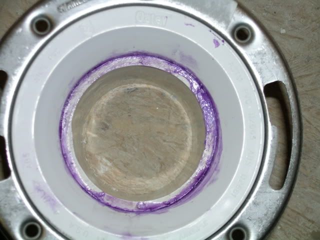

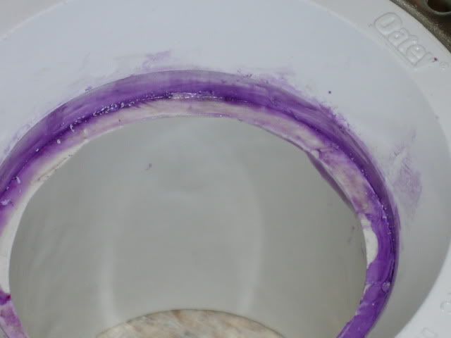

questions on setting toilet
about to set toilet and several questions.
when I was putting the short piece of pvc into the flange, I pushed down assuming the flange was tapered inside and the pipe would bottom. but it didn't and came out on side where wax ring will go. I tried to clean it off as best I could but wondered whether this will affect the seal? should I just get new one? some pics.
now about supply. I have cpvc coming up through floor. I got cpvc 1/4 turn valve. part glues to pipe and has threads on it. the valve then connects to this. so the valve could be replaced without having to cut cpvc. so how long do I leave the pipe coming out of floor before adding the valve? I am tempted to cut it real low since the valve can still be replaced. if I cut it high, how do you hide that ugly cpvc that has primer on it? just paint it? couldn't find any "covers" for the cpvc.

The wax actually is intalled where it says oatey on the flange and not the recessed part where the pipe is. Its OK
Cut the cpvc as you like. If you do cut low though and there is a problen the the joint close to the floor repair may be more difficult since you may need to replace the section that is below the floor.
I guess you can paint cpvc.

to update. I was able to exchange the toilet bowl. but the new one was the same way-tilted the exact same amount in the same direction. after calling gerber, they said that their rep was going to be in the area next day. so he went to place I bought my toilet and looked at their supply. he brought one to my house. I showed him how bad the one I had was. the one he brought was MUCH better-was only off by less than half of what the other two were. So I kept it. when he was leaving, I offered to pack up old one since I still had everything. he said keep it. I would consider using in my downstairs bathroom, but it is smaller and they screwed up there and had rough in at like 17" or so! they didn't calculate the finished wall location because of some old concrete. other guys put in offset flange to get me to 15". but this elongated bowl will be too close to other wall.
installed new one. used the plaster routine after putting down some washers to hold the toilet where I wanted it till plaster dried. got new plaster and it hardened in about 1/2 hour. everything seems good. toilet level. not sure how tight is tight enough on bolts. everyone says don't overtighten so I am being so cautious that they probably are not tight enough.
one quick question. in back of bowl in the center hole where tank connects, there are two little "divots" where the porcelain is not right. the are gray craters. the rep barely looked and said that is fine. looks like water will just sit in them after flush. I was going to put a little water in them to make sure it doesn't leak out anywhere. wondered about throwing some epoxy in them? can take pics if wanted.
