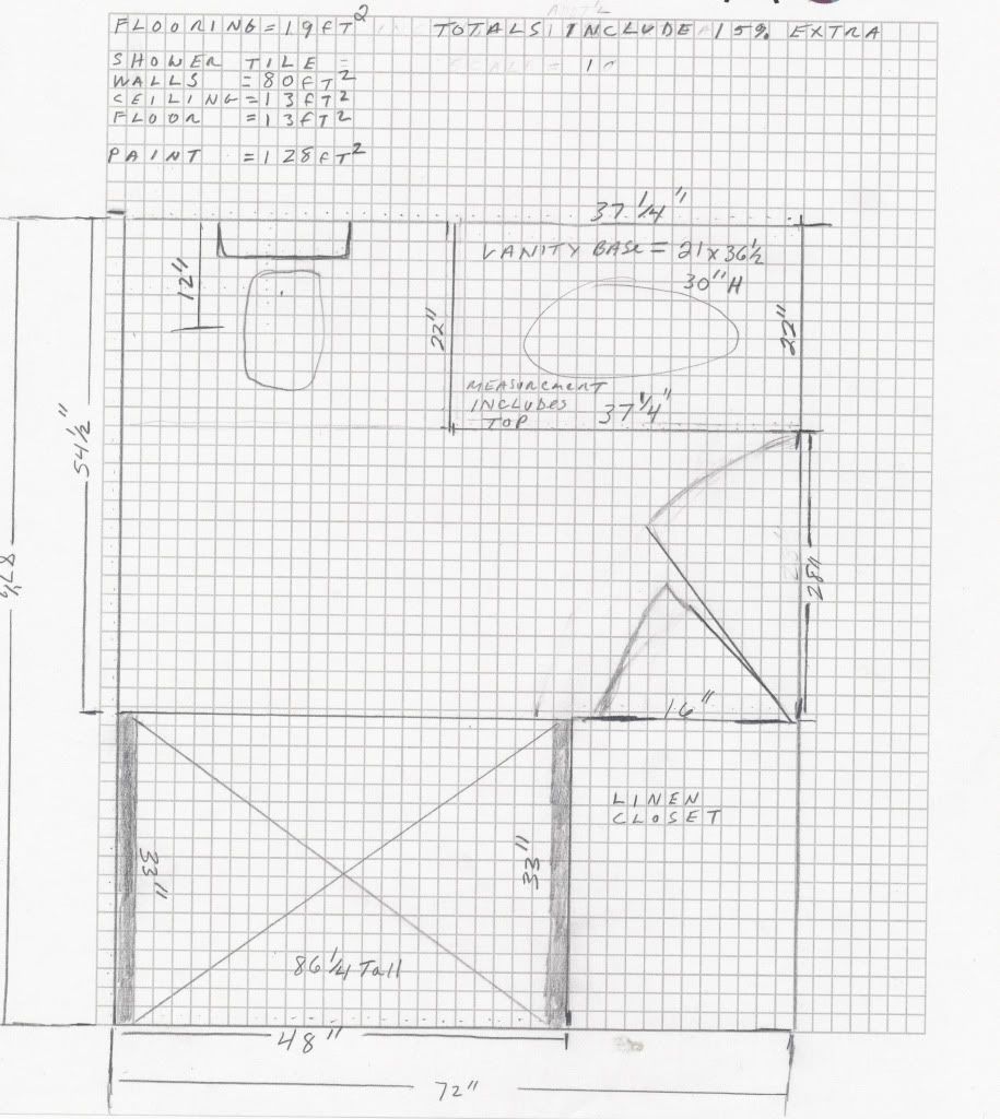

Here are some pics of the shower / bath that has to go. You may click on the pic to make them bigger
Below is the gap in the toilet I am concerned with...12" toilet on a 12" flange center...just doesn't seem right...
Looking in from the hallway. Their is a closet to the left behind the door and the shower just past that on the left.
Top half of shower it is about 85" from pan to ceiling. If I go with a stall kit (which is what I want) what do I do above the top of the shower kit. Most I am seeing stop around 75"
Bottom half of shower. Sorry, couldn't get far enough back to take a full pic. The pan is crack in the right corner behind the curtain.
as you can I see I am pretty much locked to the 48 x 32 dimensions.

If it were me I would add the two 2x4's to the left to make it 34". Your not extending the whole wall thats behind the dorr, but just a bump out on the left side of the shower.
Then you have so much more to chose from and cost will be way lower. The 48x32's are expensive.
Also where are you measuring from? Are you sure its 32".

Mike the measuremen 48x32 is stamped into the shower pan in one corner.
I'm still failing to see how adding 2x4's wil
Help. It would end up making the entry into the bath too narrow and not look right IMO.

Hmm. Its hard to explain. All will be the same. I will find a pic to show you what I mean. The back wall (window)is good. You will get the two inches there. The left wall where the diverter is need a two inch extension. Not the whole wall from the shower to the door.
I will find a pic and a carpenter may help out here.
Mike NJ
Mike NJ
Yes thats what I am talking about.
And if you need additonal inches you can add a 2x6 to that section between the closet door and the shower. Lay the 2x6 on the flat to get a additional 1 1/2 ".(It looks 6" wide) Plus sheet rock shoule get you 2".
Now you can go with the nice Sterling unit instead of that crummy mustee base and expensive walls. Some aquagalss is nice too.
Just a note. Its actually 35 1/4" you will need. If you measure from the back wall to the area you are showing in your first pic with the ruler, what do you get? Remember to subtract about 1" because the back wall has tile and sheet rock.

Mike NJ

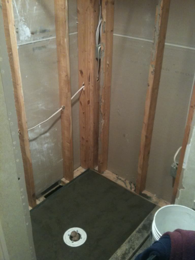

Well I finally have the time off from flying and the Demo has begun. The shower was built like crap and the Demo portion of the stall took just over an hour and that include 5 trips out the dumpster. The ceiling basically fell down with one good tug and the walls came down in about 3 sections each. It appears the people that built this thing put it up with liquid nails or its equivalent in 1989 with only a nail here and there. I'll post pictures later tonight. Not sure if I am going with a prefab stall or tile yet. Need to do some measuring yet as it is going to be close in getting the 36" required for the stall kit.
#21
727drvr - If it were me I would go with tile. A good looking tile job lasts forever, is DIY and design friendly, reasonably inexpensive and it will add value to your home. After a few years the fiberglass/acrylic surrounds start to show their age and their parentage. For me they are low end and a bit cheesy.
#22

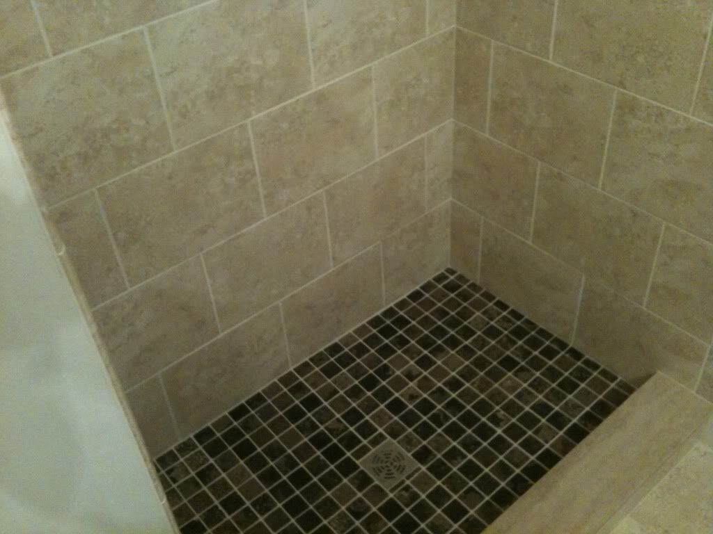

Well after shopping around several stores we have decided to go with an all tile shower including the floor. We just didn't like any of the prefab stuff. Now I get the fun of building a custom shower pan...Woo hoo!
#24

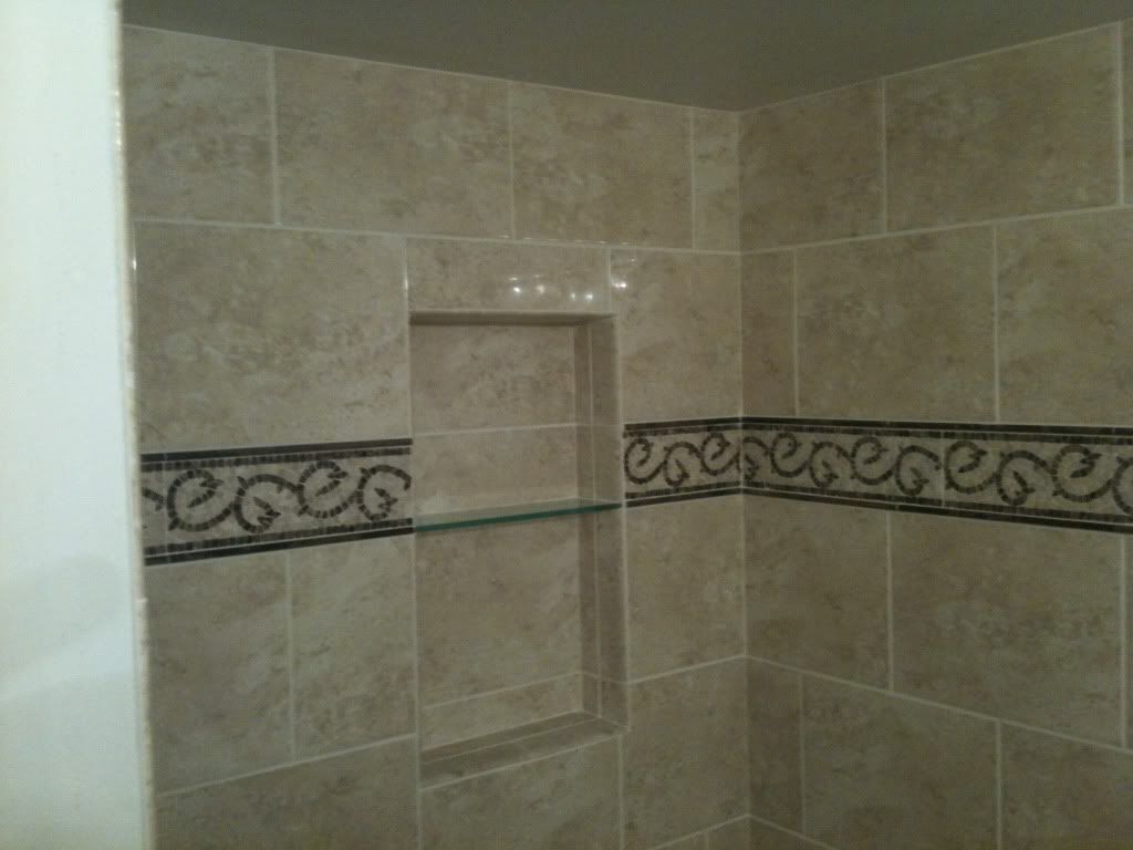

The project is coming a long and I am back home for a couple of week so will finish tapping and mudding the joints and hopefull can start tiling.
Two questions,
What should I do on the wall that have cement board near dry wall? Do I use drywall compound or motor on that joint?
Since I intend on painting the ceiling is there a motor that is sandable?
Thanks
Two questions,
Thanks
#32
727 - Tape and mud the joint where the tile and drywall meet using thinset and CBU tape. I position that joint to where the tile will overlap onto the drywall.
I've never tiled or put CBU on the shower ceiling. Drywall and paint have always been good enough for me. I do think that tile on hte ceiling is a nice touch.
We've had home inspector discussions on this board and there are a couple of inspectors that are members. I think the reviews are mixed with some support and some negatives. A lot seems to depend on where you live. Some areas require home inspectors to be licensed and credentialled where other areas have zero control.
