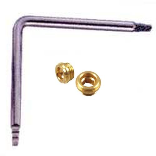

I'm not sure what a "seat" is....is that the flat washer on the bottom of the stem?
Read more: http://www.doityourself.com/forum/to...#ixzz2LkHgoMmW
No, a seat is what the rubber washer seals against. It screws into the body of the faucet. (Some very old faucets may have it molded into the body and it is non removable.) It is removed with a seat tool which is square on one end and hex on the other. The seat tool is either tapered or stepped to fit various size seats. Tapered is best for worn or odd interior sized seats. Most modern faucets have cartridges not rubber washers and seats.
