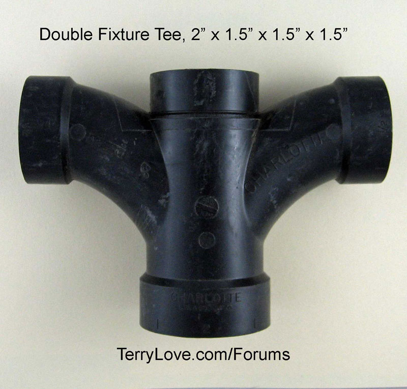

You know that may be the best you can do having no vent... That t or cross t needs to be specific type if that is the case.....
But typically dual traps are not allowed. They may have tried to pipe that as a dual vanity set up and after reading the code it may ba allowed, so I retract my previous statement....
The tee needs to be like this. It has a different bend. Its a double fixture fitting. Ask the plumber if this is whats there. Not a double sanitary tee.... ( Cant tell by your pics)
If so then the plumber did so correctly and I may take back what about him too....LOL
So this is what he had in mind but with a studor vent.

Mike had suggested you use only one trap and cap off the left side of the drain. You would use a double sink connector to connect them.

I gee.... I dont know what to say... You may have mis-understood all we were telling you...
You really need to remove that double tee and start over... That double tee is not allowed...
Easier to use a center or side waste... You still need to incorporate a studor vent... remeber...one trap only...
Center waste
Or side waste
Center waste
Or side waste
