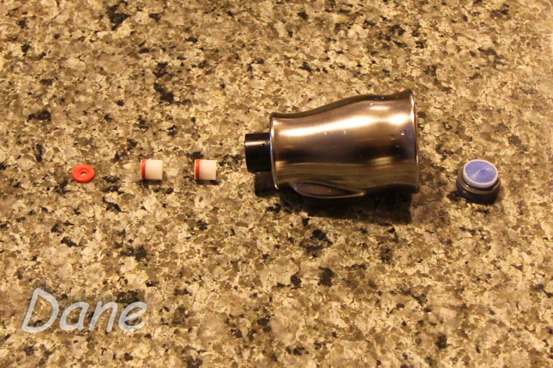

Any way to increase flow in Delta kitchen faucet 19939-DST?

I just purchased the Delta kitchen faucet 19939-DST as part of a kitchen remodeling and find that its flow is about half of the previous (20 yr. old) faucet. I made no other changes to the plumbing.
The specs say 1.8 gal. / min., but I tested filling a gallon jug and in a minute at full on it only fills the jug half-way. I've made this test several times with always the same result. So it appears to be more like a 0.9 flow / min., if that.
So I assume that there is some type of flow restriction that I need to remove. But I've unscrewed the screen and aerator (as much as I've been able to remove - so far) and see that there appears to be a black plastic baffle about half-way across the opening. Could this be doing it? Except if it is, then the circular sprayer flow that I can toggle between wouldn't be affected as it gets its flow farther up inside the nozzle/sprayer assembly.
I've also unscrewed the nozzle/sprayer assembly on the top end and don't see that there's any way to get farther inside of it. Is there a way to do this and then perhaps I could find and remove a flow restrictor?
Otherwise, the white plastic fitting that the nozzle/sprayer head unscrews from is quite small, which I measure at 3/16". So I almost think this is the culprit and maybe even if there is an actual flow restrictor inside somewhere the nozzle/spray head that this might have to be drilled out anyway.
The thing that's most bothersome though is that they rate it at twice the flow that I can actually get.
Maybe I just have to return it for another brand that functions up to its specs. Though I hate to because it looks great. Just wish it would flow better.

Pilot Dane - I took your advice, unscrewed the head, using only the hose (w/ the 3/16" opening) and tried the gallon jug test and it filled in 40 seconds. So calculating out, it appears that I can get a 1.5 gal./min. flow without the head.
I put the head back on and it took 60 sec. to fill the jug, which is of course 1.0 gal./min, a little more than half of what I expect.
(Sorry, below I said that the jug only filled half-way in 60 sec. It actually filled. What I meant to say was that I only got half of what I thought in 60 sec. Sorry for the confusion.)
Yes, I am on a well and the pressure dial appears to be 27-28.
I ran each test twice, while the well pump was not actively running.

All faucets sold in the USA have flow restrictors. It's not something the manufacturers want but it is government mandated just like there are only low flush toilets these days.
Mine took 24 seconds to flow two quarts of water with the aerator in place.
26 seconds with the aerator removed. I'm also on a well so I think the water pressure was lower but both times are close enough to think that the aerator is not the cause of restriction.
18 seconds with the sprayer head removed so yes there is definetely something in the spray head slowing the flow.
22 seconds with the red "restrictor" in the inlet of the sprayer head removed.
20-21 seconds with the first check valve removed from the spray head.
19+ seconds with the second check valve removed from spray head.
Once again Photobucket is having major problems. Hopefully soon there will be a photo of the parts removed from the spray head.

Pilot Dane, you've done it! Thanks so much for showing me that the flow restrictors can be removed from the top of the head. I didn't think they could, and then I reached in with a needle nosed pliers and pulled out the first aerator thing, then pulled out the orange restrictor with a bent paper clip and the same for the other one.
The flow rate is better, but still not great. By my calculations i can fill a gal. jug in 53 sec. which is 1.13 gal per minute. My previous rate was .9 gal. per min. so some improvement but I would have thought more after removing all that junk.
There's yet another piece below the 3 with a plastic valve-like thing that moves up and down, but I wasn't able to get it out. Also, since it moves, maybe it has some purpose other than restriction. If you manage to get that out and it helps your flow rate, please post it here and tell how you got it out.
Thanks again for showing how to get those pieces out.
I used a nut pick to get the restrictor and two check valves out. I stopped there as it looked like I was seeing the valve parts that switch the head from spray to stream. I don't think there is anything easy you can do to the head and still have the spray/stream valve function.
