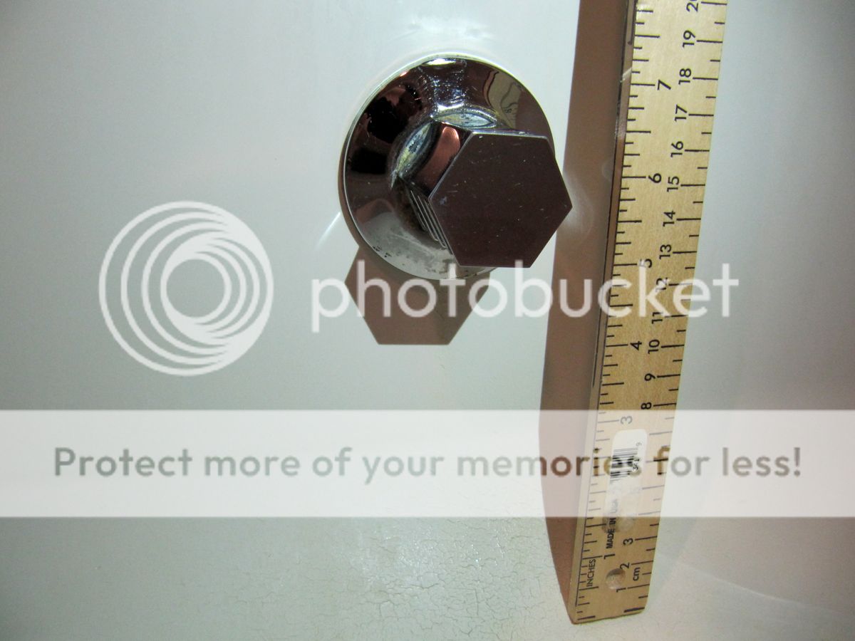

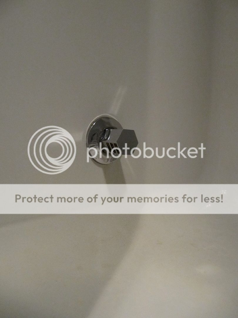

Here are a few pics. I do not own an instant read thermometer. My steam head is not 8" up....more like 5" -- perhaps that's the problem. The steam definitely hits the floor.
Here's the discoloration and pitting on the floor. It looks pretty bad in this closeup pic:

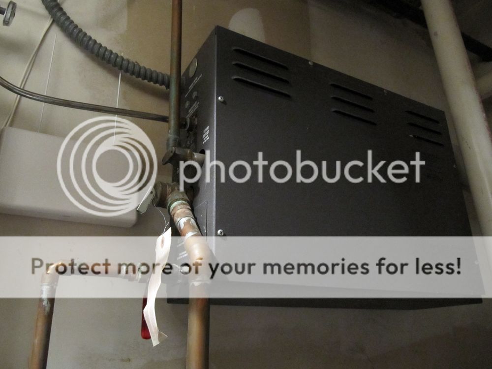

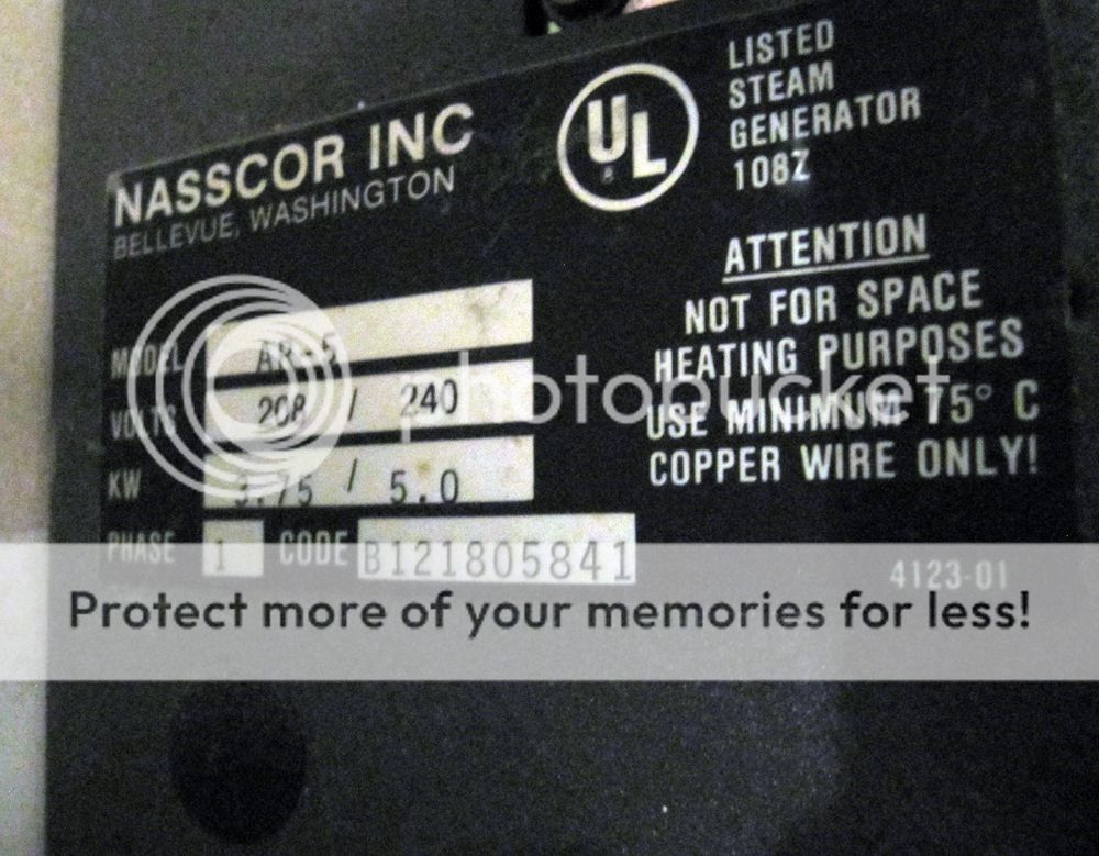

Here's a couple shots of the steam unit, which is located downstairs in a utility closet almost directly under the shower.

I have fiberglass resin (for car body work). Would that help to seal these cracks before they get worse? Or is there some sort of patch that I can epoxy onto the floor under the steam head?
I'm just thinking long term and proactive.
One other thought. Is it possible that what I'm seeing is actually mineral build up on top of the surface? It does feel very rough, but it's hard to tell if it's a new layer or actual damage of the existing surface. Should I try some vinegar and baking soda??
First, do you have an automatic drain on your steam generator? It appears yours is manually operated. After each steam use you should open the drain valve (red handle) and drain all the water out of the steam unit, then close the valve. Every time you use the steam generator it boils off water leaving the minerals behind and it has a very small tank with a huge heating element so it can't tolerate much mineral buildup.
I can believe your shower is having trouble. The steam coming out of the nozzle is superheated and generally the emitter is mounted higher off the floor except when installed in a tub. I'm betting the sudden blast of steam rapidly expands the surface of the tub eventually causing little bits to flake off. I'm also betting you get your toes cooked if you are not careful.
10 years ago deflectors were commonly available and reasonably priced but they have become much more difficult to find, especially after the 2008 big economic meltdown. Manufacturers also changed the design of the emitter heads so a deflector is not needed as much and some new head's shapes makes it almost impossible to hang a diffuser.
I make my own steam deflectors. I take a strip of polycarbonate (Lexan) about 4-6" wide and a 8-12" long. I drill a big hole in one end to fit over the steam emitter head. Then I bend the other end of up into a "U" shape. After bending I drill a couple 1" holes in the bottom of the U to let a bit of the steam go straight down. Acrylic bends easier but cracks and breaks sooner because of the heat. Polycarbonate requires more muscle to bend but I can get almost two years out of a deflector before I need to make another.
So you're saying this thing needs to be purged after each use? That seems like a real PITA and I'm willing to bet the prior owners never touched this thing. In fact the utility closet was a mess when we bought this place and I've slowly been making repairs to various things over the last six months.

Pilot Dane - Thanks. Sure enough I located a user manual online for my unit and it recommends manually draining at least once per month. Per the instructions I switched on the steam and then opened the drain valve. The manual says to keep the valve open for only 10 minutes. Only a small amount of water actually drained out....maybe a cup or so. Do you know if that's normal?
Link to Nasscor/Amerec AR5 manual: http://www.amerec.com/Files.aspx?f_id=41773

If you purchase an auto drain valve (about $250) it will drain it after every use. I'm on a well with pretty hard water so I drain mine after every use. Once, before having a softener I went a month without draining and the drain plugged with minerals and I had to remove the valve and poke around with a wire to break up the deposits and get it draining again.
You should get more like 1/2 to 1 gallon of water when draining the unit. One thing you can try is to open the drain valve and turn on the steam generator. The heating element should not come on unless the tank is full but it will open the inlet valve which will generate some pressure and water flow to help flush out debris.

Hmmmm. I did turn on the steam unit earlier when the small amount of water drained. I noticed that steam DID generate even though the manual states exactly what you did (that the heating element should not come on).
I'm in Chicago. Our water isn't hard, but it's not soft either and we do not have a softener so I'm wondering if my drain is clogged. I will try draining it a few more times and see what happens. Perhaps it will unclog itself. I'm telling you, the prior owners were NOT on top of this stuff. My guess is this drain has not been opened in YEARS until today.

For the next several weeks I'd get in the habit of opening the drain valve right after you are finished using the steam. Maybe the hot, freshly aggitated water will help flush out any sediment.

I've tried draining the steam machine after a few steam showers and I only get a very small amount of water draining from the valve after a steam shower. I got considerably more drainage when I tried purging it with the steam shower turned on from a cold start.

I also tried baking soda and vinigar and light scrubbing on the floor under the steam head and that did nothing. It seems like the gel coat is worn under the steam head, so I ordered some epoxy filler for the hairline cracks. We'll see if that does anything for the floor.

My generator sounds like a small jet engine when operating and you literally can not see your hand in front of your face in the shower. And, I love how even sounds become muted when the steam is so thick. A few drops of eucalyptus oil an nothing is better for a cold or hard day at work.
The deflectors I've made out of Lexan all start cracking in months and I'm lucky to get a couple years before the fall completely apart. I think the blast of intense steam is an incredible thermal shock to any material. Your emitter is so low that a deflector might look silly but putting a inexpensive mat under the emitter might work. Let the mat take the abuse and replace as needed.
I had a similar thought although I was thinking of permanently installing a patch. Figured I'd epoxy the cracks, try to repaint that area (with a gel coat repair kit) and then cover it with something. That something I've been unable to figure out. Any ideas for something white or off white that won't look ridiculous in that space?
