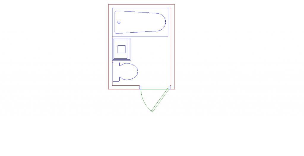

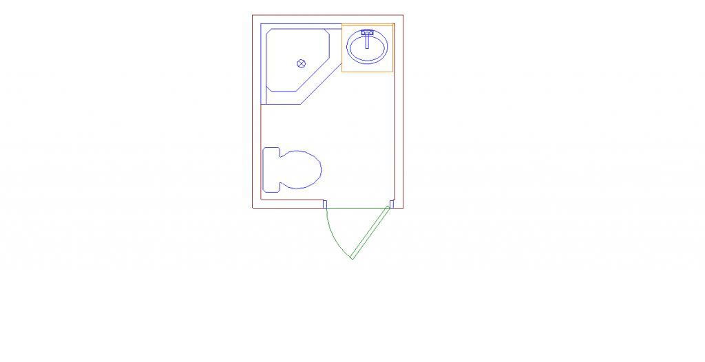

So, I assume you've located a toilet with the waste line exiting from the rear. I also assume it means your toilet must have it's back up to the wall on the left.
Here are a couple layouts. Both use a 32" door.
This one shows a 38" neo angle shower and a 24" vanity. It would probably work best with a shallower 19" depth cabinet (I think the drawing shows a 22" depth).
Here is one with a 60" tub and a pedestal sink.

Yes, you are correct. The toilet system ejects from the back through the wall.
I'd love to do the second setup but I don't think that code will allow for the very little space between the tub, vanity and toilet.
I had the codes somewhere but I can not find them. I am in Ma if you have any idea what the codes are here.
