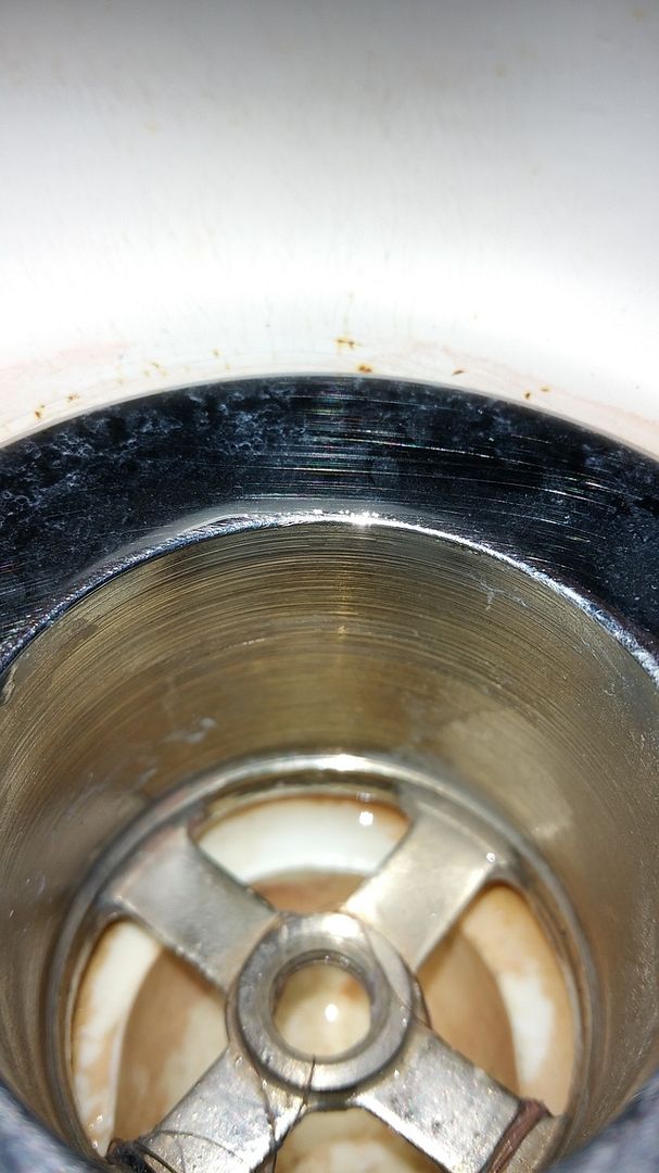

So i hadnt noticed this before but a few months back I teplaced the drain in our tub with a new one. I used plumber putty around the tub and drain contact to get it sealed. Slowly a brown area began in my celing and it appears right along the seperation is starting to get divided. First things first I assume i need to fix this offset. Any ideas is there some extenstion I can get to make up the seperatio or what else could i do when i stick my finger down the tip of my finger can fit in the gap. Can I fix this without cutting up the ceiling at all hopefully this would fix it and them the drywall could dry up and just get another coat of paint?
Looking down new drain
The ceiling
Thank you!

The pvc part of your drain is odd. Normally the metal drain piece is screwed into a flanged receiver. Yours appears to have a sink type flange. Can you clarify that for us? You may be removing part of the ceiling anyway if your drain is not properly set.

Im sorry, I dont know how to answer your question. I bought the house in April I just took the old drain off because the cross section that the stopper goes into had rusted apart. I was hoping there is maybe some sleeve or something i could put in to remove the gap. Everything seemed to go fine until I had replaced this drain peice. Im wondering if i cause the pvc part to get misaligned.
What could I do to provide more clarification?
Thanks for the feedback
Old 11-22-15, 02:28 AM
chandler's Avatar
Join Date: Dec 2005
Posts: 39,967
Likes Received: 1
As much as I hate to suggest it, but a picture of the drain with the chrome piece removed would help clear things up a little. Hopefully the drain piece is not cross threaded.

So I took the drain off, and took lots of pics. My assumption was there was nothing between the shoe and the drain I see now it was "threaded" into the shoe. I snaked the drain (threw up a little), put a 2nd rubber gasket in then another generous plumbers putty ring. This time I made sure to put all my effort into how tight the drain is. I am wondering if I had it this tight before, the "gap" where I would fit my fingernail before seems smaller.
I also moved the shoe and snapped a few pics to see if that helps at all. I also noticed after a shower that if I stepped on a tile up against the tub there was water "seeping" up the grout. It is all but certain I will need to eventually replace the flooring and do some work on the ceiling, the flooring was on my to do list anyway in a year or so, I have some plans to redo the whole thing. I may be crazy but thinking about removing the w/d and making it into 2 bathroom (more on that later). So anyway here are the pics.
Tomorrow I will be putting some standing water in the tub and draining it and monitoring the ceiling. I notice the ceiling does not drip from showers but if there is some standing water or what not that when I notice there is drips coming on the ceiling.

OK, false alarm. What I was seeing was the baffle below, thinking it was a different type fitting. With the drain partially installed, can you pull the drain tight up against the tub? It is odd that you would picture tile with broken grout. This can be a problem area if the tile were not laid properly and splash out water is leaking past everything. I have seen tile laid directly on plywood where the grout is cracking and water pours past it, because there is nothing to stop it. Get out of the shower dripping and all the water goes through the floor to the ceiling below.

Not sure if I gave a good description of the cracked tile pic. It was fine one second and then when i step on it or put my weight on it i noticed water coming up from the floor if that makes sense?.
I wont begin to fantasize that the people that originally built this place cared about what they were doing, so you may be right that its just laid on top of the wood. we got a fairly good deal on the place and I knew going into it that some work would be needed but nothing at tuis time makes the house unlivable. I am motivated to DIY what I can, and i did plan to eventually replace this floor if not completely redo the bathroom but that was something 1-2 years down the line.
Im sorry I dont understand what you mean by "pull the drain tight up against the tub". I used pliers on the cross section while screwing it back in and this time i was also "lifting" the drain while screwing it in as it got tight i took a screw driver to add leverage and keep turning. I completely reinstalled the drain did you wante to undo it again to complete what you were asking?
As mentioned previously we will keep monitoring the tile and ceiling after showers and in a day or so we will also put the stopper in to test the drainage if it comes out on the ceiling or not.
Thanks so much to everyone sticking with me on this and helping me out! Cant wait to say its 100% fixed!

If you are able to install the drain to where it is tight against the rubber washer and tub bottom as well as using plumber's putty on top between the flange of the drain and tub, you should be just fine. If you are seeing water in the tiles, I doubt it is coming from the drain area. It could be splash out that soaks in too fast and never dries up. Properly installed underlayment and tile will provide a better condition. Are you finding this anomaly just at the edge of the tub area? Do you have shower doors or curtain?

The threads on the drain piece appear to be tapered in the picture. If true, could be the drain threads get tight before pulling the drain pipe and gasket against the bottom of the tub.
I also have installed fiberglass tub that leaked at the drain because the tub's bottom surface around the drain hole was so uneven the rubber gasket still leaked when the drain was tight. The solution was to bondo a donut around the drain hole (to match the rubber seal ring) and finish it flat and smooth. This would require removing the ceiling below the drain. Hope this helps.

I'm getting in late. Here's a couple of things I notice:
- When you removed the tub drain to take pictures, I don't see much putty remaining on the underside of drain flange or on the tub.
- You moved the drain shoe out of the way to take pictures. This to me indicates slip tube fittings inside the walls. If this is true, than the pipes were disturbed and might be leaking.
To fix this, I recommend you gain access to the fittings. Either access through the wall behind shower or through the ceiling below. Either can be fixed, back wall is easier if you can get to it.
Clean the drain flange and the tub surface.
Apply a generous bead of putty to underside of flange.
Apply Teflon paste to the drain male threads.
Loosen shoe (if slip tube), align drain shoe hole with tub hole and tighten drain from above.
Reconnect/tighten fittings where drain shoe connects to drain tee. Put Teflon paste on the compression rings of any slip tube fittings inside walls.
This should be an easy fix, but I would want to see everything and fix this right the first time.

Ok Ill be doing the test in a few days been out of town. When i put the drain beck on i put a large amount of the putty in between the drain and the tub of course as I tightened it, the putty came out from under the drain die to compression. Im hoping the ossue was that I just did a poor job installing the drain the first time and did not screw it down as hard as I could.

Ok so i gilled the tub up with a couple inches of water and let it drain, this time there was no report of dripping from the ceiling. Before I feel like in out of the woods i may fill the tub up completely and see what happens.
Next "oddity" while draining just from the tub I saw almost no moisture seeping up through the grout. Confusing indeed!
