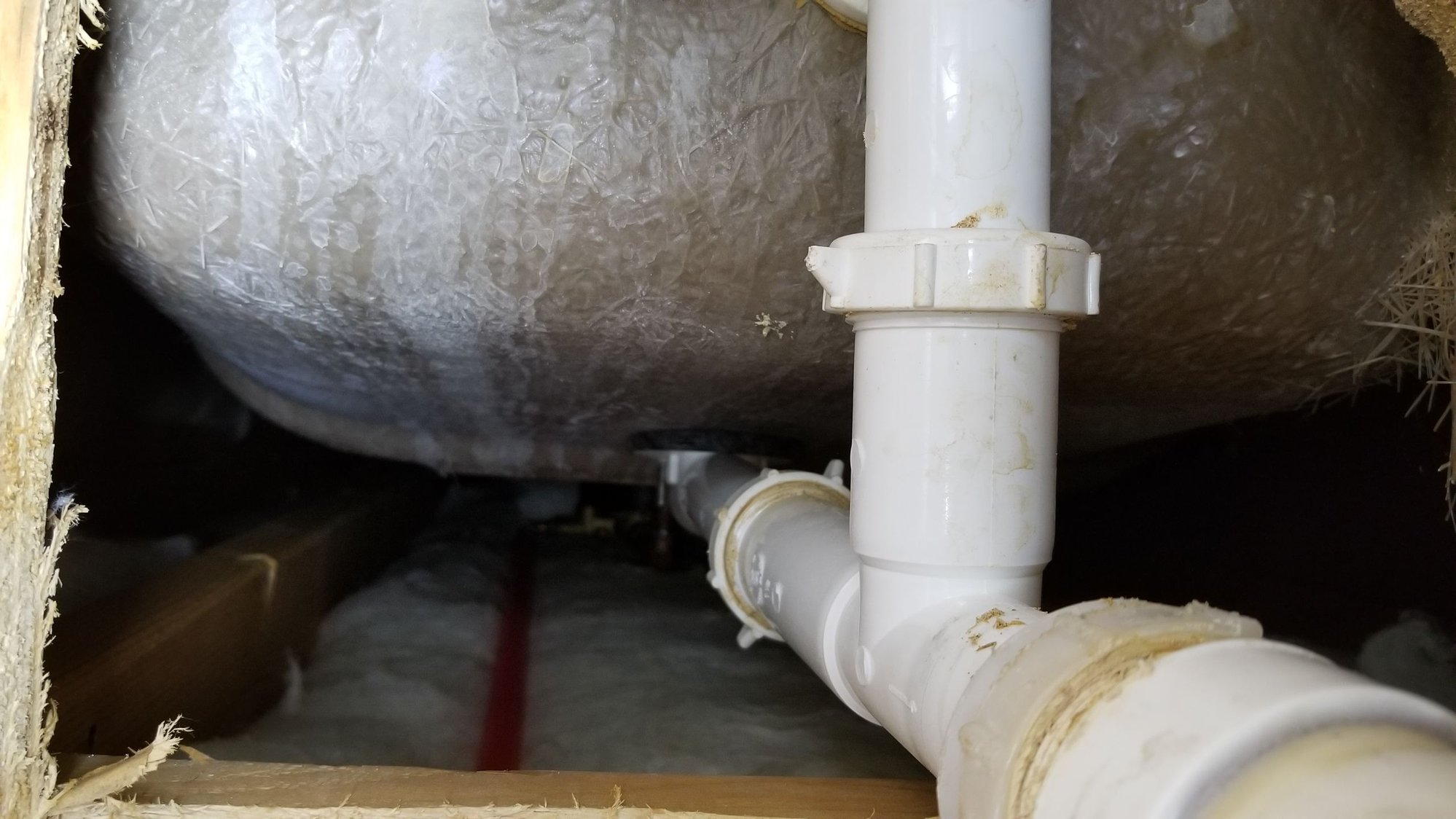

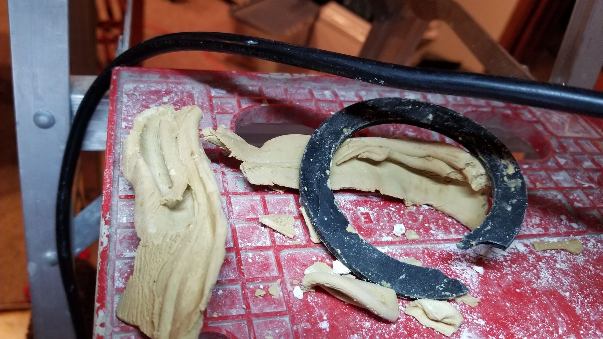

Thanks for the reply. Below are some pics and I hope the helps. Best I can do at this point unless i tear into the walls. Does this help?
This was some plumbers putty i believe and what looks like a ring for sealing something but was sitting on the sheetrock when I opened up the ceiling

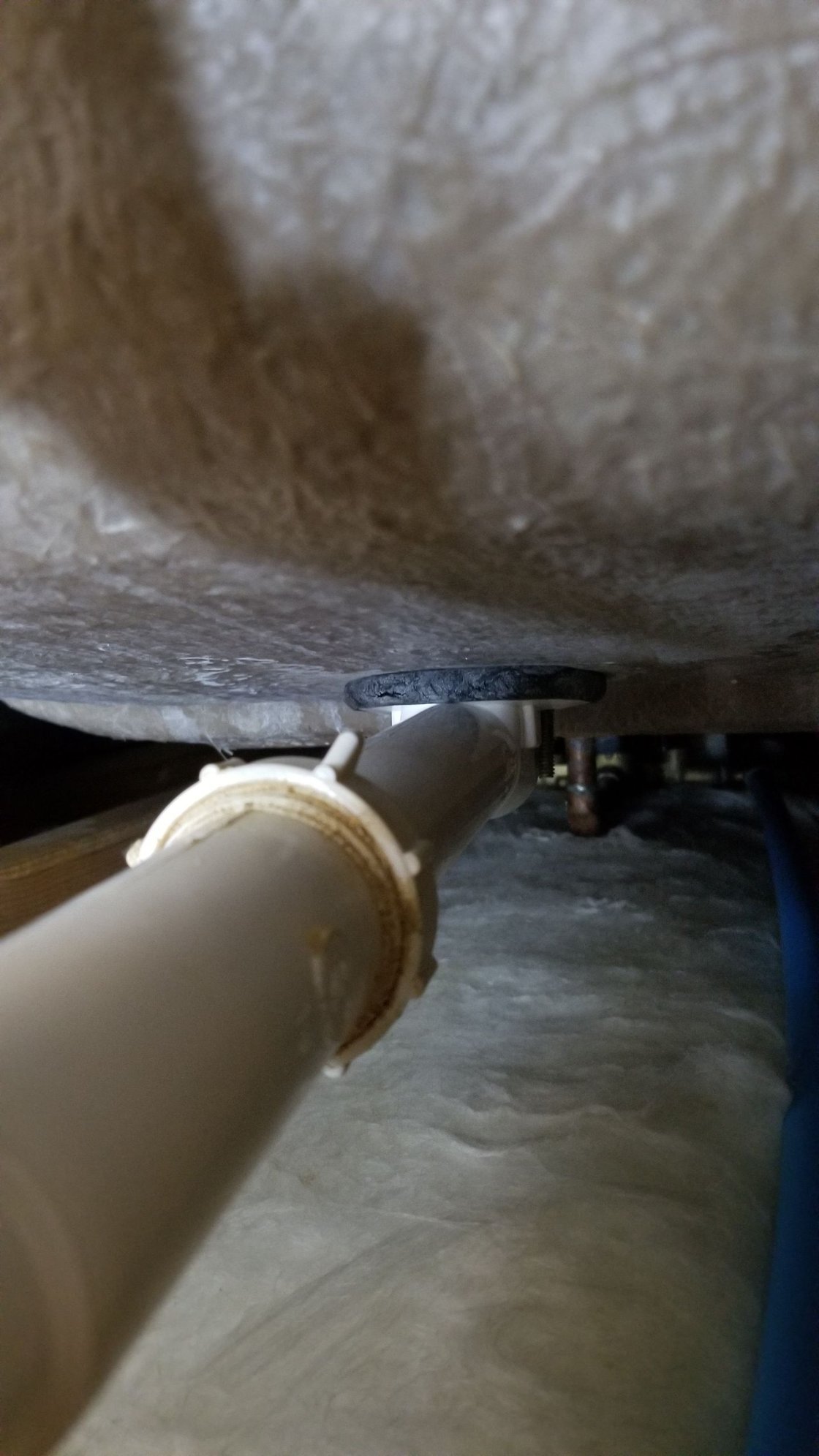

One shot of trying to look up at the problem from the basement. the water will drip down but most seems like it runs along side the tub

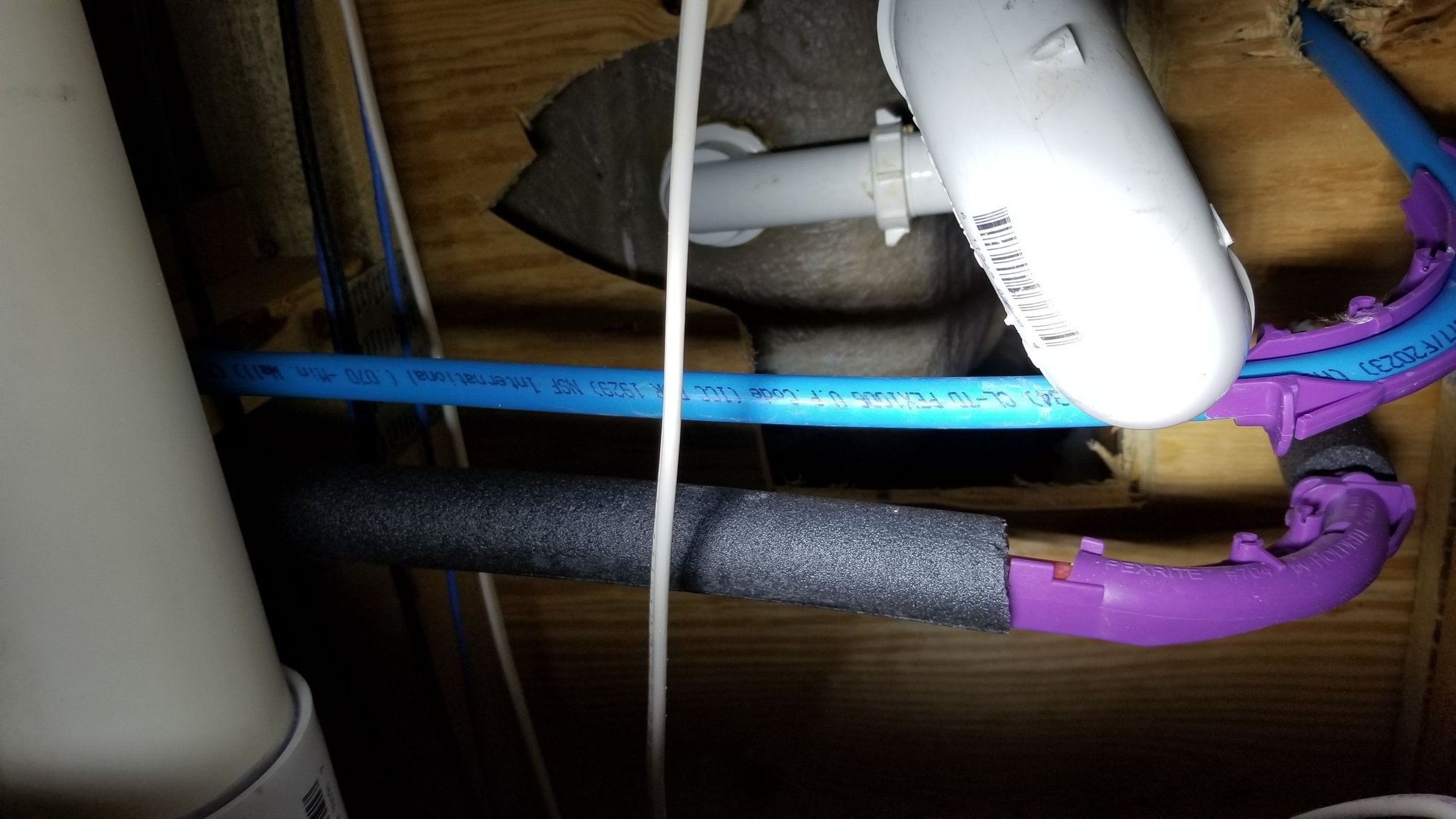

Another shot trying to reach up as far as I could to look at the valve and shower pipe

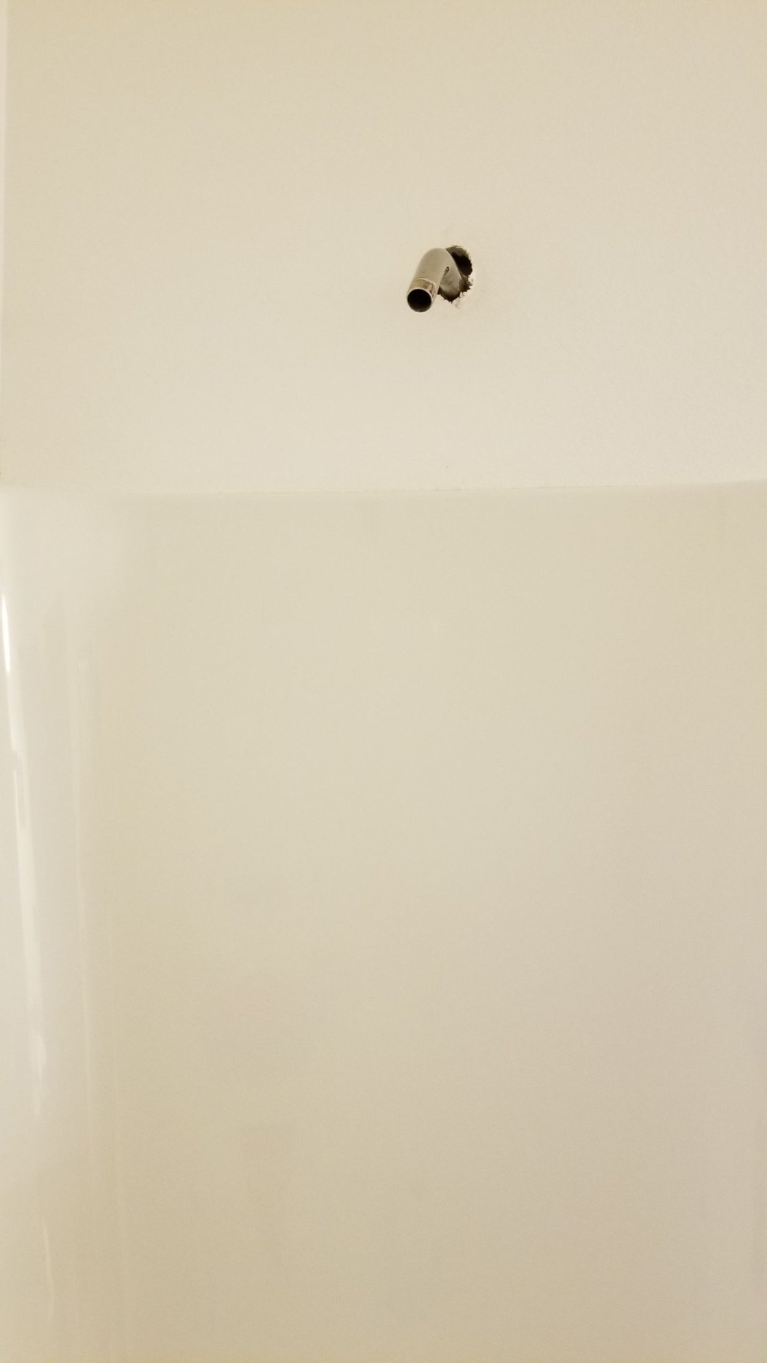

shower head

shower head

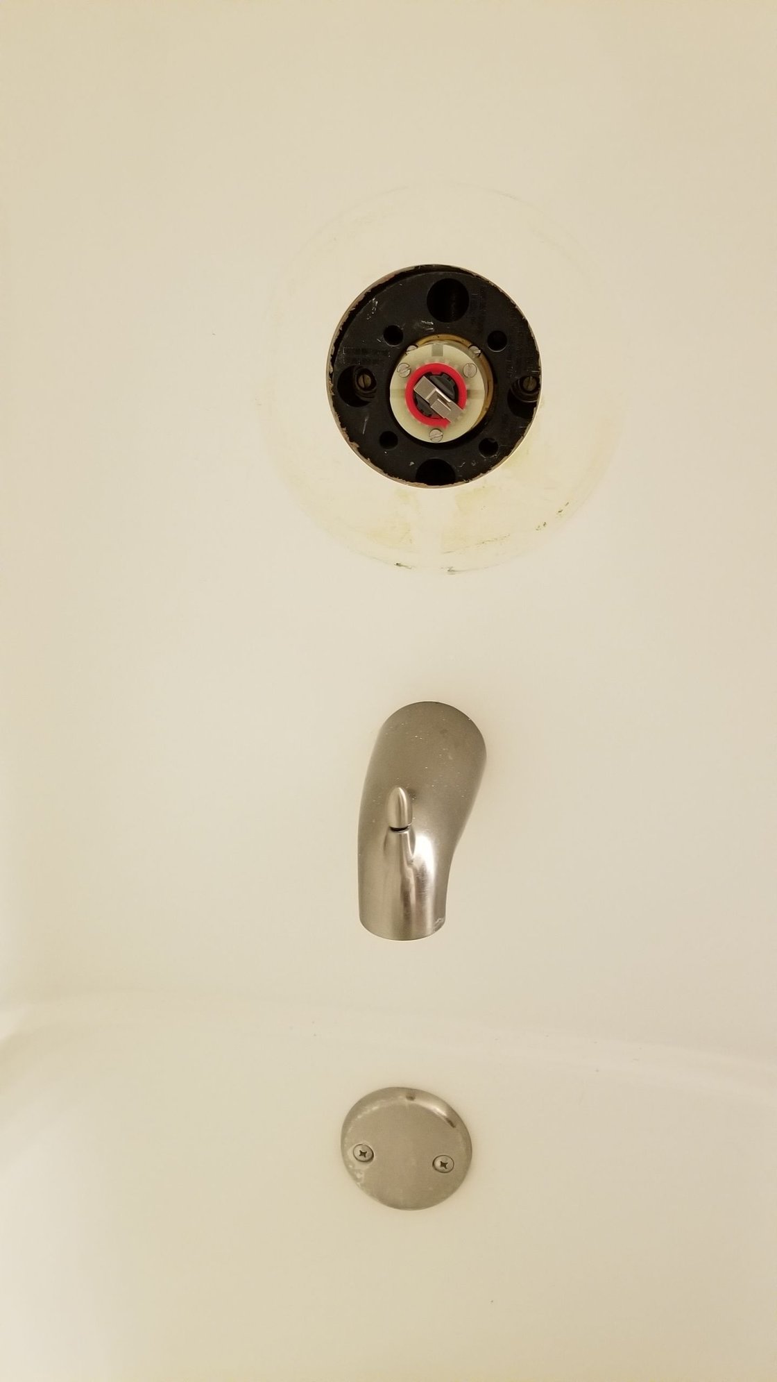

It leaks when i pull the lever to turn the valve from filling the tub to using the shower. Once i do that the water starts to leak into the basement. I it is a larger amount too it isn't just a few drips. I can't tell though if that is coming from the valve or up higher. I believe up higher as I have tried to move the black spacer piece around that sits between the tub and the valve and shined a light in there but I don't see the water coming from that.

The valve splits the green backspalsh and the vertical part of the counter top unfortunately . Yes the hot and cold are coming from the basement and look to be accessible. See below
hot and cold lines from basement hole

Remove the black plaster ring, turn the water on and activate the shower. Then you will be able to see if its leaking around or above the valve.
The plaster ring is there to help with rough in, so that the plumbing gets set at the correct depth. It is generally not needed after that.
I do not think that it is absolutely essential. Though it may help stabilize the valve if it is not installed securely.

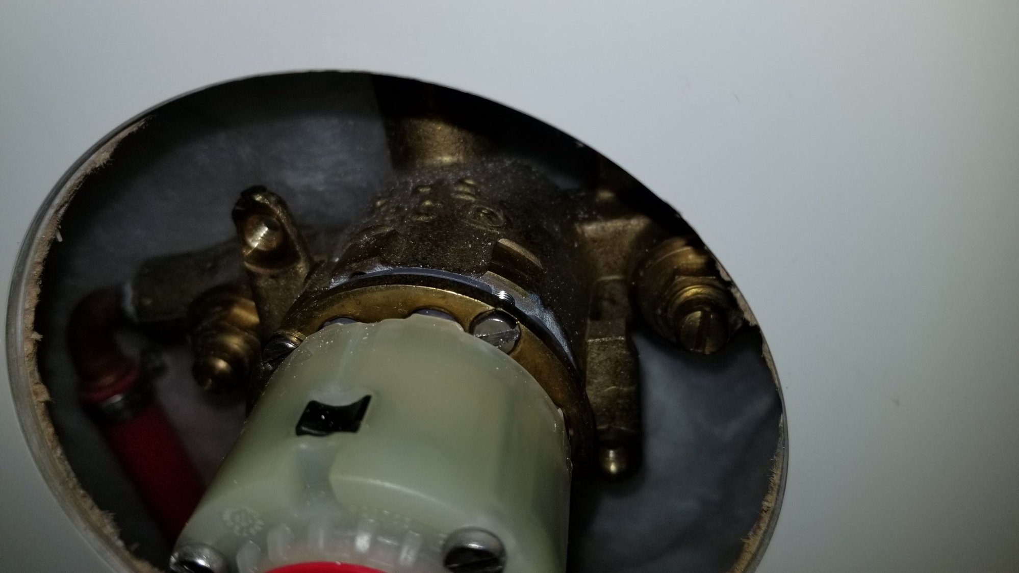

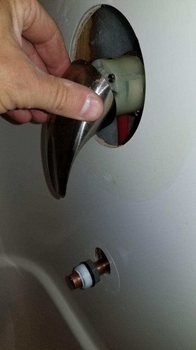

I really appreciate the help from everyone. I did cut that black thing out and am going to go and try this all again. Also, I am taking off the tub spigot and going to simulate the shower mechanism. However now there is a ton of play in the unit after removing that black piece. how do you secure this again if i get it fixed?
Join Date: Jul 2009
Location: US
Posts: 240
Received 0 Upvotes

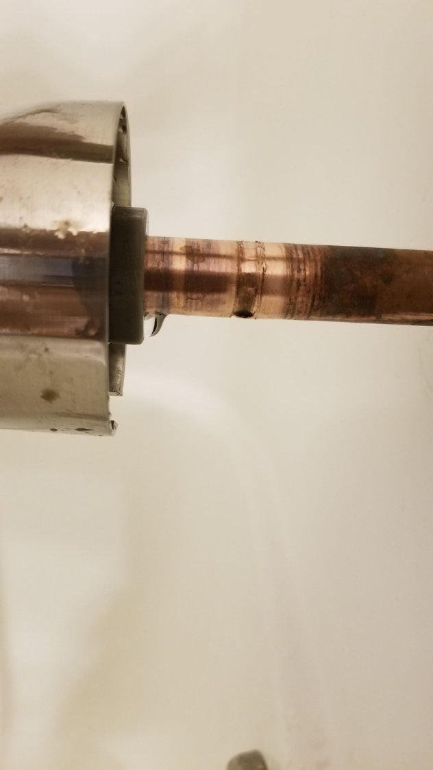

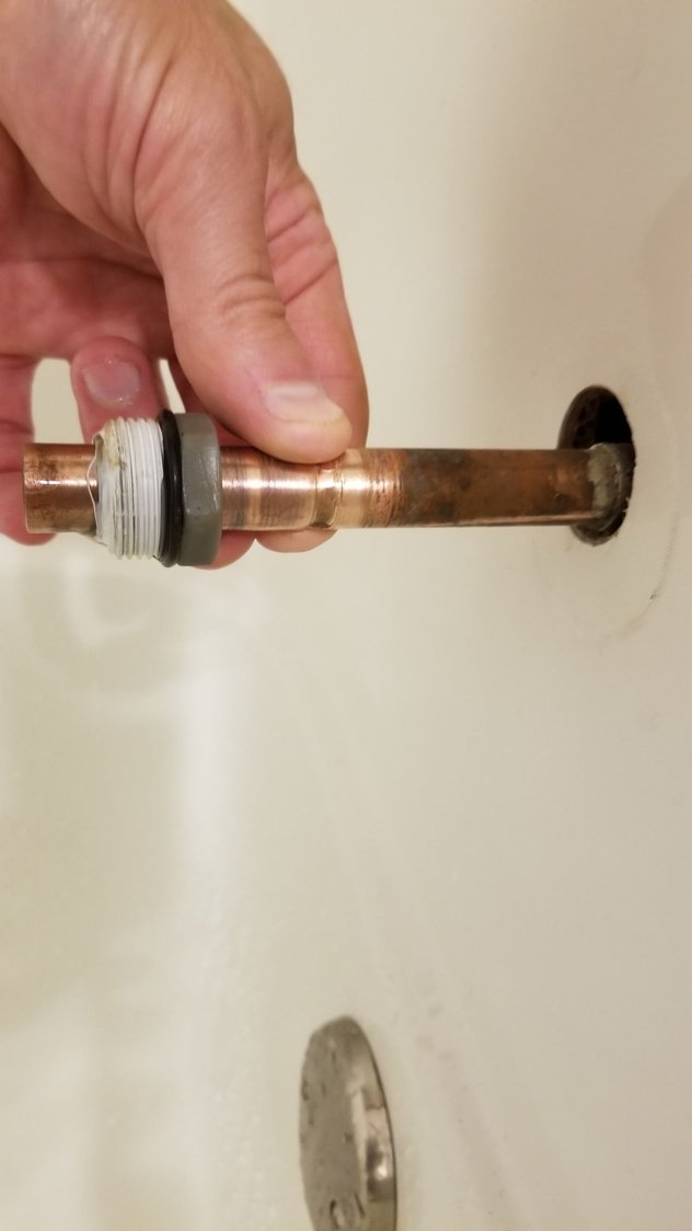

Good news and bad. Good I think the issue is solely with the tub spigot. I noticed this after I was able to get some play by removing that black thing suggested by xsleeper.
Bad news maybe or where i need some pointers.
Here you can see the full length of the pipe
notice the drip. this is with the tub on. it is much worse with the tub on but not nearly as bad as with the original.
my fingers are noting the large dents

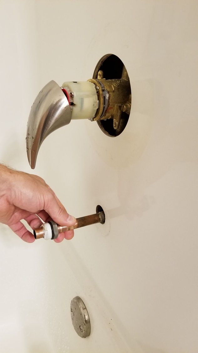

I bought a new spigot but you can see below that it is still dripping with the tub running. When i turn the shower on it is exaggerated. . Not as bad as the one i removed but still leaks. You can see in the one image that there is some dents on the pipe so I can't push that plastic fitting very far on to the copper pipe. I kept it away from it only pushing it on an inch or so as you can see but still leaks. One thought I had was i could attempt to solder a threaded end on this that the spigot would twist directly on to. what do you think? If this idea is sound, the spacing is pretty fixed so how do you get it so that the handle and spigot are in alignment?
Next there is a ton of play now without that black spacer. Is that going to affect the unit moving in and out once I get the spigot figured out?
There are many sloppy plumbers installing this equipment without properly fastening it.
There should be wood blocking behind the vale that the valve gets attached to.
There should be wood blocking behind the tub spout line too.
It looks like the lower kitchen cabinet could be removed for access into the wall.
There wouldn't be much holding that base cabinet in place.
Definitely looks like the spout is leaking. Probably filling up with water and it's running back into the wall. If you were to block off the tub spout line.... holding finger over the pipe... the shower should work and there should be no leak.
I've never seen the copper pipe get so worn like that. That must have been where the setscrew was and the spout was being turned. May possibly need to cut pipe and couple in a new piece of pipe. Would require FAST work as you wouldn't want to loosen the pipe in the wall.
Another possible solution is to use the Delta style spout where is solders onto the end of the pipe.
