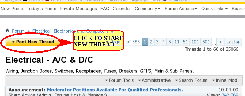

Monte Killian asked:
You use the Post New Thread button in th upper left of the page listing threads in the forum relevant to your question.
Can you tell me how do I ask a question on flooring?
