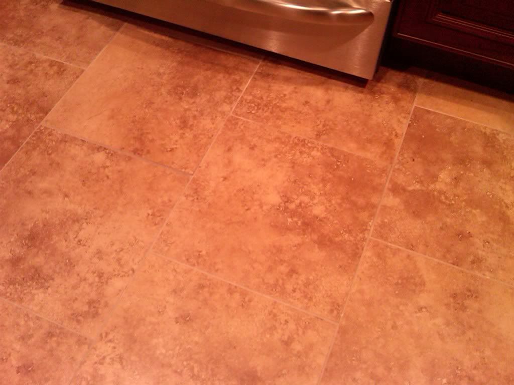

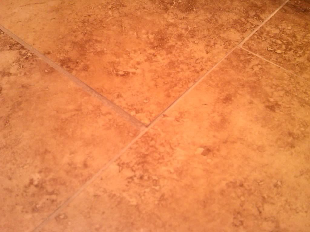

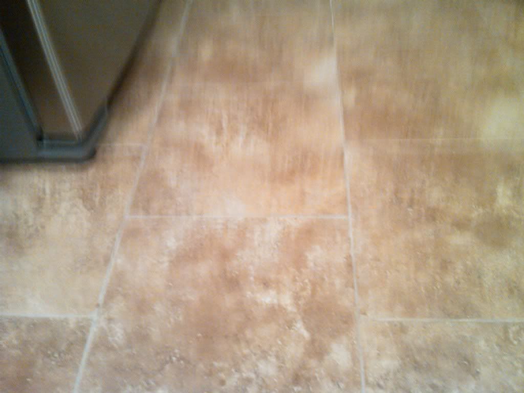

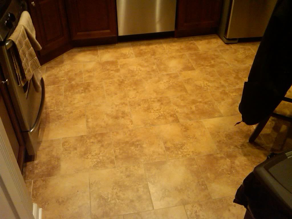

Hey Guys, sorry it took so long to get the pictures updated.
Below is finished floor
Highspot by fridge. sorry blurry
High Spot by stove3
Close up
As you can see the tiles are up a little... Wish I could do something..
If you need more pics let me know

Leave it alone or just rip up the high ones and reset them
At least from the pictures, this looks pretty good to me

I agree with Mitch, since it it only in front of the stove, leave it or replace it. Don't do a wholesale rip out, however. The job looks good.
PS, the one I mentioned in my earlier post is almost exactly the same. It's staying....I decided and I haven't been vetoed, yet.
