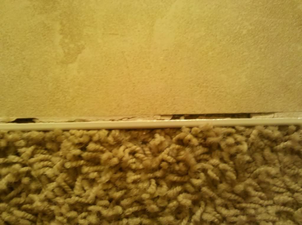

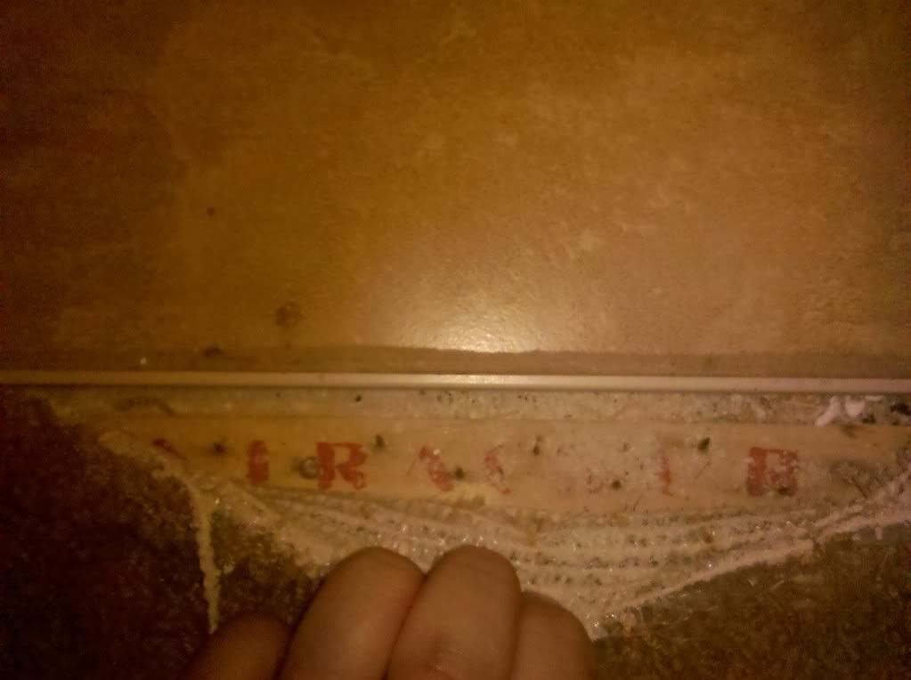

I have a lot of carpet to tile transistions in my home. The space between the tile and the trim piece looks horrible because it has lost most of the grout and in some places I doubt that it had it in the first place. I think there are trim pieces that slope down to lower areas like carpet, and that is not the kind that was used. We have to watch where we step because it hurts to step there with bare feet. The tack strip for the carpet is installed 5/16" away from the trim piece. It just seems like there is a big gap and that is one of the reasons that it is uncomfortable to walk on. There are also a few nails sticking out in some places.

The first picture shows the tile meeting the trim piece without any grout missing, and how the tack strip has nails pointed upward.
The second picture shows what the carpet looks like along the tile. You can see a gap and it looks really bad. You can also see that the trim piece was installed a lot closer to the tile than in the first picture.
The third picture shows how the grout between the tile and the trim has been breaking away.

I'm not a carpet installer, but it looks as if the carpet could have been doubled at the selveged end for a thicker transition and the tack strip pulled back a little. I am assuming the carpet was done after the tile, but that doesn't explain the grout between the tile and the strip. There should be no grout in that line. If anything it needs an expandable colored caulking to prevent cracking if the tile was done second.

As to the trim piece for the tile, they come in different sizes. The correct size for your tile is a trim piece of which the top of the trim would be slightly lower than the tile itself. In your pictures, the trim piece looks slightly higher instead of lower. I have used similar trim pieces to the one you have their from a company name Schluter. Their instructions say to grout the joint between the tile and the trim piece. I have always used a matching sanded caulk instead but I'm sure the grout if installed correctly would hold up as well.
I'm not a carpet guy either, but typically I've seen the tack strip installed about 1/4" from the trim piece. You said that the tile was installed on "concrete backer board" over plywood. The picture where you can see the tack strip looks like it has oriented strand board (osb) under the tack strip. Was the osb used as an underlayment to raise the height of the carpet to transition better with the tile?

I don't think anything was used to raise the level of the carpet to better meet the tile. I cleaned all of the gunk out of the first picture and it is just on plywood. The carpet is much lower than the tile. In the first picture the grout has not cracked between the tile and trim piece and still looks really good. It has a much wider grout line than the other two pictures. And the trim piece is definetely higher than the tile.
If thats the case, that row of tile needs to be removed, along with the trim piece. The correct height trim piece should be installed, then the row of tile gets reinstalled. If the trim piece is too high, every time you step on that joint you are moving the trim piece and thus the grout is cracking. I'm not sure who the manufacturer of the trim your guy used is, but heres a link to the trim I use. It has good instructions on sizing and installation.

So what is the best way to go about fixing this? Can I put in carpet shims to raise the level of the carpet?
I'm not a carpet guy, but yes the carpet needs to be ramped up so that its at the right height where it meets the trim. See link below.
