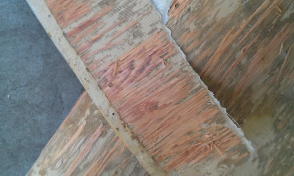

Tore up vinyl to prep for tile. a layer of sub came with it. question with pics
I tore up two layers of vinyl and some of the subfloor came with it. Take a look......question below.
this is the floor
this is what stuck to the back of the vinyl...
To prep for tile do I
A. put a layer of luann down over this (after I scrape it down a little better) and then do hardi after that? or
B. just put down a decent layer of thinset on it and put the hardi down on that?

B................................................................

thank you sir! thats easier for me!
