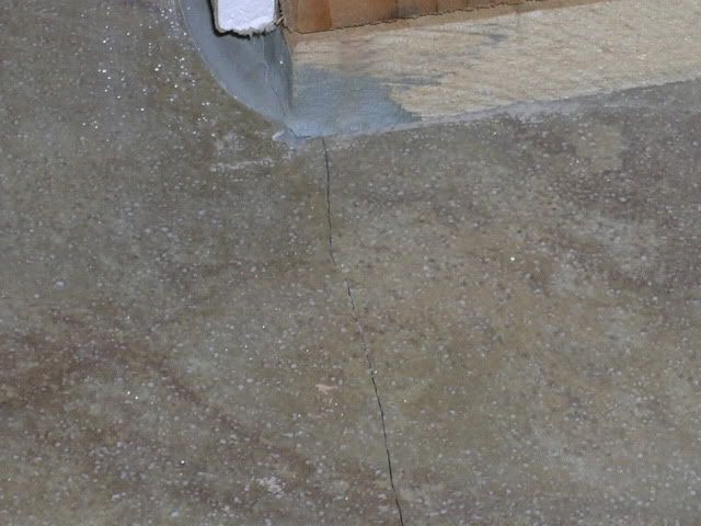

this is addition. framed with boise cascade wood I joists as per plans done by 84 lumber using boise cascade software. not sure deflection? subfloor is 3/4" Advantech T&G with adhesive/nails used to attach to joists. used 1/4" hardibacker attached to subfloor using thin-set and hardibacker screws as per their specs. tape/thin set used over seams. home depot more expensive thin set used to set the tiles(suppossed to allow some flex), the cheaper stuff (but still the polymer kind) used to attach hardibacker. this is upstairs in master bath and laundry room.
laundry-12x12 tiles that i did. used 1/4" notch trowel. the washing machine is on left and dryer on right. right between them running front to back the grout has separated from the tile. the separation is on one side of the grout line and then crosses over the grout to the adjacent tile. no cracked tiles noted.

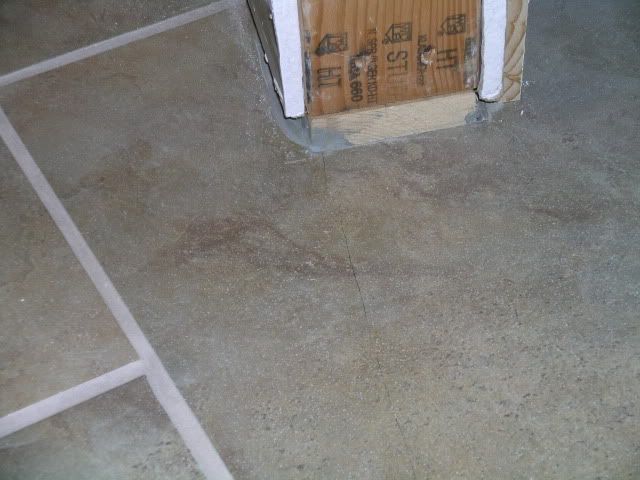

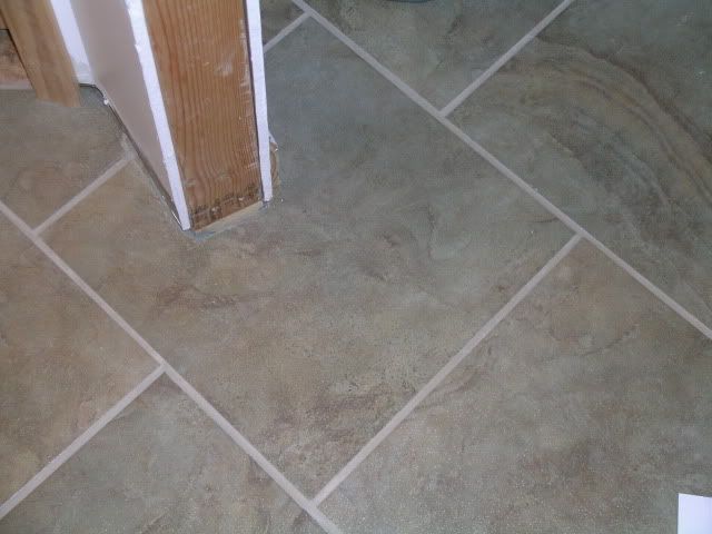

bath-18x18 tiles that someone else did. 1/2" notch trowel. there is a tile that has crack in it and then crack continues in the grout. this is definitely a tile that you would worry about cracking because it is in doorway that is at 45 degree angle to direction of tiles so tile is cut wierd and has what I would call a weak point susceptable to cracking and that is right where it cracked. note that to the best of my knowledge, I would say that this is probably about mid span (an 18' span of the wood I joists).
any thoughts? the crack is hardly noticeable. wife has not even seen it yet. really don't feel like doing anything right now till see how it progresses. and is there anything I can do to prevent further damage? What should I have done differently? the guy that did bathroom said he has never had a tile crack before and I do believe him. maybe the framing has too much deflection? may try to contact boise cascade and see what the deflection limits of my design are.

As to the larger tile in the bathroom, is it just the one tile that has cracked? Look closely, do you see any hairline cracks in the grout anywhere else? Tap the tile with a broomstick. Do any of the tiles sound hollow? Are you saying the tile that cracked has an L cut out of it and that it has cracked from the corner of the L outward? If you lay a straight edge over the cracked tile did one side sink, or are both sides on the same plane? Are you sure the tile wasn't cracked when installed and you didnt notice it right away?

yes, definitely 16" OC. I have the plans, I did all the electric, and I have been my own GC since the house was framed. floor does not seem bouncy to me at all.
I have some pics of cracked tile in bathroom. the crack continues to grout line, then follows grout and on far side of that tile grout also cracked. perfectly flat when lay straight edge across crack. I doubt it was cracked when layed. I usually spot things like this right away.
