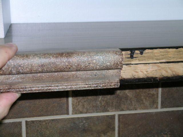

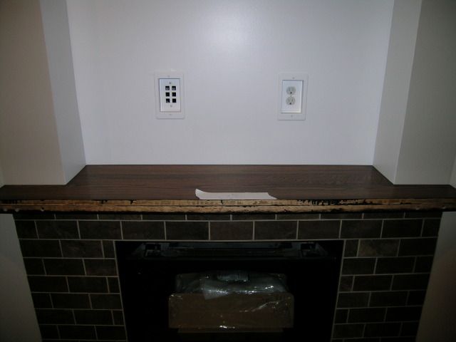

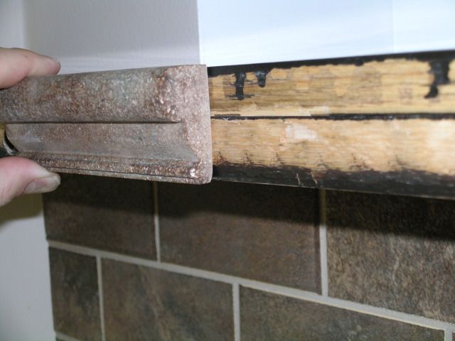

I built a custom fireplace mantle. It is made of two layers of red oak. the first, or bottom layer is the structural layer. it is screwed down into a 2x6 that runs horizontally. it is about 1" thick and in the two "wings" on the sides I drilled holes in the edge and put 6" long screws horizontally through mantle into the framing behind. then the second layer sits on top. it is secured with short screws that go into holes in the edge of first layer and up into second layer. I may put some 23 gauge nails with my pin nailer in the back. the front and side edge I intend to put a decorative tile. I tiled the front of fireplace and used thinset. but I was thinking that mastic would be better in this application. since the two layers are only about 2" total thickness, there isn't much space for the tile to bite and if there is any shifting between the layers, such as expansion from heat of fireplace, I was worried that the tile would loosen up. since this is completely dry, would mastic be better? isn't it more flexible?

Can I ask why you want tile facing this pretty oak? Would not an oak 1x band a little wider than the mantel with the excess sticking below the mantel be appropriate. I know it is all in taste, but you know how I like wood. How do you plan on attaching the tile? Directly to the wood? Don't think it will make for a happy day.

We kinda like the look with the tile in front:
yes, I was putting it right on wood. the bag of thinset that I used to put the tile on face of fireplace with says wood can be used, although I used hardibacker there. whoever put my old tile on kitchen floor laid it right on the plywood and it was good for the 10 years I was here till I did renovations. and the mastic I'm told is similar to construction adhesive, so that surely would stick to the wood.

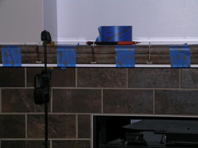

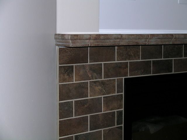

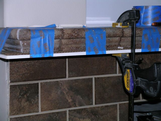

Wow, I didn't know about all these other responses. I didn't get an email notice of them. anyhow,after my last post I set my tile using loctite PL fast grap premium construction adhesive. I put a small board under the mantle and using clamps to hold it in place, then used 1/8" spacers I had and embedded them in four corners of each tile, then laid tile and supported it on the white wood and taped in place:
I let them dry 2 days and then removed everything and used grout caulk. here are some photos of finished product:
I think it looks real good and more importantly so does wife! Thanks for all the help. Wayne, I like your style. I don't always believe manufacturer either. sometimes they do things just to cover their own A**. I think they are just tryin to keep people from laying over hardwood floor as you suggested. In my setup with the bottom board layed flat on 2x6 and then screwed horizontally through the "ears" into wall and two boards attached to each other by screw about every 8" apart, I doubt any significant movement and the mastic likely would have been fine. But I had already tested and bought the construction adhesive and went that route. Everyone, thanks all for the help.
