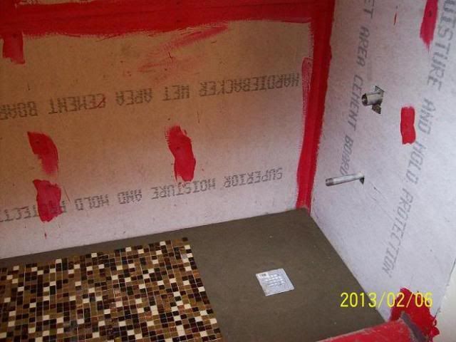

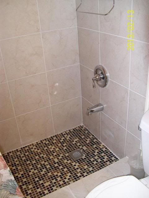

After showering, we keep finding a small amount of water seeping from under the adjacent closet wall. As you can see in included pictures, I have a inner liner/ mortar pan. I have a feeling, that the pvc liner, either has a hole in it or there is a leak around the drain. I have lost all confidence in this type pan & am going to replace it with a solid one piece pan. Am I wrong in this conclusion ? The walls are constructed with Hardibacker board, thinset & then the tile.

Do you have pics of the steps before this one? If you used the traditional method, it works 100% of the time, but only when done right. I prefer a Kerdi shower, but that's besides the issue. I can't tell what was done wrong from just that pic.
Have you tried capping the outlets and turning the water on?
Yes you are, I think. You'd be going from a high end look to a cheap plastic that will probably look bad in 5 years. Don't blame the method, nothing wrong with the method. Post pics of the process if you have em.

Have you tried unscrewing and resetting the tub spout. It looks like a screw in vs a soldered drop elbow in the wall for the rough in. I would use both teflon tape and teflon paste and make sure it is seated well. Do you have access to the area behind the faucet? You can also reset the shower arm using the double paste/tape method. Two known areas where leaks can occur.
On a slab, the area around the drain is usually a bit of a void where water can seep into the earth, seepage outside the drain area may come from other sources.

You need more than just the bottom row. You're likely to break or at least chip some of the other tiles too. Don't try to remove the backer board even with that grout joint. All joints need to be taped and mudded as before.
...can this joint be made leak proof ?
I've got news for you. That joint is not leak proof now and neither is Hardie. Concrete backer is not what makes a tile installation waterproof. The reason for the mesh tape is to stiffen the sheets by making a solid piece on board. Did you install a vapor barrier behind the backer or use any kind of waterproofing at all?
Did you have to slice the membrane to fit around the curb/doorway? Did you apply the Redgard all over especially the curb? That's why I asked for pics cuz I have a strong feeling someone forget a step or two.
Since you have no more pics, take the time to describe every step of installation method in detail or go ahead and rip what you want and we'll try to help.
Oh....one more thought. Do they make the proposed pan in the right size and how about drain location. (Pisst) You will have a devil of a time going your route and making it work.
