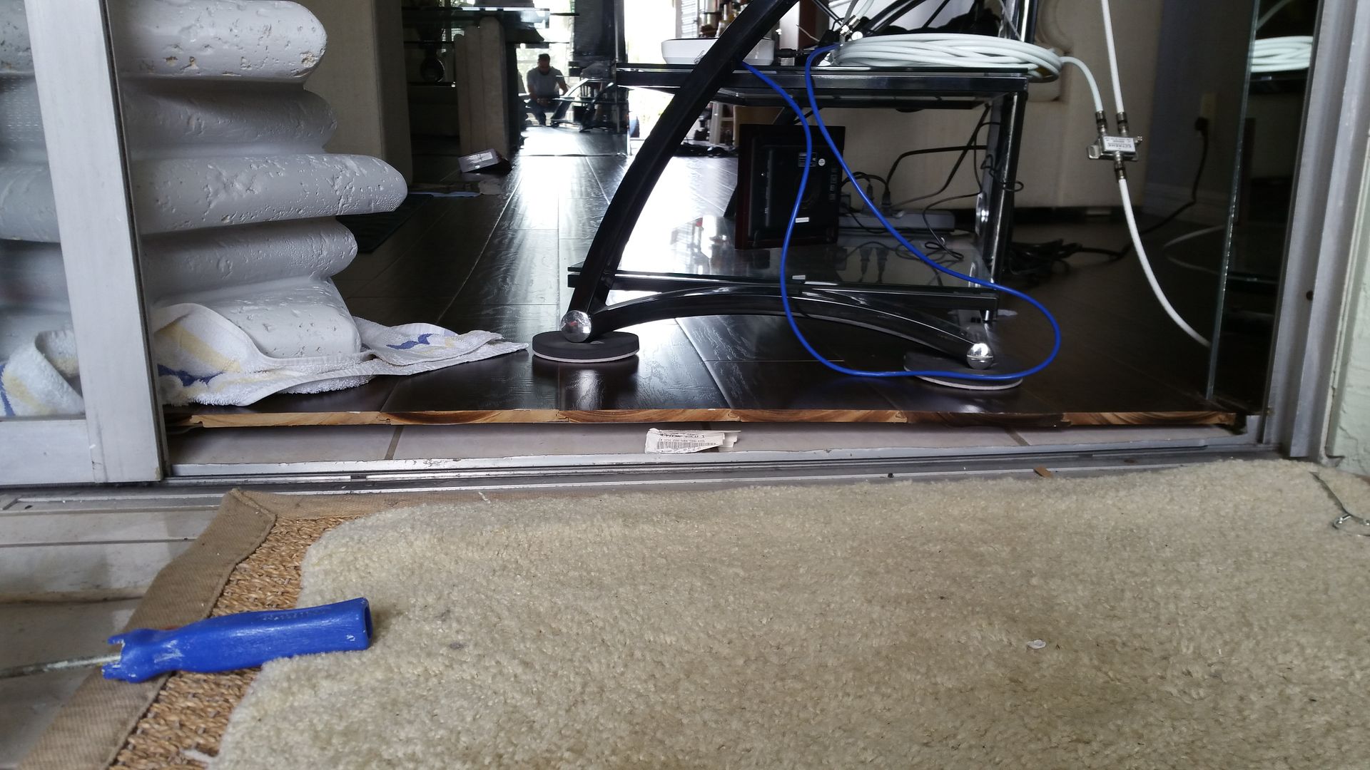

Hello everyone. New to this forum and this is a "I just need to know kinda thing". My name is shiraz and I live in S florida. I recently installed about 350sqf of interlocking laminate on top of a existing ceramic tile floor. It looked great for about two weeks. Now my existing ceramic tile is buckling underneath the wood, literally two weeks after the install! Throughout the install I did a sound check for hollowed out tiles. I found a few but here and there around the perimeter, nothing to worry about. The ceramic tile is original construction, maybe 20+ yrs old. I've seen wood buckle, I've seen tile buckle, but why two weeks after the laminate instal? Why god? Why me? Sorry guys..... I have 15+ yrs experience with all types of flooring...bla bla bla. Why did this happen? Anyone? Anyone?

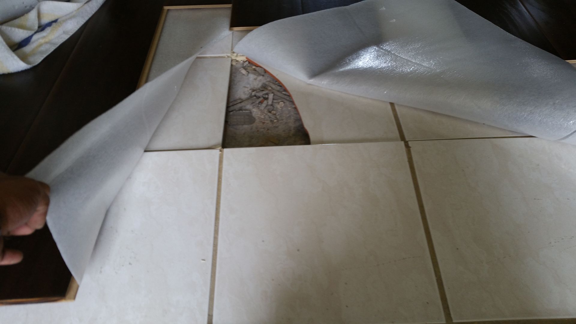

I taught the floor buckled. then I saw this.

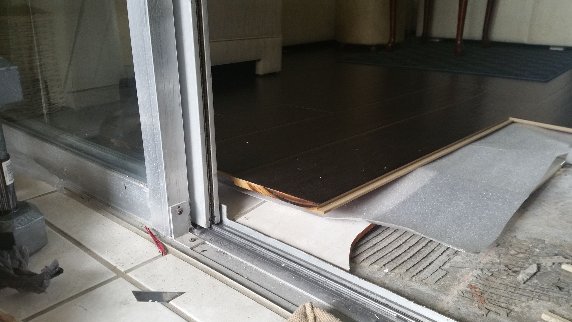

I have already ripped up the floor. this was taken a few days ago. im chipping up the remaining tile mortar.

the subfloor is in mint condition. I did a smoke test and found a draft under the sliding door frame. its been sealed. reinstalling the wood tomorrow night.

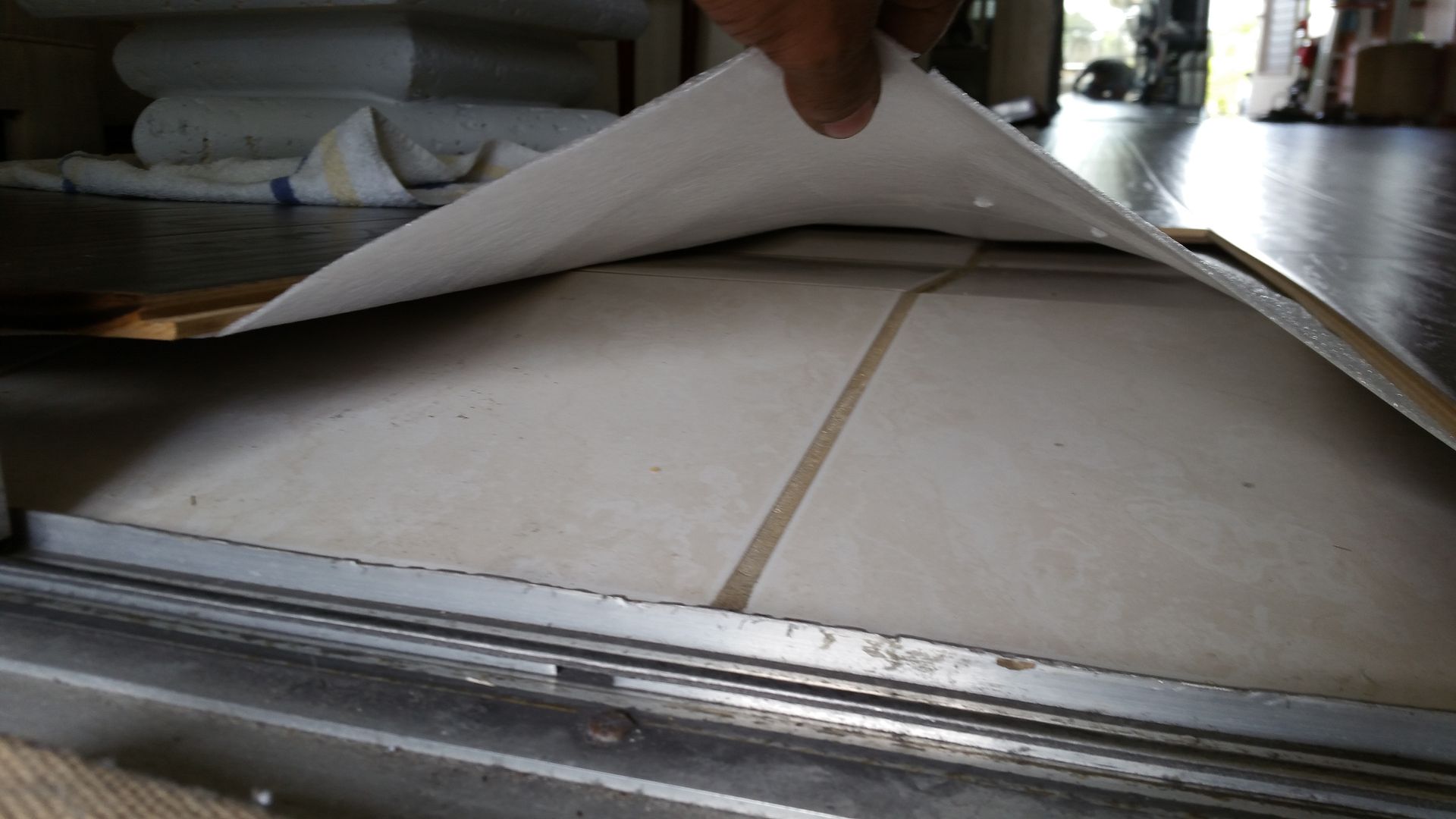

I started to chip the tile up. Remember now this tile was secure to the ground weeks before. As im hammering the floor starts to buckle and im blown away. watch the video.

Everything expands and contracts with temperature and moisture and it looks like that plastic underlayment held in enough moisture in to cause that tile to expand. Never seen that.
But, there is still a strong concern for reinstalling the laminate. Obviously the soil below is drying to the inside.

Well, you are going to have to perform a moisture test on the slab. Sounds like it is still moving and releasing moisture into the house. Are you finding lots of cracks in the slab?
