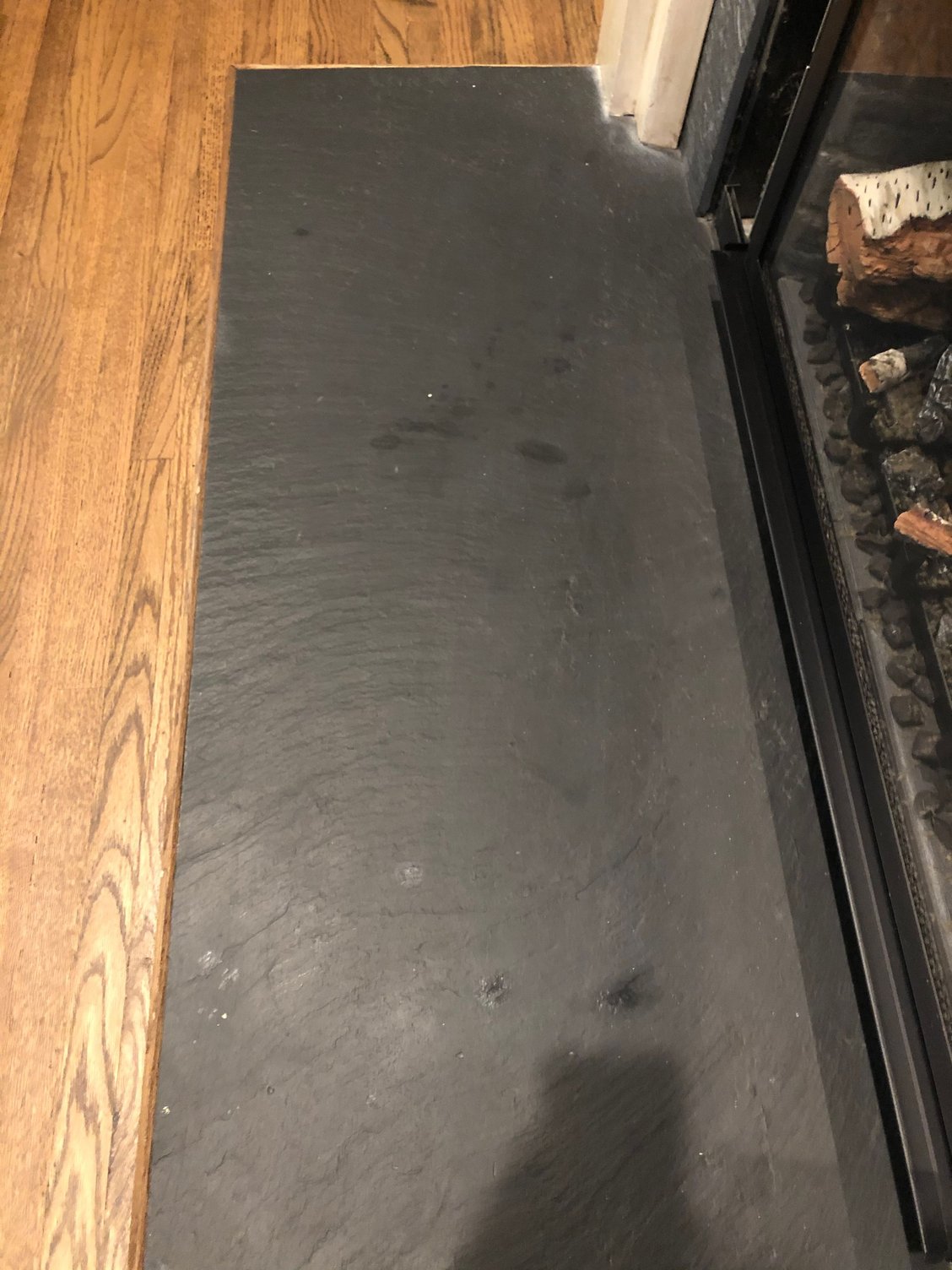

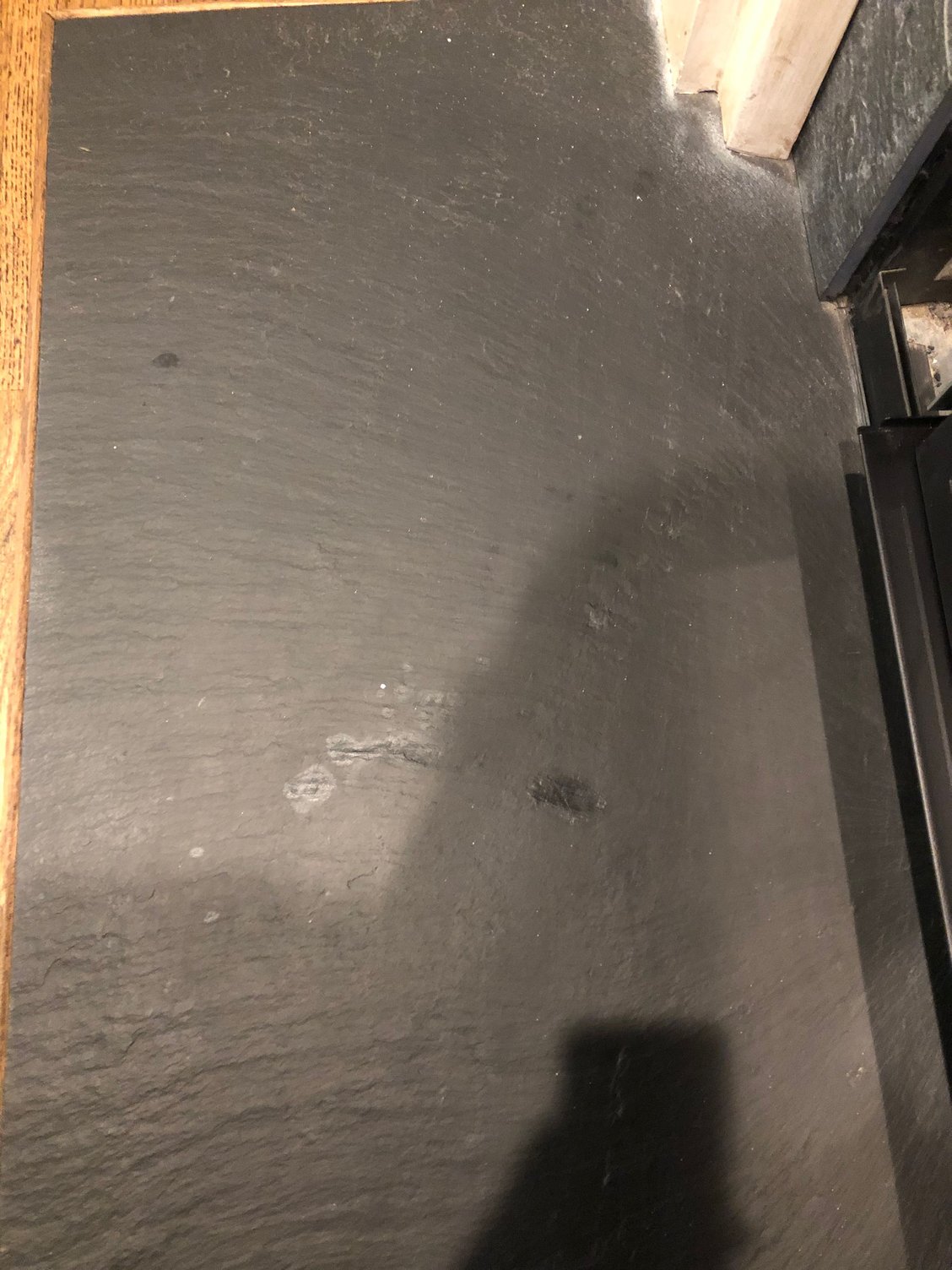

Remove grease stains from slate hearth
Old 11-04-20, 06:37 PM
S
Join Date: Jan 2013
Posts: 425
I have multiple stains that I believe to be grease based from my slate heart. I tried a wet cloth with some dishwasher soap but it didn’t make any difference. I’m afraid to try anything stronger. I’ve read a mix of hydrogen peroxide and banking soda paste but don’t have the stones to try. Any idea ?

You would need to use stronger solvents. Goof off, acetone, something like that.

It is grease/oil not a boo boo so hydrogen peroxide won't help. Think of things that work with grease except I would bypass soaps and cleaners and go right for solvents like XSleeper mentioned. Test a small, not visible spot on you stone to see if the solvent will leave any marks. Some stones are oiled or sealed which will will affect how you proceed.
The oil has probably soaked into the pores of the stone so it's not a matter of cleaning the surface. You need a solvent that can soak into the stone and dissolve the oil so you can blot it off with a rag. You'll have to repeat many times and hopefully each cleaning cycle will remove a tiny bit more of the oil.
If your stone is sealed or the solvent is leaving a mark I'd consider a different tack. Consider oiling the entire hearth to match the stained spots. The oil will further protect the stone for stains in the future.

I actually found an easier method. I turned the fireplace on high and the surface got so hot that the substance lifted to the top and I was able to use a dry cloth to remove nearly all of it. I think a few more times and it will be unnoticeable.
