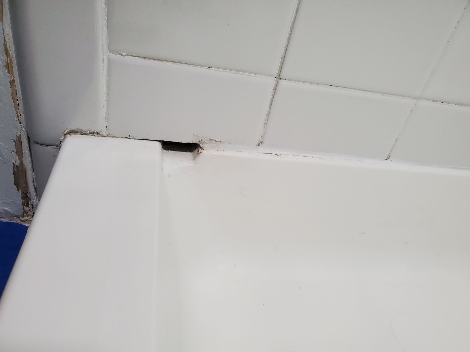

I would fill the hole with some white caulk. My guess is that the shower pan was part of a kit with side walls and the notch was there to help the side piece lock in place.
