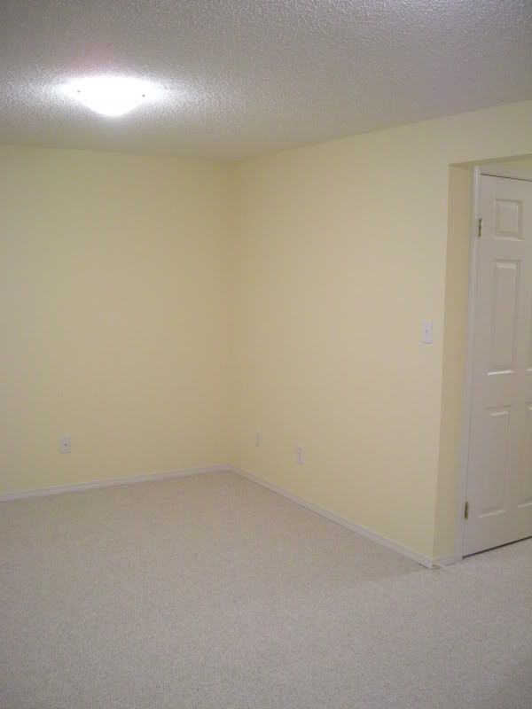

What I'm saying is that even if you nit pick it, over time they're gonna shift anyways. As for the exact number of what variance you can have, I don't think its written in stone anywhere. The last wood studded wall I framed had an 1/8" of gap in certain spots and once it was drywalled you cannot tell.
I did a wall recently where a stair case resides. I could not adjust the studs very much where there were some 1/2" variances and you could definitely see some slight waves when staring at it on an angle if you focused hard enough. But ultimately when its all said and done, can you tell? As for houses being thrown up so fast, they could care less of a slight variance. As
dhamblet mentioned, throw the junky ones away and carry on. If if you feel the need, shim and plane where required.
