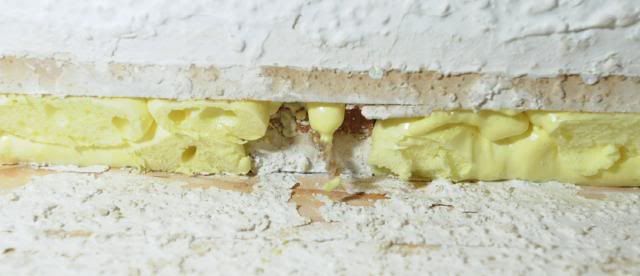

Hello,
Our house was built mid-1960's.
I'm replacing paneling with sheetrock. Of course, nothing is right in this house! The first piece of top of the wall trim I remove I find weird things. I see bits of the blown in insulation fall.
At the start of the trim the gap between the ceiling sheetrock and the wall paneling is not quite 1/4 inch. Fifteen feet further down it's just over 3/4 inch wide! Yes, I see into the attic, to the underside of the insulation.
I don't know how much wider this gap is going to become. How wide can I go with just mud and tape? When do I need to stick some little strip of sheetrock to fill the gap?

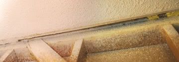

UPDATE
As I removed trim it went up to about a full inch before the ceiling sheetrock finally came in, almost to where it should be.
I'm 3/4 around with removing ceiling trim. Early on I thought I saw the ceiling move as I was removing the trim but kept going. I'm in a corner and the ceiling moves easily with finger pressure. There's not enough gap to tell where any rafters are. Anything I should do there?

Well, I tried to stay "safe" anyway!
The gap?
Filled with foam -
Then just mudded over. Tape to wide to be covered with molding. At that time didn't want to loose ceiling texture.
